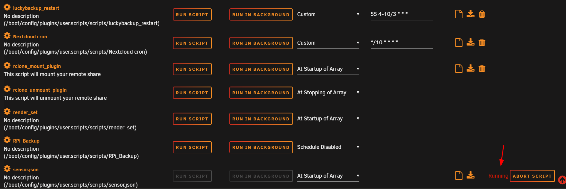

make sure your script runs and doesnt exit, sample in a while loop ...
here a sample how it looks while a script runs perm while others are just running on schedule, if thats the question.
