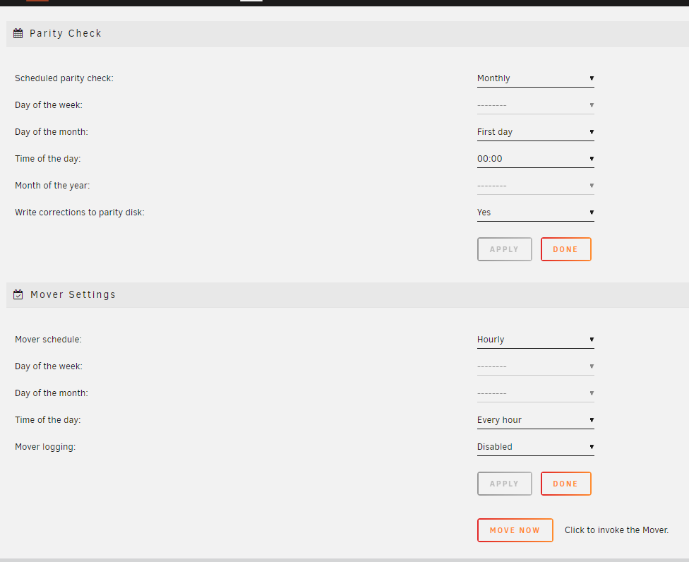

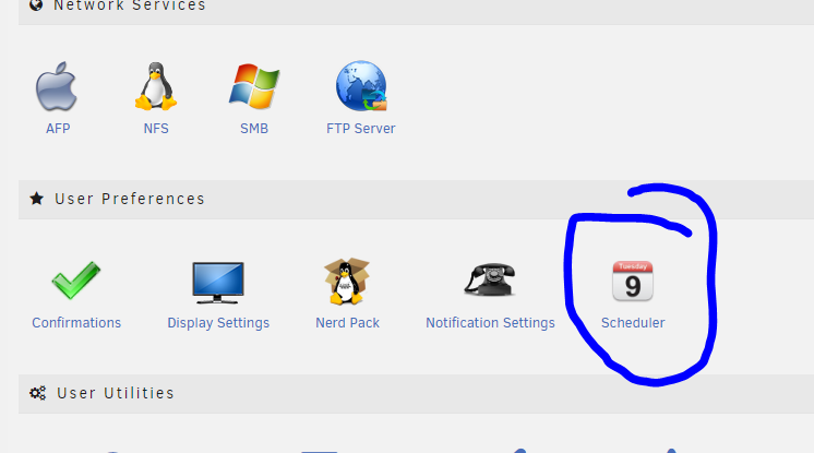

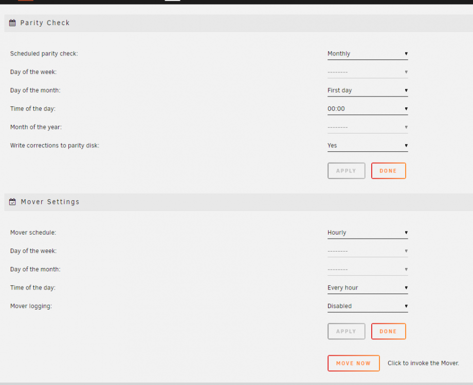

If i choose for it to run daily. What time does it run?
The built-in schedules can be seen and adjusted at Settings - Scheduler - Fixed Schedules
Right here trurl?
11 minutes ago, scubieman said:
Right here trurl?
Try it and see😉
2 minutes ago, trurl said:
Try it and see😉
I dont see it thats why I ask :P
