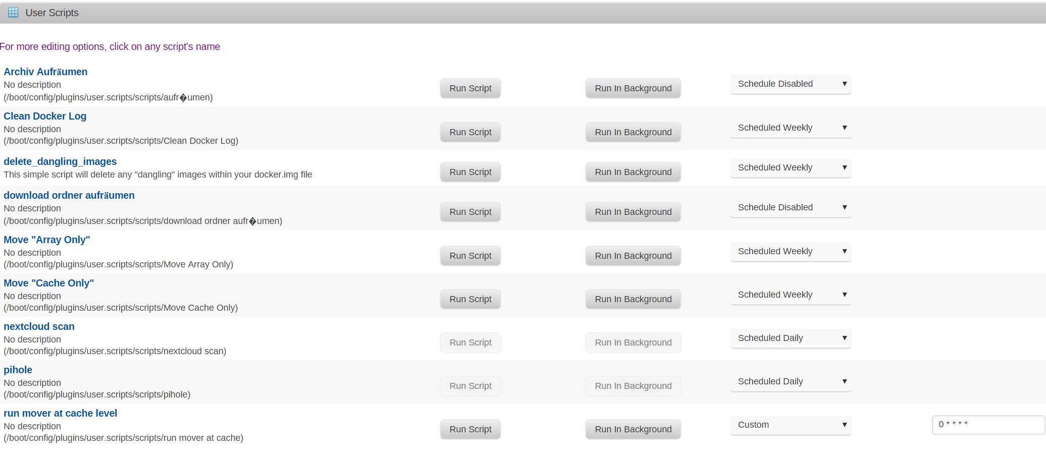

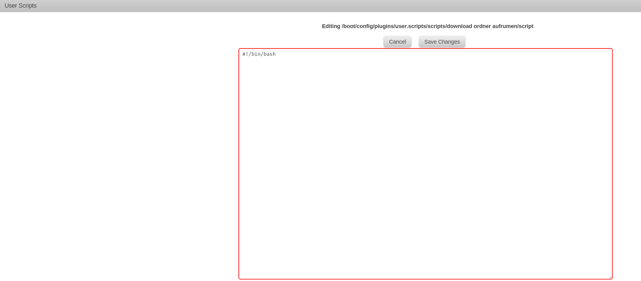

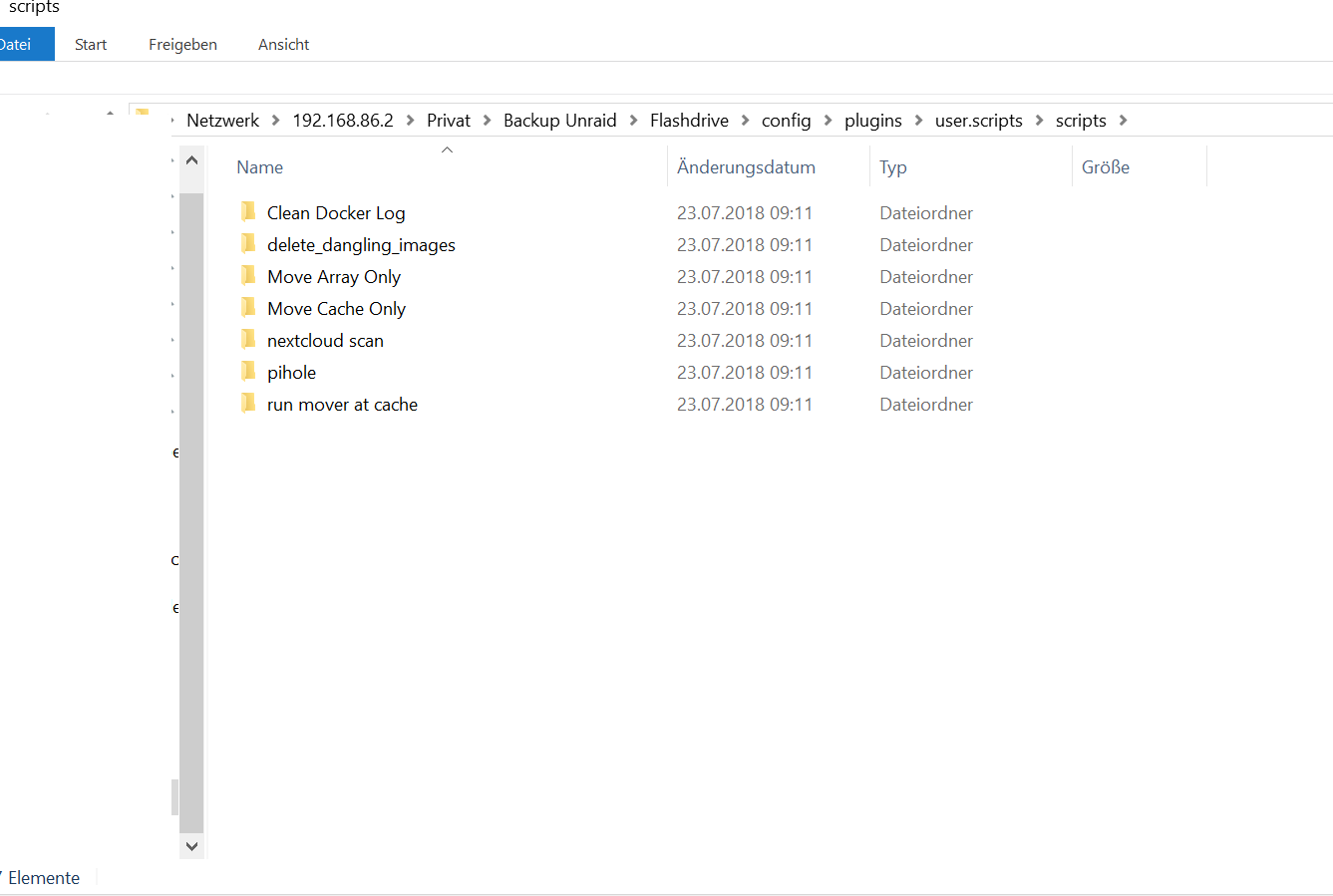

i did some screenshots,so you see what i mean...

ö ä ü ß ?
I would think that rsync used for usb backup should be able to handle any valid linux filename, but to be honest, I've never checked with non-English filenames.
I guess could be only reason? I mean, plugin still shows the names of the scripts, but theres nothing in it. They were running for months without problems... tehy just were never backed up... :(
Edited by nuhll
Yea, it seems to be a problem with ö ä ß and so on, i cant even delete the scripts from the interface.
How can i get rid of the undeltable wrong scripts? i would just readd them with other names.
Edited by nuhll
You should be able to go to the command line and delete them using wildcards. Or move all the others to another folder then delete the folder.
