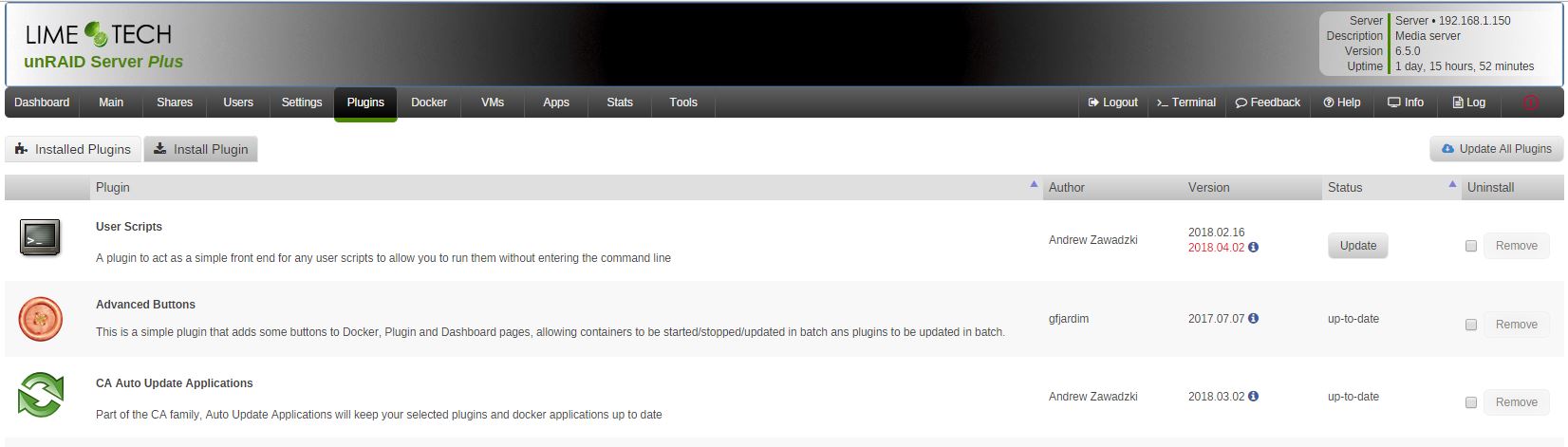

My system is not updating the User Scripts plugin. I also tried to remove it in order to install it again without any success. It comes back to the same status.
The same was also happening with the CA Plugin but I managed to update it directly in the Apps tab.
Can the User Scripts plugin be manually updated or removed via command line?
You uninstall the advanced buttons plugin. It's incompatible
45 minutes ago, Squid said:
Thanks. Guess what? I can't remove Advanced Buttons too!
Go to config/plugins folder on your flash drive and delete the .plg for Advanced Buttons then reboot.
But even before doing that, read the update notes for updating to 6.5. You may have other things that need to be changed for the new version.
See here:
 https://lime-technology.com/forums/topic/66327-unraid-os-version-650-stable-release-update-notes/
