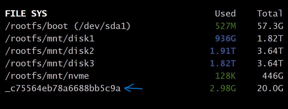

Hello,
Does anyone have an idea how to find this mout point?
I want to remove him from Glances.
Thanks

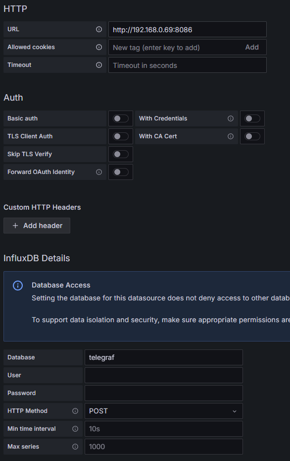

I am quite confused, been trying to setup Telegraf, InfluxDB, and Grafana for quite awhile now. But I keep getting no data when I setup the data source in grafana. Any help is appreciated. Telegraf also does this thing where it stops after even just touching grafana or influx.
Here are my setups:
Telegraf is 1.20.2
Influx is 1.8.4 ( I don't get any WebUI)
telegraf Post Arguments:
/bin/sh -c 'apt update && apt install -y smartmontools && apt install -y lm-sensors && apt install -y nvme-cli && apt install -y ipmitool && telegraf' -u 0
telegraf config
my data source looks like this
Just not really sure where to go from here. I have tried so many things to see if it will work. Googled this so much, but can't seem to find a guide that solves the problem.
Thanks for any help
