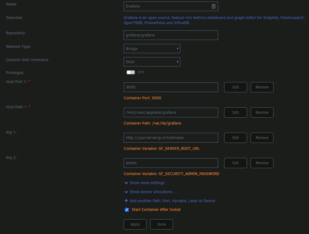

On 3/15/2022 at 11:34 PM, VelcroBP said:
I'm not able to start Grafana container on Unraid 6.9.2 after install. It immediately fails with an "Execution Error: Server Error" and doesn't generate any logs. I'm using the below defaults, but swapping in my server IP after the "http://" in the Key 1 field. I do not have any other containers using port 3000.
I'm still unable to start Grafana with the same error. I tried switching to HOST and it actually starts, but stops shortly after with the following error:
logger=server t=2022-04-16T22:41:00.79-0400 lvl=eror msg="Server shutdown" error="*api.HTTPServer run error: failed to open listener on address 0.0.0.0:3000: listen tcp 0.0.0.0:3000: bind: address already in use"
On 4/15/2022 at 8:33 PM, Optimus1008 said:
cd /mnt/user/appdata
chmod a+rwX grafana
That seems to have fixed it for me also! Thanks!

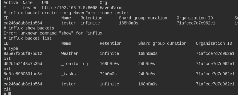

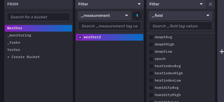

I may be wrong but I think you need to use commands to create a bucket. From what I understand you have an organization and then within the org you create buckets to where you store your data. Also from what I can see on their documentation, all commands need to start with influx,
For instance on mine I have a org called HavenFarm to which I created a bucket called weather. I then am using telegraf to dump my data into the bucket called weather. I think first you will have to set up authorization first
https://docs.influxdata.com/influxdb/v2.2/reference/cli/influx/#provide-required-authentication-credentials
I just tried the command line fine
I am using the gui rather then command for it is easier to set up buckets and such.

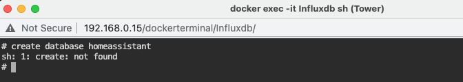

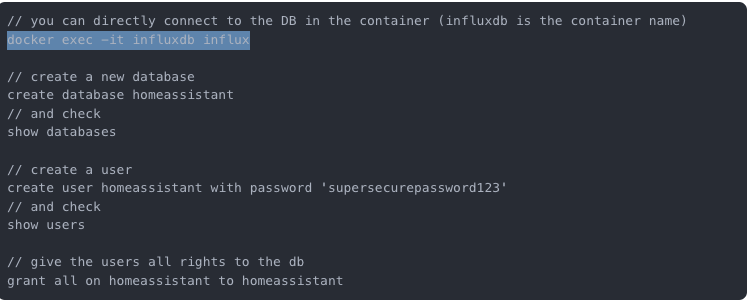

Hi Guys,
can you help me, iam a little bit confused.
I got a running setup of influxDB / Grafana on a RaspberryPi with custom sensors and code. I wanted to migrate that stuff to unraid and was glad there are some ready to go docker containers for influxdb and grafana.
Thats where the confusion starts. In the dockercontainer there is no influx shell like the influx on debian/ubuntu only the an influx command. I cannot find a way to create databases, I only find buckets? Googling the problem didn't help much. The docker container has a own WebUI of influxDb which my influxDB on raspy does not have. It feels like iam using two different programs that have the same Name.
Can you help me understand whats going on?
