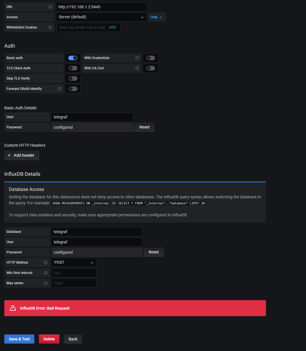

Hey all - I am having some issues setting up the initial Grafana data source.  I followed this guide How to setup Grafana, InfluxDB and Telegraf to monitor your unRAID system. | Technical Ramblings
With this post arguments in telegraf - (which is the one for telegraf:alpine repository)
/bin/sh -c 'apk update && apk add smartmontools && apk add lm-sensors lm-sensors-detect perl && apk add nvme-cli && apk add ipmitool && telegraf'
Everything went along fine until i got to he part where I was adding the data source in grafana.  All dockers are up and running, however, when I try to attach, I get the error below.  I think it's authentication related.  I used the password in the telegraf.conf file (metrics......).  I also tried it with the default info as well as the info in the guide (which I am aware is not complete).
Can anyone give me a little help?  The frustrating part is, I got this working last year and it was cool.  Now, I am looking to use it with my energy monitoring system and its not working : /
Thanks all

On 4/19/2021 at 3:35 PM, ledfortr said:
Everything went along fine until i got to he part where I was adding the data source in grafana.  ....
Influxdb 2.x doesn't work with these containers. The API or authentication system is significantly different than in 1.8. I haven't really looked into trying to fix it, because it was just easier to stick with 1.8. In the Influxdb docker container, change the repository to "influxdb:1.8.4" and things will work again.
