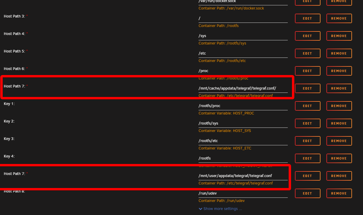

So I've had this issue for quite awhile and not sure why. It's just finally starting to drive me nuts lol
Every time there is an update for telegraf, I have 2 host path 7's. So the app updates, but don't start until I remove one of them.
Any ideas? Thanks

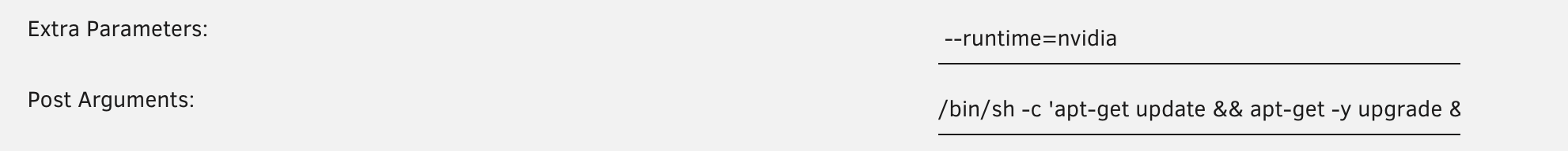

Try putting this into the post arguments. but first remove the reference /rootfs/usr/sbin/smartctl file in the docker container.
/bin/sh -c 'apt-get update && apt-get -y upgrade &&  apt-get -y install smartmontools && apt-get -y install lm-sensors && apt-get -y install nvme-cli && telegraf'
461828331_ScreenShot2021-01-12at2_25_54PM.thumb.png.d54c06b034d189a53835f514fb2dd458.png
