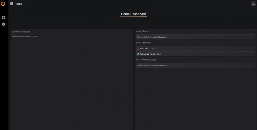

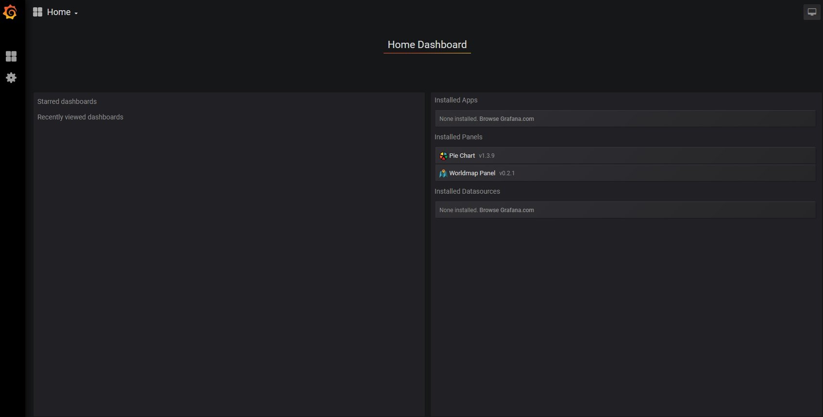

I'm trying to learn grafana, influxdb, varken, and telegraf. I think I have everything with a basic setup but when i go into Grafana, where do i start. I read over a few guides and they all mention adding a data source but I don't see it. Can someone point me in the right direction? Thanks in advance!
