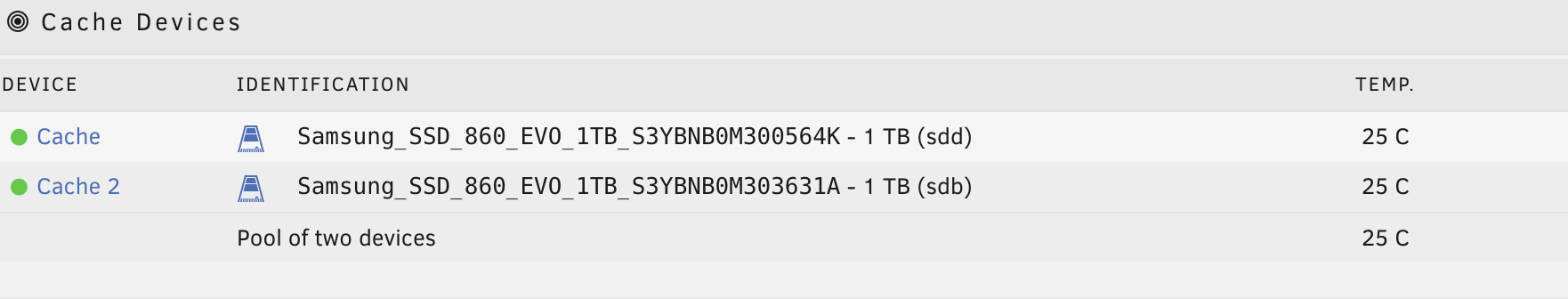

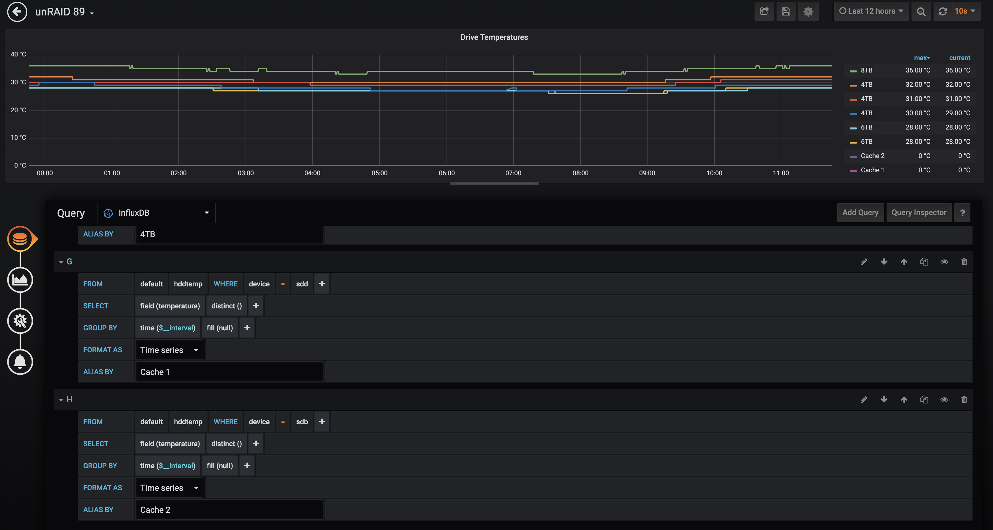

Hey guys have had this running for about a month now with zero issues and love it to bits.
Unfortunately I have run into an issue with my cache ssd's. I had a 1TB Samsung ssd which reported temp just fine but since I added a second ssd cache of the same drive all I get is zero reported from either drive. Any help on where to look would be most helpfull. I know its not a deal breaker but just helps my ocd lol.300720954_ScreenShot2020-01-19at11_35_33AM.thumb.png.af278fa7e8f75111f1c3c07e0ccccf84.png
937145083_ScreenShot2020-01-19at11_45_47AM.thumb.png.0f69096a3375762b44e7bda1b1178124.png
