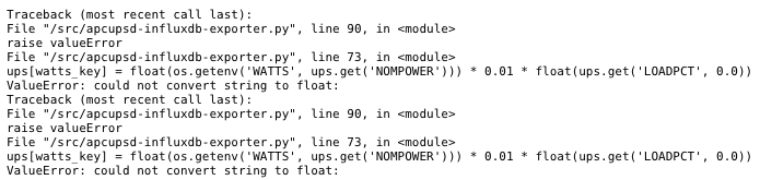

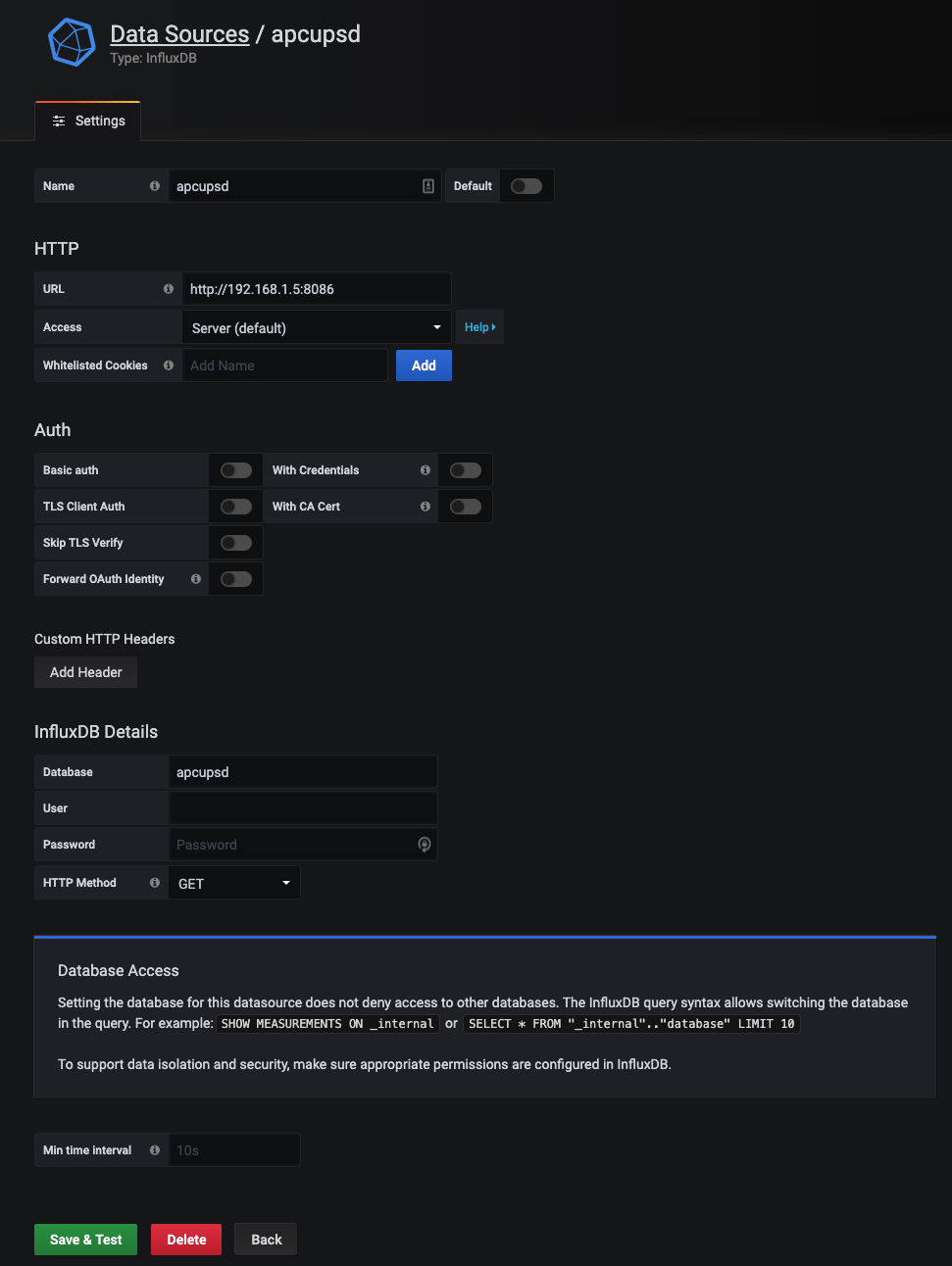

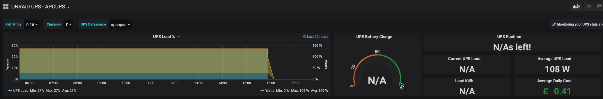

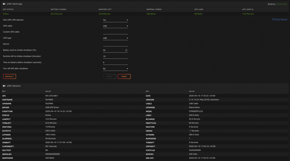

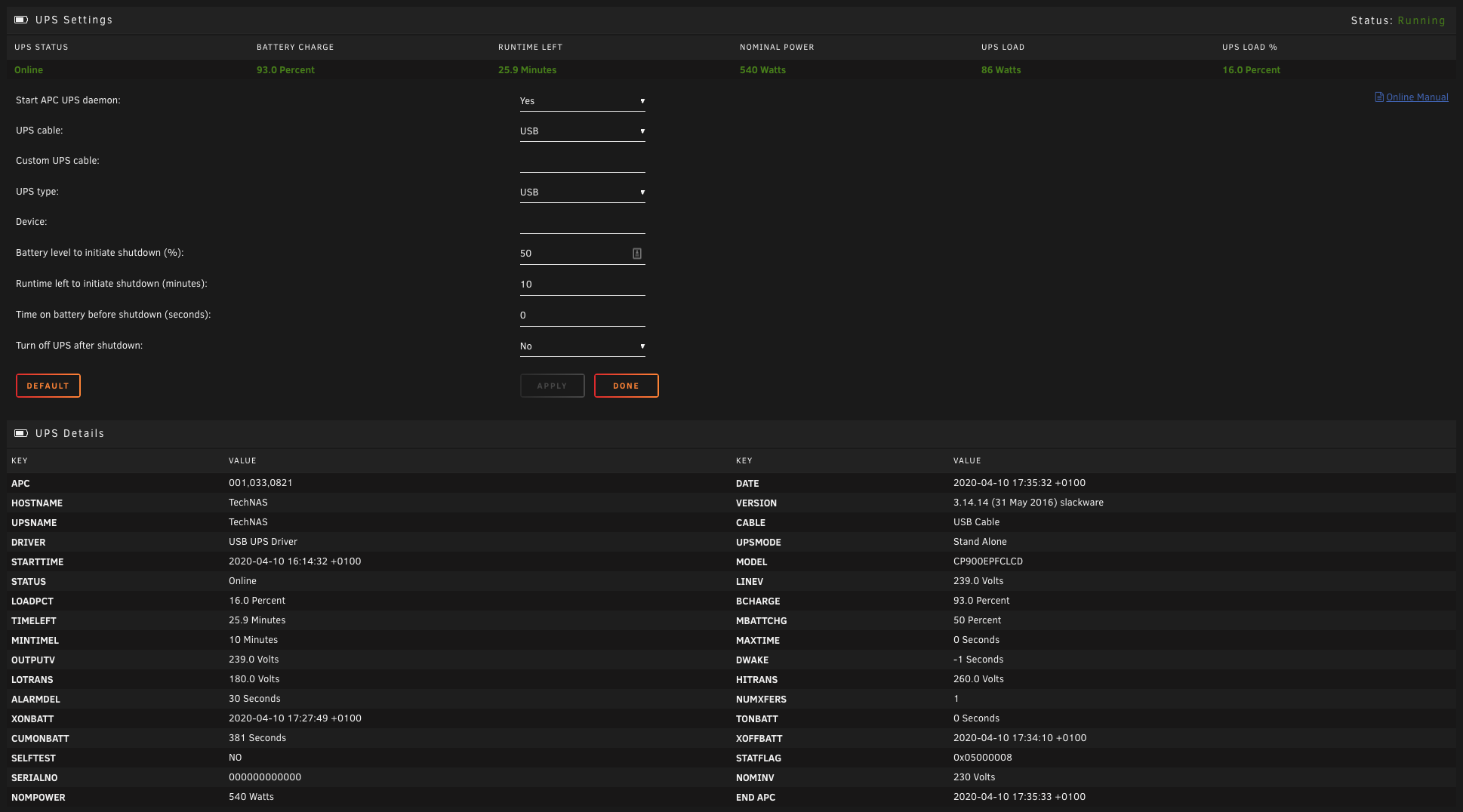

I've just replaced my UPS and the new UPS provides information that the old one didn't so Grafana should be more accurate. For example, nompower, loadpct, timeleft etc.
However, something isn't quite right, as Grafana is actually reporting less and I'm thinking it's something to do with apcupsd still reporting the old information from the old UPS and not updating Influx with the new information?
I've added a number of screenshots from what apcupsd shows, Grafana, Influx set up, Influx data sources and if I remove the nompower from the apcupsd-influx-exporter (this UPS reports nompower, the old on didn't), the log file.
Can anyone assist please?
Many thanks and stay safe!

I believe its because your new UPS is reporting LOADPCT as "16.0 percent" instead of just "16.0".
So your UPS is actually providing a String Value to the formula when it needs just an Integer or a Float number.  You might have to dig in the Grafana Dashboard code and help files to figure out how to strip that string value of the " percent" from the end of it in that formula.  Or maybe someone here can help with that.
I had to do a custom User Script using CA User Scripts Plugin and the NUT-Settings Plugin instead of the built-in UPS Settings for my Eaton Rack-mount UPS because it was not providing any of the normally named tags and I had to modify all the Grafana charts to look for the new variables, but I didn't have to do any string manipulation like your new UPS would require.
Hopefully I can at least point you in the right direction.

Do you have the WATTS variable set in the apcupsd-influxdb-exporter docker? image.thumb.png.5c1cd68243862520c7d9134c9caadf79.png
The old one I did, but this one I don't. If I add it, it now lets the docker start, but the charts don't update and I still see this in the logs;
1306283663_Screenshot2020-04-11at15_44_51.thumb.png.ab96977ae77a83ad014874c2fd9fc848.png
Ouch, that sounds complicated. I'm hoping there's a more 'straightforward' solution...
