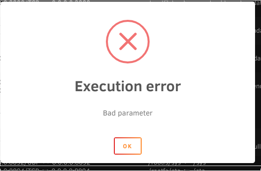

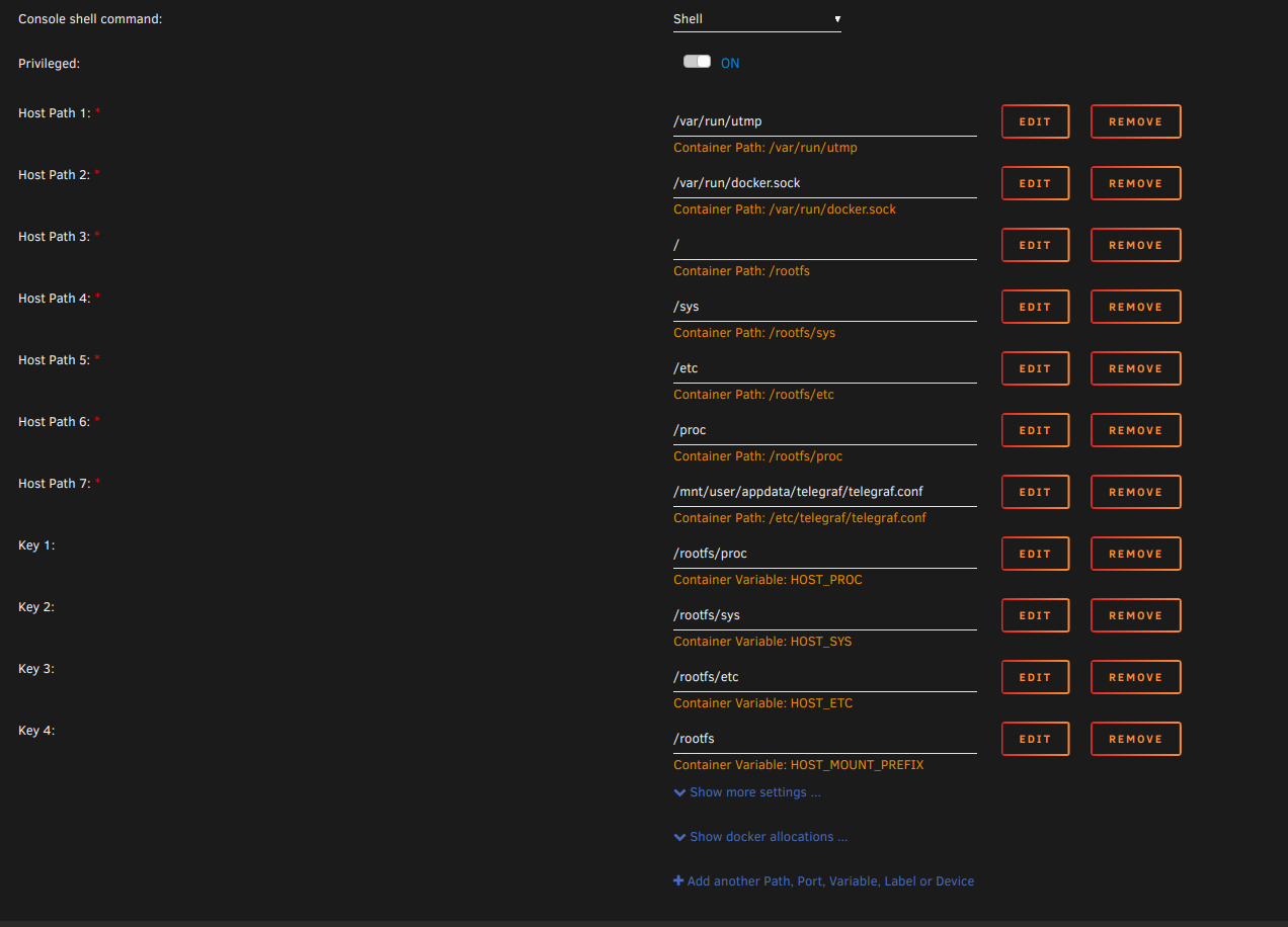

Im having issues getting telelgraf to start up, I attempted to start with the config file added and the settings changed needed for my server ip, but it says invalid parameter on start?
Where is the error displayed? Is it that the docker container can't start or that telegraf is reading the config file and something is wrong in there. My guess is you have a typo of some kind in your telegraf.conf.
You ever get this working? I am attempting a new install and get the same error message.
I was able to reproduce the error by not having the telegraf.conf file. If you don't have the file before you start it creates a folder named telegraf.conf. So you'll need to delete that folder and replace it with the file.
Heh, literally 30 seconds ago I figured that out. :D On to the next step!!! thanks!
