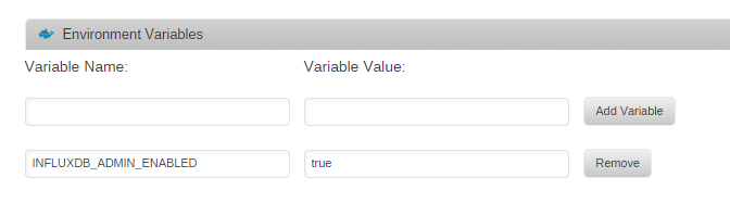

Ok I must be missing something that everyone else seems to know already.
I installed the Influx and Grafana dockers.  Grafana works like a charm.  Influx though I'm not sure if its up at all.
I tried enabling the web interface but I still get a 404
59dfe2585571a_2017-10-1215_44_26-Backup_UpdateContainer.png.adca4b0599f94d47ebe6f661e31d2a98.png
I honestly don't care if I have a web interface but I have no idea how I'm supposed to interact with the db as a docker on unraid in any other way.

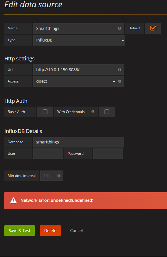

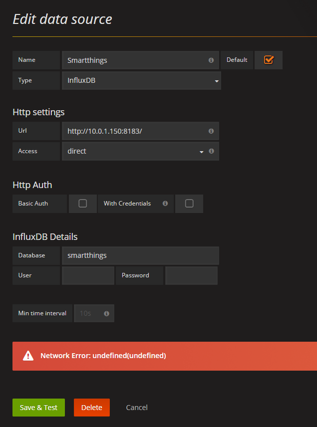

What I'm really going for here is this page to complete successfully:
59dfe2aba649c_2017-10-1215_45_54-Grafana-Home.thumb.png.8cb7a65a0f2e41681926f3bffb0bf0be.png
I literally don't know what to fill in the fields with b/c I wasn't able to define any of these settings somewhere.
I would really really appreciate any assistance as this is my first go at influx and grafana.  I swear I'm not stupid, but I encounter issues like this and I have my doubts...
Influxdb doesn't have an admin interface anymore. That being said, try port 8086 instead of port 8183.
Still no go, this was me troubleshooting earlier before I changed the ports back to stock, should've changed my screenshot.
I don't know what credentials to use, does it need any?  What about creating a database?  I haven't done that either.

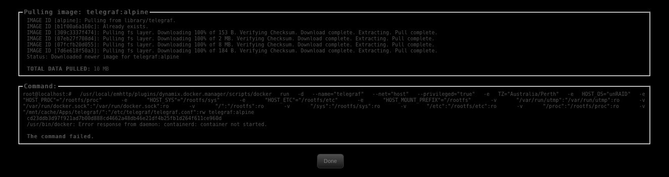

Anyone having issues installing Telegraf?
I get the following error with no template mods.
I am circling back around to using grafana/influxdb/telegraf but I can't seem to pull docker info. I am unsure what specific settings are required to do this as when I try to adjust the inputs.docker in the telegraf config it crashes from an endpoint issue.
Any help is appreciated!
Solution: Figured out I am an idiot and hadn't uncommented the actual input header to load the input into telegraf lol

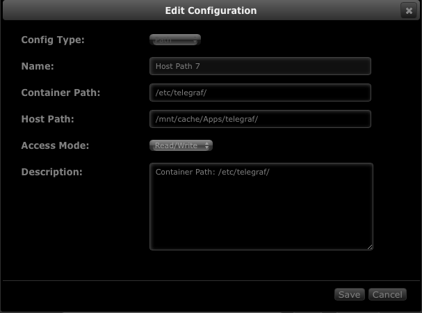

I was getting the same here. I'm on 6.3.5 if that helps. following the guide from @panzerschreck. See the first screenshot.
just changed the apps directory to suit my system. See Second Screenshot.
I got it fixed. See second screenshot.
Just download the telegraf.conf from the github and edit it. save it to the telegraf apps folder. (https://github.com/influxdata/telegraf/blob/master/etc/telegraf.conf)

Hey BillClinton,
glad it worked out! The telegraf.conf that is created in /.../appdata/ automatically is of an outdated version of Telegraf and replacing it with the new one is 100% needed. I've seen all kinds of errors from people not doing this.
If you've got any questions feel free to ask.
