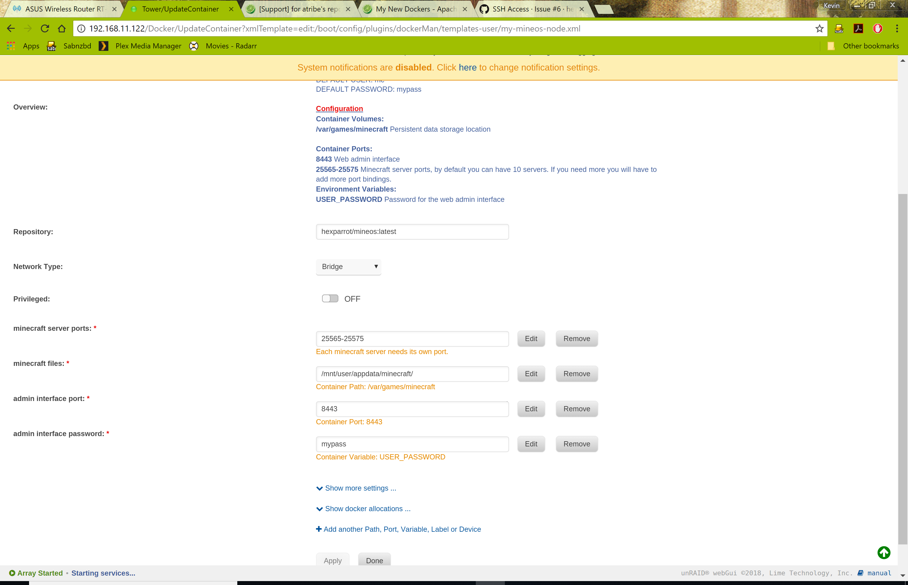

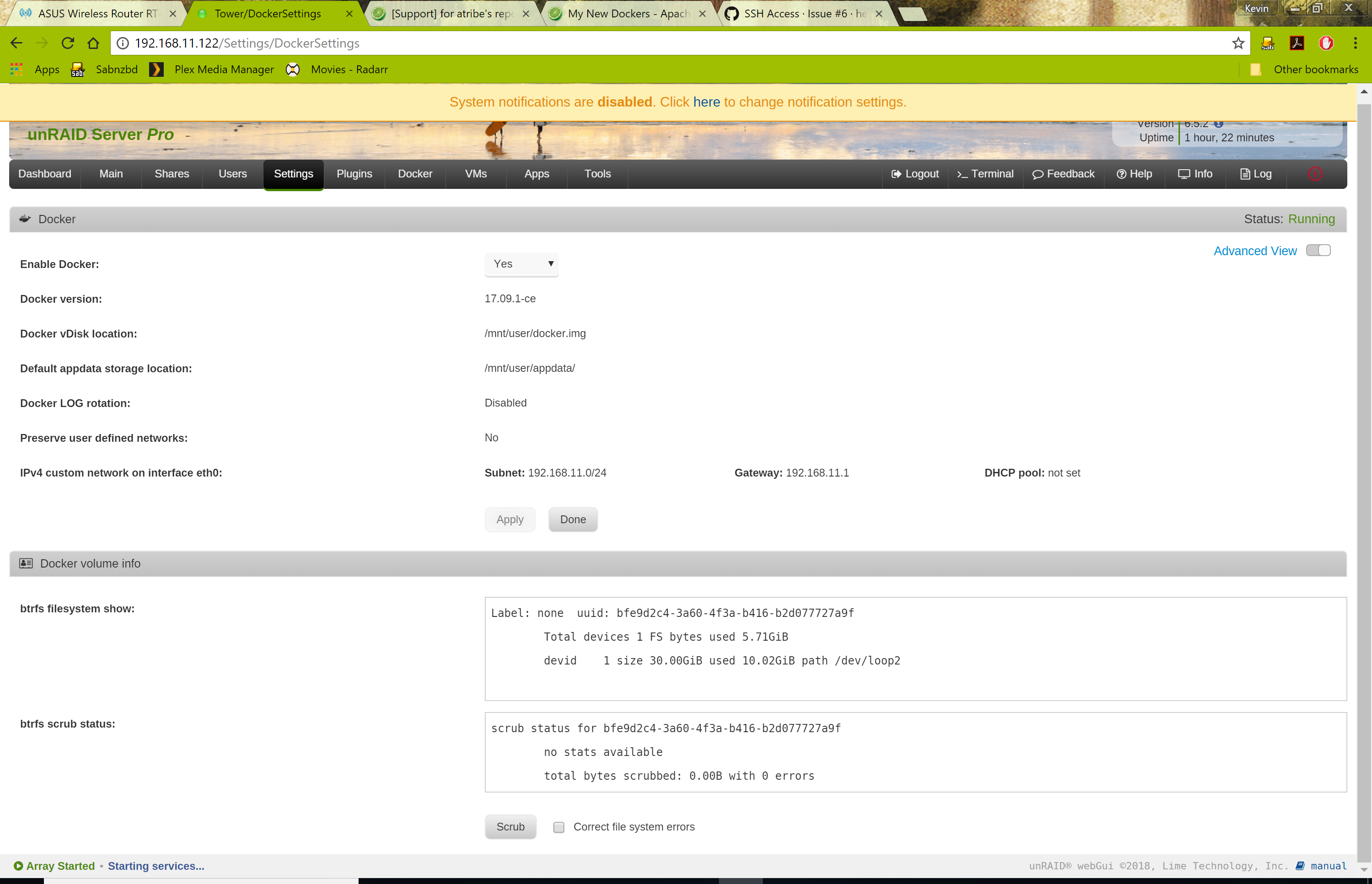

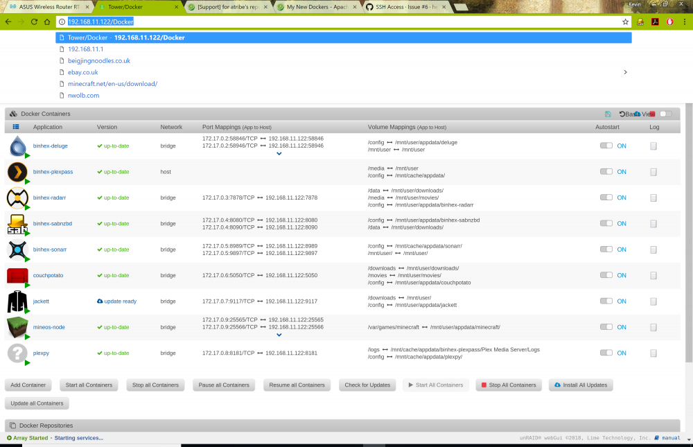

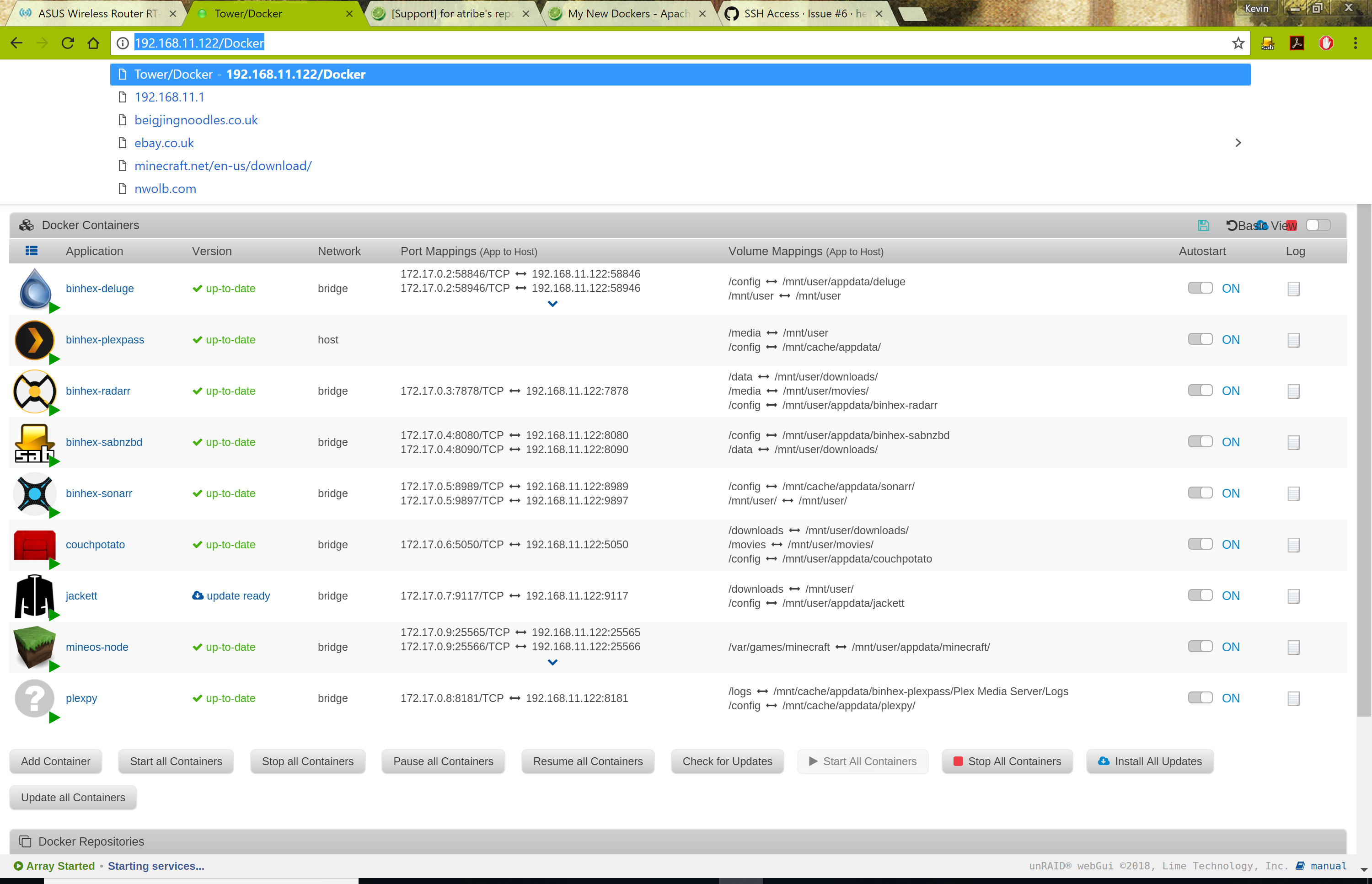

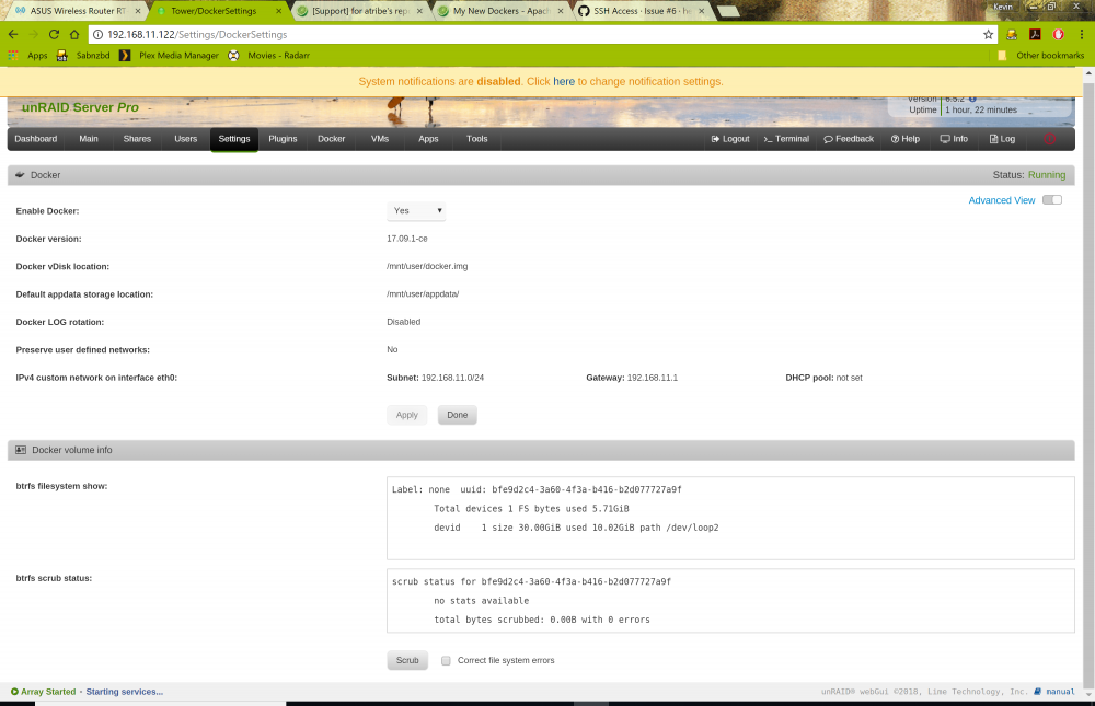

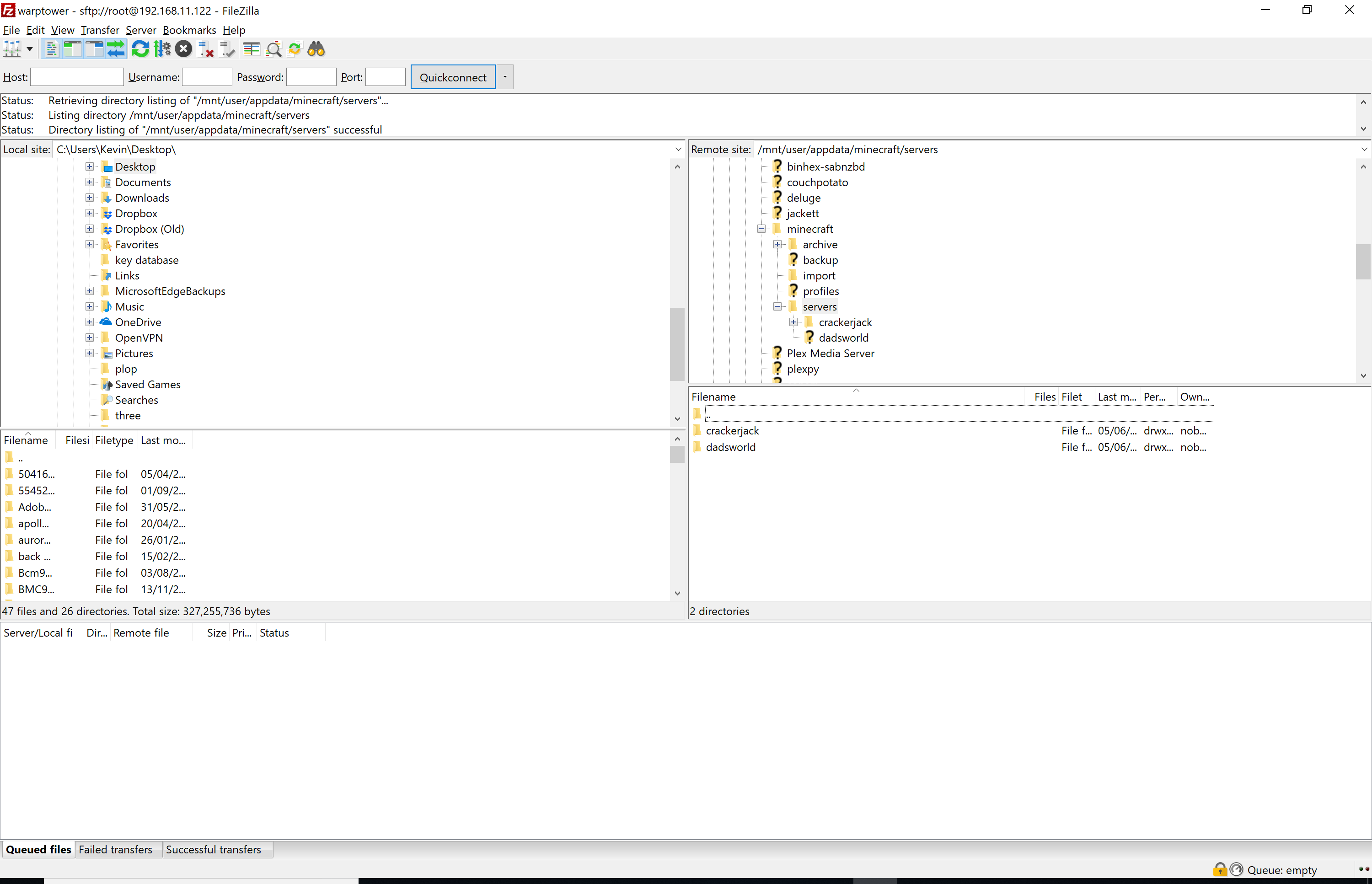

hi,
i have installed the minecraft docker, i noticed its very similar to another minecraft docker i tried, i am having the same issues as i had previously with other dockers, any minecraft servers i create and not surviving a reboot of unraid, i can see the servers if i FTP to server folders and they persist, just not in the GUI, its clearly something with my setup but i cant see it...
i have it set to /mnt/user/appdata/minecraft and my appdata folder is set to cache only
9 minutes ago, loady said:
hi,
Sounds like your docker is not setup correctly. Do any docker containers persist? If not I'd check your docker settings to make sure they are similar to what I have.
all my docker container persist (i believe) as i have no issues with any other dockers. You can see the servers i created in the servers folder, they just dissapear from the GUI
Edited by loady
added another shot
I have been playing about, i can get the servers to show up after a reboot now, but i have to change the group/user properties to 1000:1000, however, after a reboot they are going back to nobody:99 and group:users100
Can anyone help me with this, or point me to where i should be looking, i can only get servers to show after changing permissions but after reboot permissions are getting reset for the folder, i know its something with my unraid setup now
I've been running a MineOS-node server for a long time, however I just recently noticed that the Web UI isn't responding. I tried removing and re-installing the docker but it didn't have any effect.
The servers I had set to run at startup are still responding, I just have no way to manage them from the UI.
Am I alone in this issue? what can I check next?
