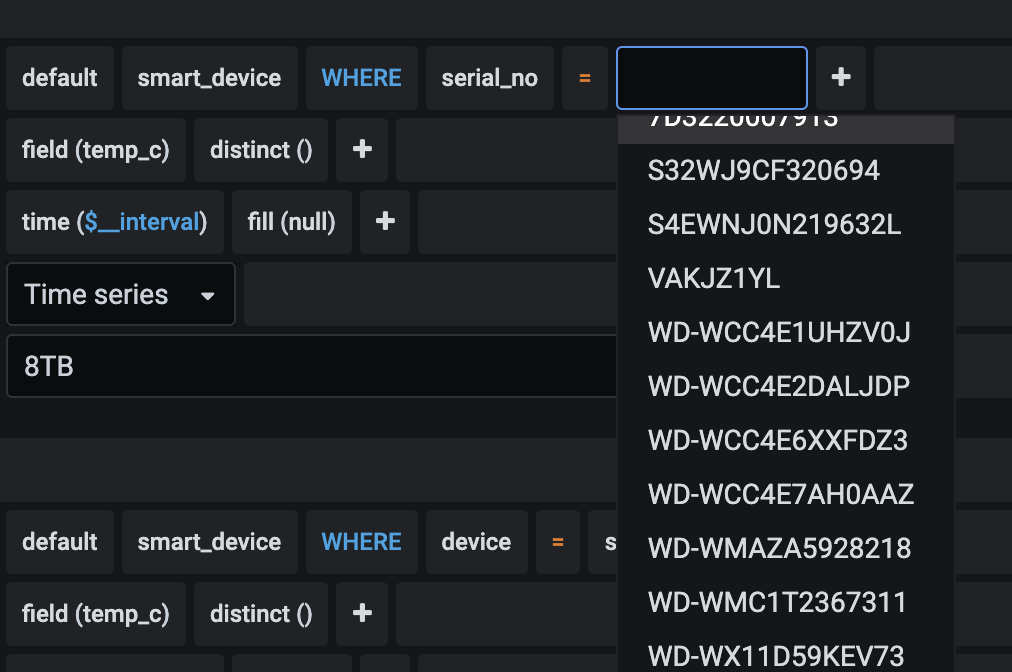

4 hours ago, Struck said:
Is it possible to have HDTEMP collect the serial number instead of the device id?
The device ids, are shuffled every time i have a hardware change, which annoys me a bit.
You can do it via serial number if you wanted to instead of device id.
Edited by JaseNZ
Added screen shot
I don't have the option for either smart_device nor serial_no, are you using HDDtemp for smart data ?
Sorry did not realise your were using hdd temp, I use smartctl you get a lot more info.
These are my two lines in the telegraf.conf file.
[[inputs.smart]]
 attributes = true

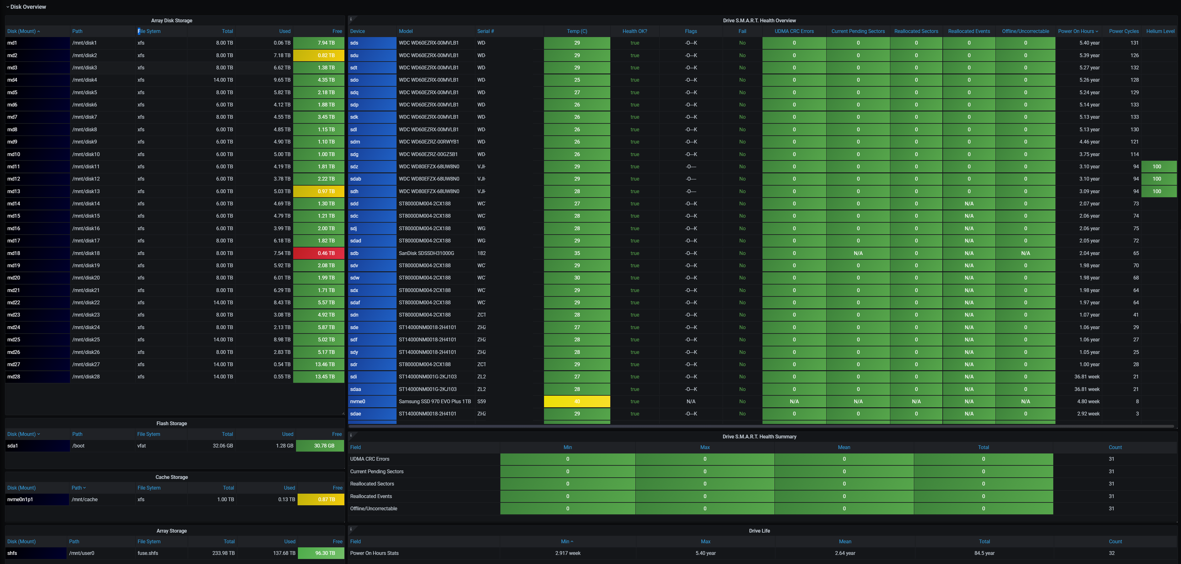

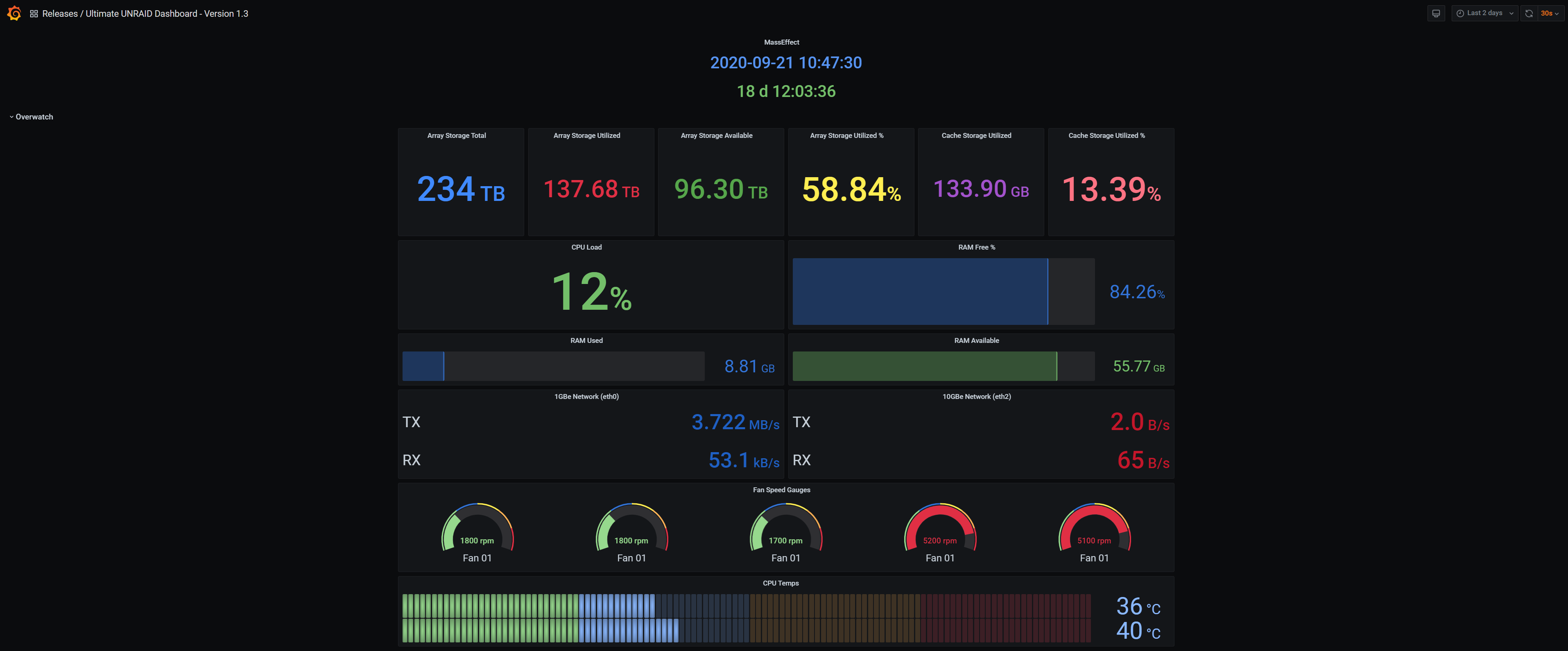

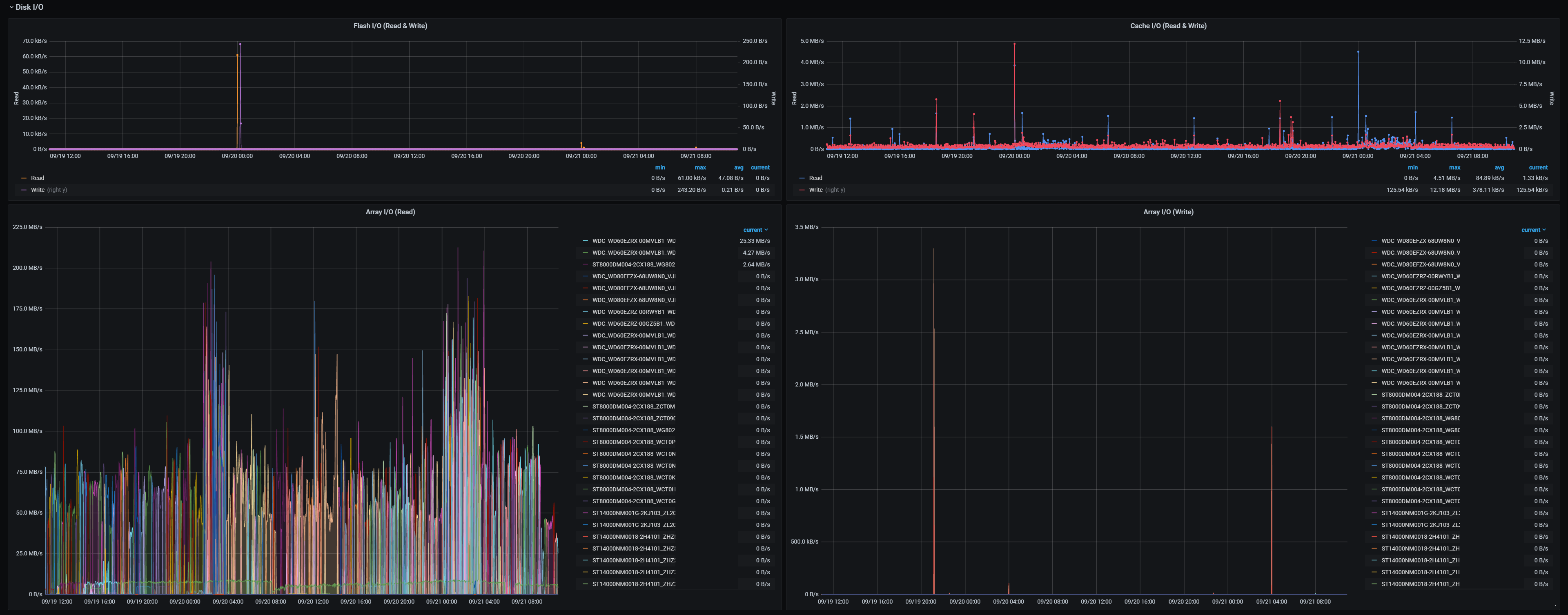

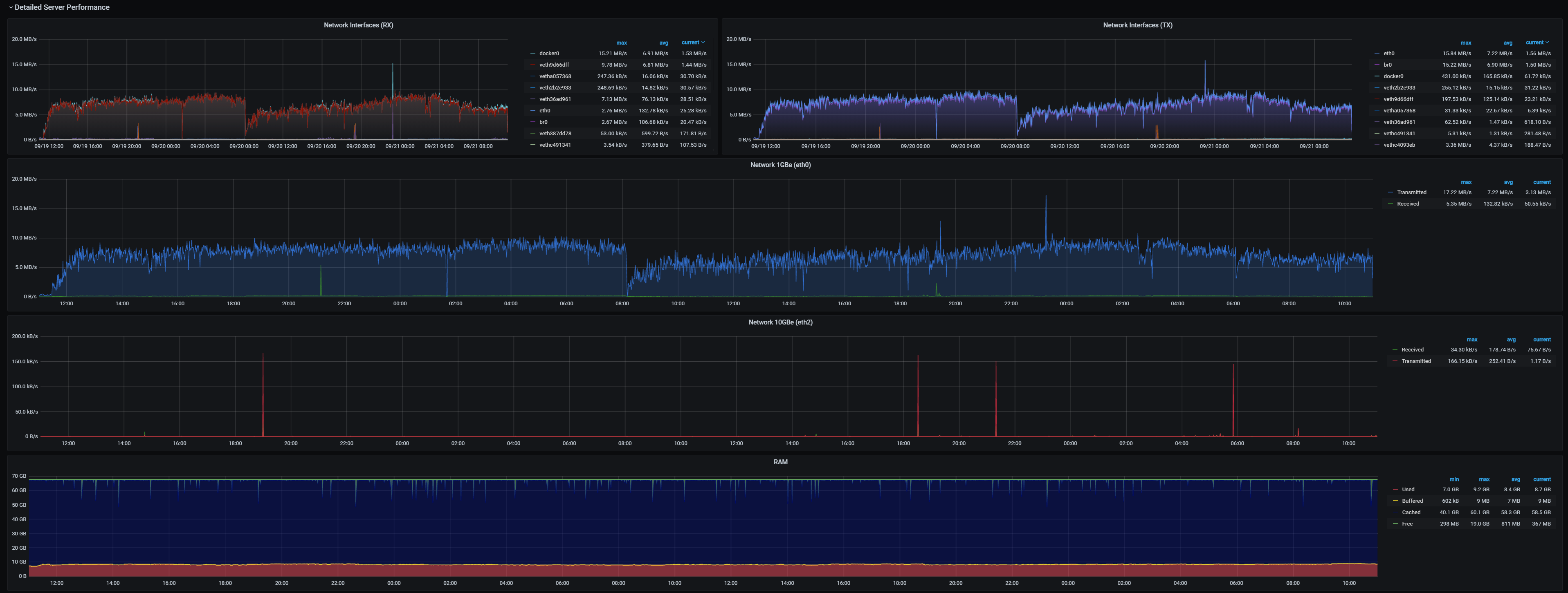

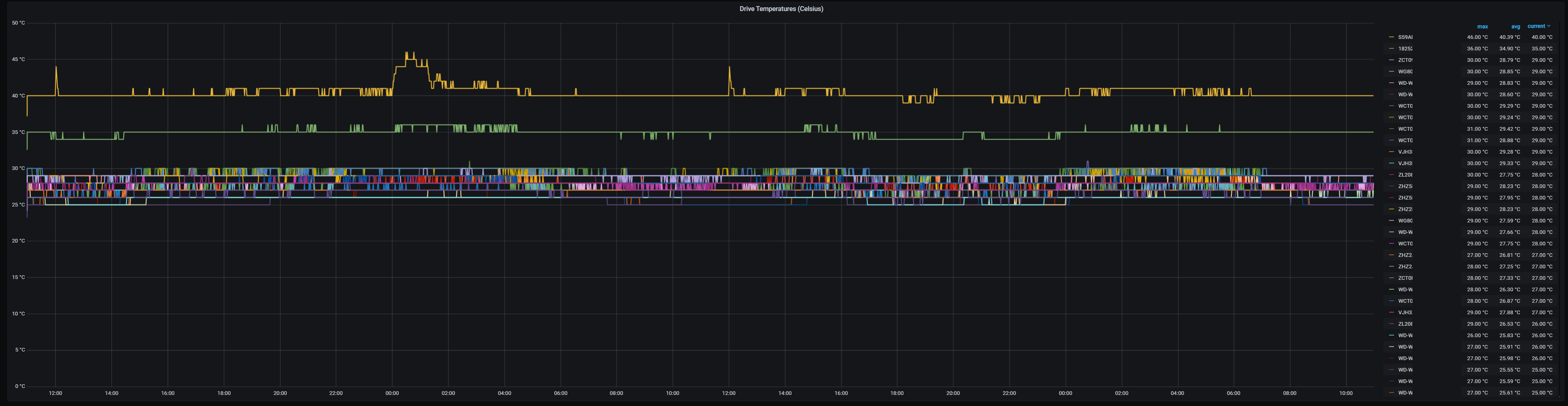

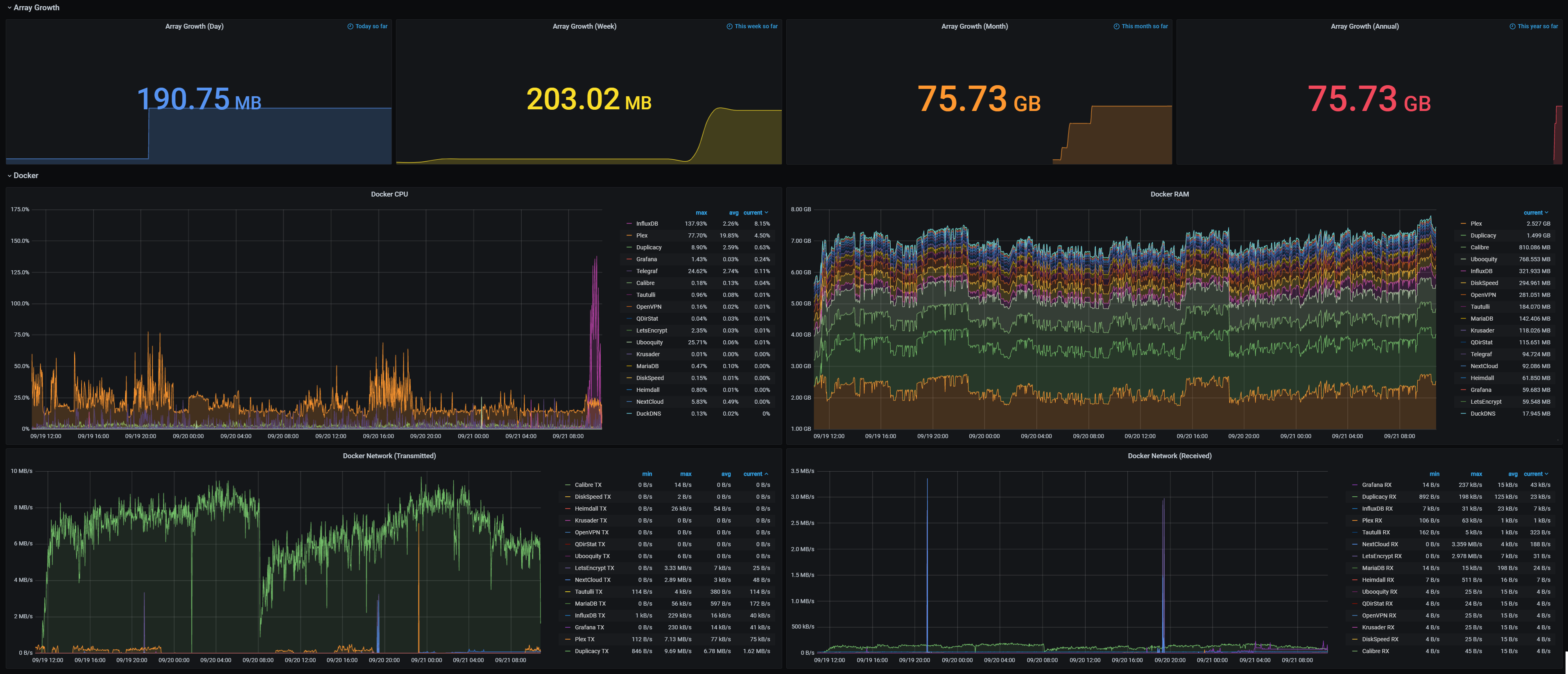

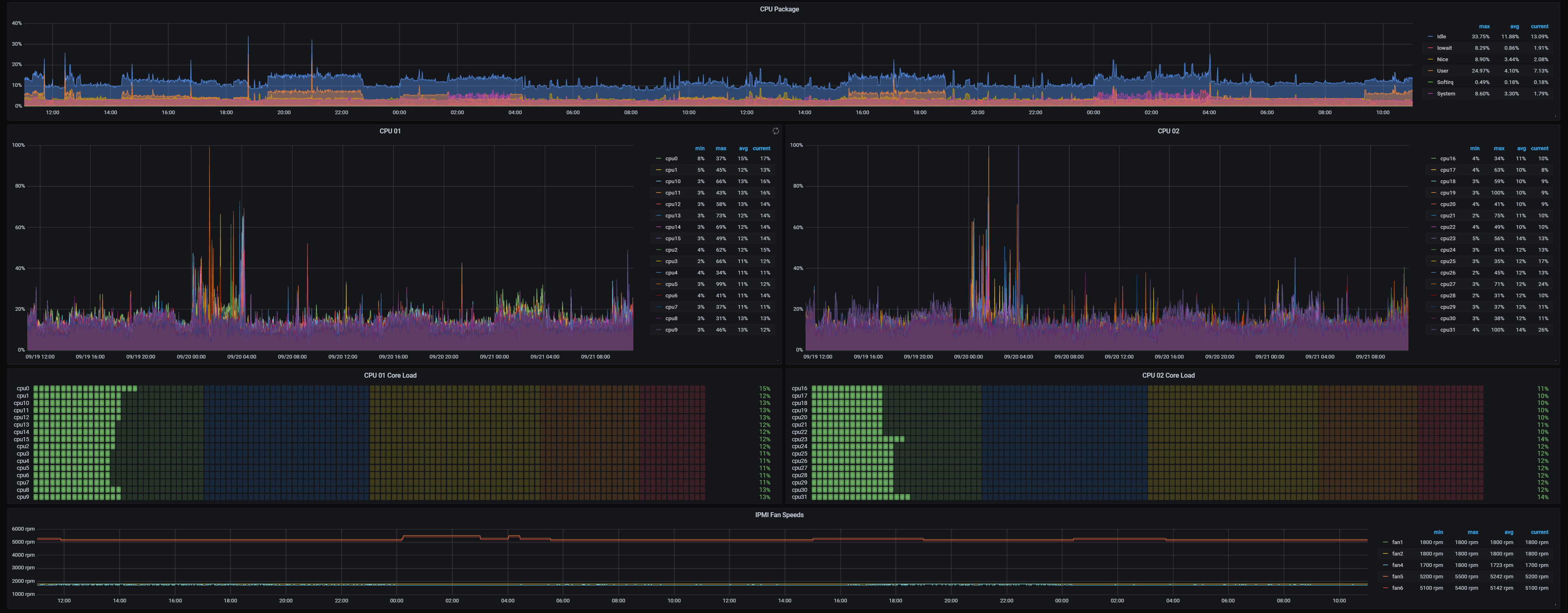

Hi everyone. Just wanted to post this here in case anyone was interested! Introducing the Ultimate UNRAID Dashboard (UUD). I just released version 1.3 last night.
Forum Post:
Version 1.3 Screenshots:
Edited by falconexe

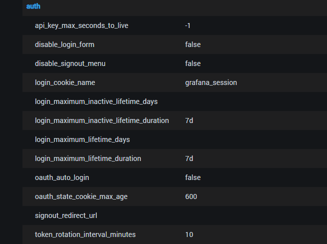

Any chance anyone knows how I can prevent grafana from logging me out / requiring me to relogin so often?
I haven't timed it but I'm guessing its ~10 min
Looking at the settings page in the grafana webui I was taking a guess I might need to change the "token_rotation_interval_minutes" value?
But I'm not sure what environment variable I'd need to set.
Tried
GF_TOKEN_ROTATION_INTERVAL_MINUTES
and none of them seemed to change it.
Tried
Try a different browser on the same computer, and then try the same browser on a different computer. That is not normal behavior, nor should you have to explicitly set something to stop this behavior. Out of the box, Grafana does not auto log you off. Credentials are stored in browser cookies. If cookies are cleared, you will have to log in again. Might be a browser specific setting...
Cool thanks for the info, gives me a direction to troubleshoot in anyway!  Thanks

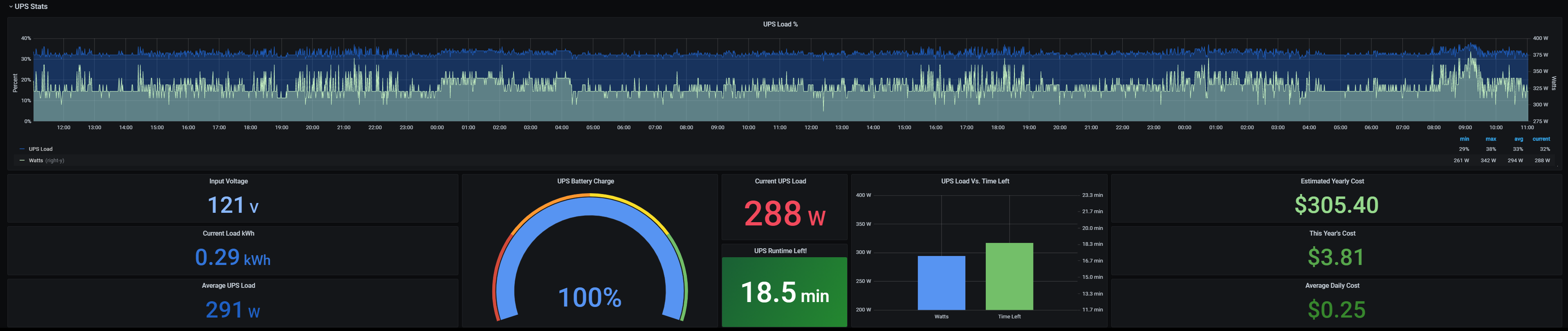

On another note, I just released the Ultimate UNRAID Dashboard Version 1.4!
@testdasi, feel free to include it with GUS in your next update.
Check it out Here:
