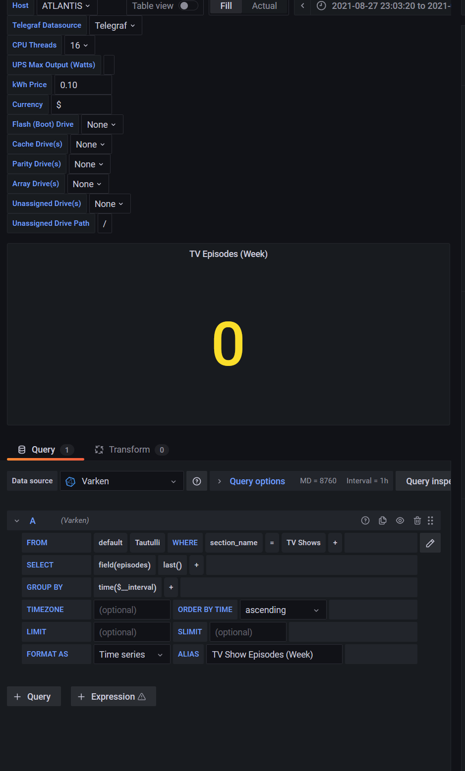

I've been using Grafana flawlessly for over a year with InfluxDB and Varken behind the Ultimate Unraid Dashboard 1.5.
I'm not sure if it was a Docker container update for any of the three above, but now Plex data is not showing in the Grafana Dashboard. Attached is an example for "TV Shows added this week" All other Plex data (Streams, Clients, etc) is showing old or no data.
If it helps diagnose, all other Unraid data on the dashboard is working fine EXCEPT "data added to array" info for day, month, year. Its like that counter reset, I'm guessing the same time as the Varken data went wonky.
I've looked at the Varken and InfluxDB databases, rolled back their docker containers, no luck.
Any help or guidance appreciated.
Anyone with any thoughts at all on this? Thanks!

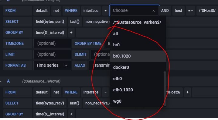

Anybody had Telegraf not detecting all network interfaces ? I have Network card in bond and some VLANs... in Telegraf I setup inputs.net without parameters to take all (I also tried to specify which interfaces) but in the Grafana I can only see some of them.
See the attached pic.
But my ip a looks like this:

I would like at least the bond0 to be monitored (so far I have it via plugin in unraid that generate graphs ok, but not in Grafana...)
Ok I will answer my own question.
The image absolutely have to be as Network Type: Host ( I had it on its own VLAN ) otherwise for some unknown reason even though we are mounting /proc into the container the file /proc/net/dev is different in container (It does not make sense... ) and you can't even mount it directly, the container will not start... so Host only to have network... :-/
https://github.com/influxdata/telegraf/issues/4505

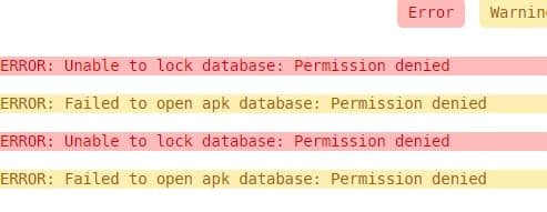

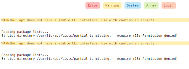

I was having the same problem, noticed it updated over night and now doesn't work.
TL;DR this happens in the new version because the docker no longer runs under root and I had some extra parameters that's running `apk` which isn't allowed by the new telegraf user.
Longer explain:
A google lead me to info about it being a user permission issue: https://stackoverflow.com/questions/50727783/alpine-docker-error-unable-to-lock-database-permission-denied-error-failed-to
Then looked at the dockerfile in github, it seems prior to Oct 15, the telegraf docker was running as root. They changed this to use 'telegraf' user, see commit here: https://github.com/influxdata/influxdata-docker/commit/83520188be87cbee6edb3ac995c647cf99acdf51
The error in my case was happening becuase I add some apk pakages by docker settings -> advanced -> Post Arguments
/bin/sh -c 'apk update && apk add lm_sensors lm-sensors-detect perl && apk add smartmontools && apk add nvme-cli && telegraf'
After removing those argument, I simply get an error in the log because it can't find smart (which was removed):

I'm getting different error after update. Anyone know how to solve this one?
I just reverted to v1.20.2 now working again.
i downgraded to 1.20.2-alpine and no longer face the apt error but now i have new issue whereby it cant connect to influxdb:1.18.4-alpine
