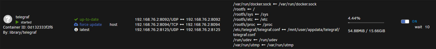

I recently set up Telegraf+InfluxDB+Grafana (+HDDTemp).
In order to get Nvidia GPU stats, I changed my telegraf repository from alpine to latest. Life was good.
However, I've just noticed that, in the Docker tab of unRAID, the Telegraf icon is missing and the docker container name is no longer a link to edit the template. If I click the docker icon, I only have the options of Console, Start, Stop, Pause, Restart, and Remove. Telegraf-DockerView.thumb.png.4f0d932f5925862ec3532fc9ca026405.png
My Grafana dashboard is still populating properly. So, Telegraf still appears to be doing its job.
That said, can anyone help me figure out what I broke? Or is this just the price of switching the repository (I would switch back to confirm this but as stated, I can't edit the template)?
EDIT: Found the problem...somehow the my-telegraf.xml file at /boot/config/plugins/dockerMan/templates-user was deleted. Not a clue how that happened as I don't make a point of rooting around in /boot unnecessarily. In any case, thanks to the CA Backup/Restore Appdata plugin, I copied the file back to /boot. A refresh of the Docker tab shows I'm back to normal (icon and all).
Edited by rragu
Problem solved
Probably the cost of switching the repo. See the bottom left of you screenshot? Libray/telegraf. You customized it. You might be able to go into the file system where that template info is stored and put the icon there.
Edited by atribe
Thanks!
EDIT: Solved both issues as described in my post above.
Edited by rragu

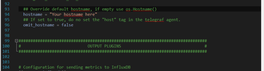

It jus doest that i guess. Same happened to me. Change hostname in line 94 in telegraf.conf (se attached pic)image.png.75d9e51cfffa99e24562f60d9f1a2720.png
Thanks for the reply... I tried that but my graphs no longer work. I can only get graphs to work if I use 68239e66048b hostname and that now appears to change at intervals. It's something to do with the way I have my IP addressing setup but I'm at a loss at the moment.

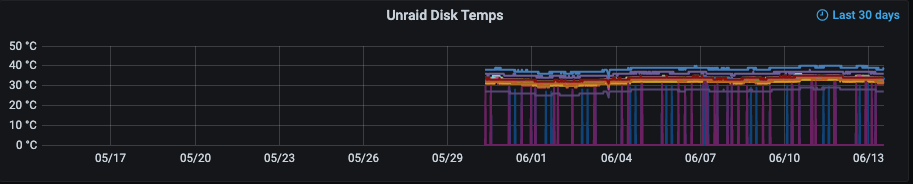

I don't appear to have the same problem with HDDTemp, but I do have another problem. Since switching to this docker I'm getting the following graph:
The two disks with the vertical lines are usually reading at 0deg but will occasionally read the correct temps. The two disks in question happen to both be Seagate 4TB disks, but they aren't my only of that type. No other disks are behaving this way. Nothing unusual in the Unraid syslog.
I happen to have another docker that's pulling Netatmo stats from the API. This one also quits reporting from time to time. I don't know if this is an Unraid docker problem, or if it's specific to how the container works.
Any advice is appreciated!
No change since I posted this a week ago. I'm still getting the drop outs on two disks. Any thoughts on where I should look?

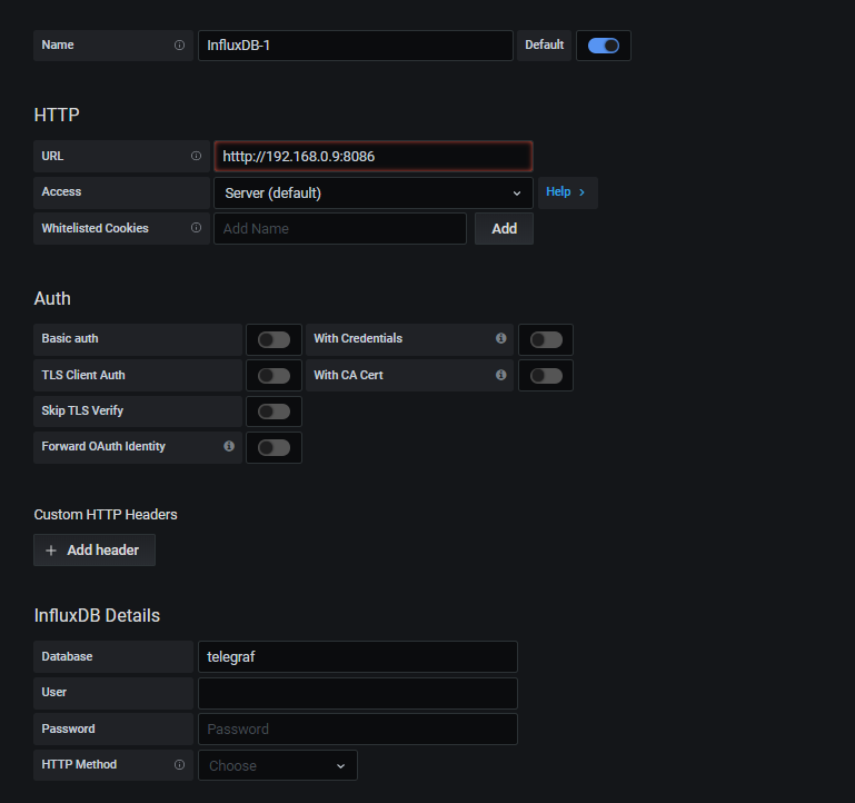

Grafana Raw Data question
I am having a bit of a problem is getting raw data into my Grafana.
I have followed the attached URL to install and set up my Config File
I then want and tried to add a data source but I am informed the following  Network Error: Bad Gateway
and I can't see were I have gone wrong.
I have attached a copy of my Config file and also a screenshot of my Data Set in the hope that someone can see my mistake
Update:  my problem was a typo in he URL
telegraf.conf
Edited by chris_netsmart

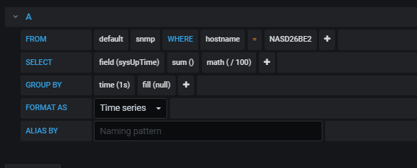

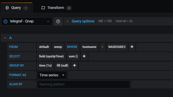

I am having a  little problem, which I am trying to resolve, and getting a bit confused.
I have done the snmpwalk command and got a long list of results from my QNAP.
I have then gone through and located ' I think I have the right variables ' for the data which I want to capture.
##   HOST-RESOURCES-MIB::hrSystemUptime.0 = Timeticks: (17473469) 2 days, 0:32:14.69
##   HOST-RESOURCES-MIB::hrSystemDate.0 = STRING: 2020-7-27,14:9:48.0,+0:0
##   HOST-RESOURCES-MIB::hrStorageUsed.33 = INTEGER: 86926
##   HOST-RESOURCES-MIB::hrStorageUsed.7 = INTEGER: 30400
now here is the bit I am not a 100% sure about,  I have then gone to telegraf configure file and added the following code so that it knows were to go and collect the right information
# # Retrieves SNMP values from remote agents
 [[inputs.snmp]]
#   ## Agent addresses to retrieve values from.
  agents = ["udp://192.168.0.100:161"]       # QNAP
#  timeout = "5s"                    ## Timeout for each request.
  version = 2                          ## SNMP version; can be 1, 2, or 3.
  community = "storage"           ## SNMP community string.
  retries = 3                         ## Number of retries to attempt.
  name = "snmp"
#  System uptime
   [[inputs.snmp.field]]
     name = "sysUpTime"
     oid = "HOST-RESOURCES-MIB::hrSystemUptime.0"

update:  I have found some working code that displays the amount of up time the Qnap has been running but at the moment, it is showing a number is is miles away from the real time.  explain I just rebooted my Qnap and it shows that it has need running for 10 mins were as Grafana is saying it has been running for 4 days.    is I don't understand
here is also a screen shot my of my code within Grafana
any ideals ?
UPDATE: Found the solution. after a lot of reading you need to do the following in Grafana  (   Add Math(/100) )

I followed the guide at Reddit, which has been working great. I decided to try and get HDD temps, so I added the [[inputs.hddtemp]] to my telegraf.conf file and restarted Telegraf and now I get the following error:
2020-07-28T14:01:50Z E! [inputs.hddtemp] Error in plugin: dial tcp 127.0.0.1:7634: connect: connection refused
My Telegraf container has it's own IP address, and the HDDtemp container does not get an IP address assigned. How do I tell Telegraf where to go to get the data from the HDDtemp container if it doesn't have an IP? I tried using "address = [unraidIP] in telegraf.conf, but it didn't help.
@Arindrew give me 24 hours and i will dig out my notes and.piat it for you.   I do reminder that it is very easy.  I just bet that you have over looked something.
