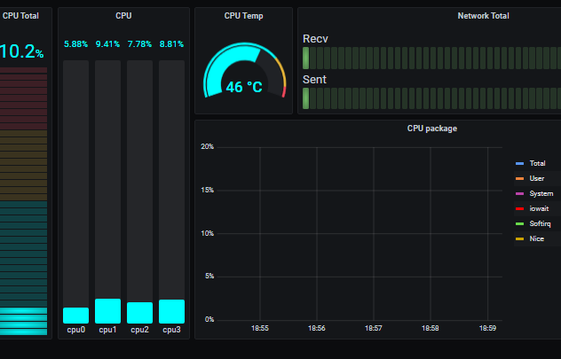

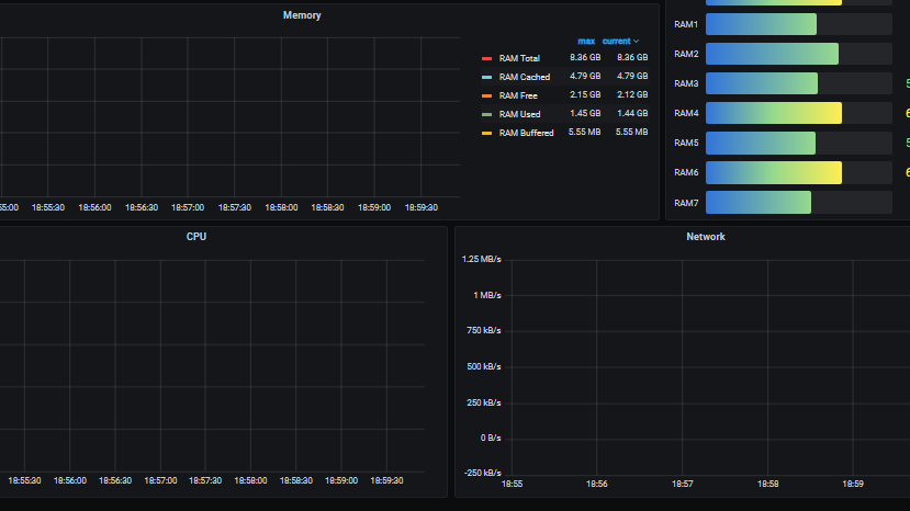

Hi, I hope you can help me.
I used Grafana a while ago and everything was fine.
I had to reinstall Grafana now (hard disk dead, no parrity, I know...😑)
Anyway, no stats work now?! (the configuration is the same).
I searched several forums for the same problems, and tried everything, without success.😡
Is this a bug, can someone help me?

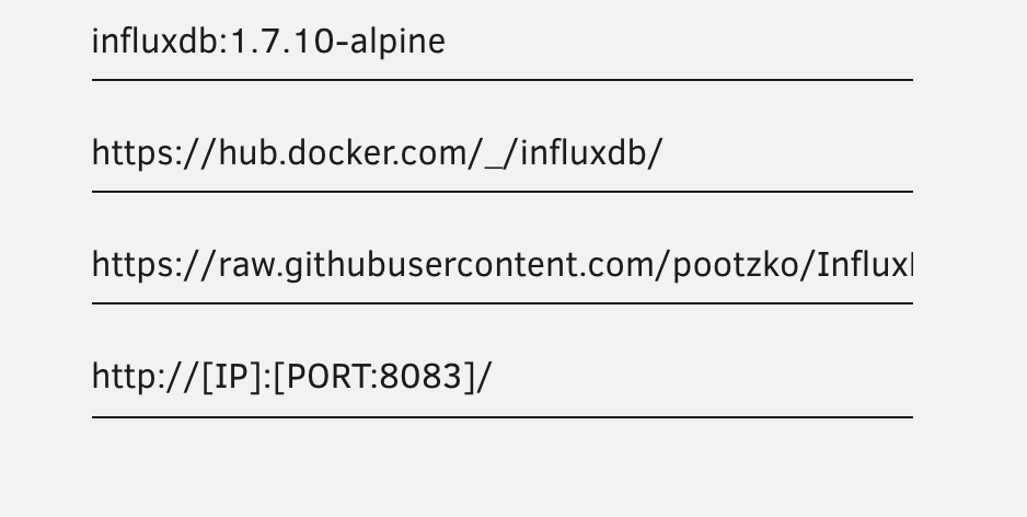

The update changed it to influx 2.0 you need to go back to the 1.X version.
I changed mine from latest to influxdb:1.7.10-alpine
Everything started back up and and all is good with the world again.
