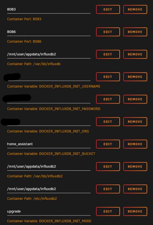

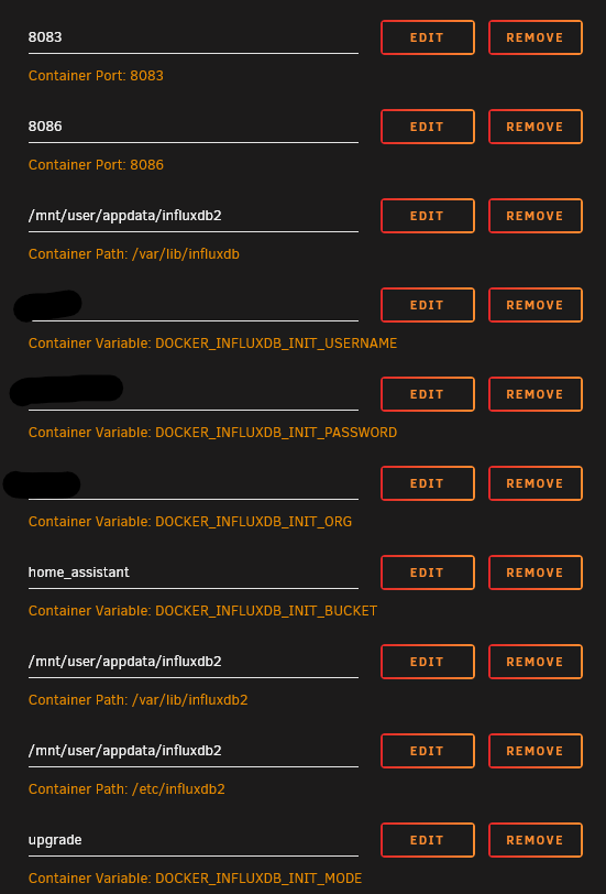

Morning, I'm trying to migrate my influxdb to v2 from 1.8. I've followed the information here but i'm not sure that the data has converted, I dont see any major disk activity, and don't see anything in the logs. I want to try and retain the few years of data i have if possible. I've added the following to my docker image: I've created a copy of the influx folder and called it influxdb2, and setup another instance of the influx docker, giving it a different name and mapping the above fodler so I can keep 1.8 connected to HomeAssistant until i've made sure that I'm doing the process correctly. Any advice on how i can migrate the data please?
EDIT: There was a .bolt, so I removed that and now the logs are showing that it is doing something.

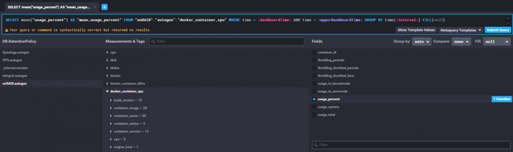

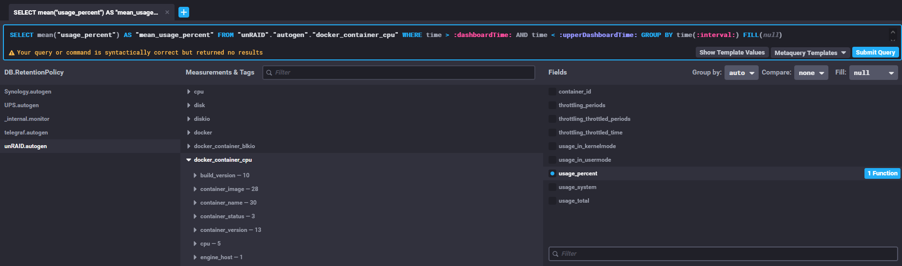

My InfluxDB/Telegraf setup has stopped producing any docker-related statistics (e.g. docker_container_cpu), since some time late last October.  Any ideas what could be going on?
I didn't change the configuration and I did not upgrade to InfluxDB v2 - repo points at influxdb:1.8-alpine.
I checked my telegraf.conf, [[inputs.docker]] is not commented out.
I used Chronograf to do some data exploration and got the same lack of results, see attached screenshot.
Any suggestions for what else I could check?  My dockers themselves are still working just fine.
unRAID version is 6.8.3, I tried rebooting but the problem persists.
Thanks for any tips!

Hate to reply to myself, but... I think I've figured out what's going on.  Looking through my Telegraf logs I get lots of messages like:
E! [inputs.docker] Error in plugin: Got permission denied while trying to connect to the Docker daemon socket at unix:///var/run/docker.sock: Get "http://%2Fvar%2Frun%2Fdocker.sock/v1.24/containers/json?filters=%7B%22status%22%3A%7B%22running%22%3Atrue%7D%7D&limit=0": dial unix /var/run/docker.sock: connect: permission denied
The permissions seem OK though:
# ls -l /var/run/docker.sock
srw-rw---- 1 root docker 0 Mar 29 00:04 /var/run/docker.sock=
I've seen some advice about doing a chmod 666, but that seems a bit insecure...
root is a member of the docker group, so I'm not sure why I'm getting "permission denied".  Which user is Telegraf trying to run as?
Edit: Problem solved!!  Turns out Telegraf 1.20.3 (and beyond) breaks some things by no longer running as root.  The simplest solution is to just pin your repo to telegraf:1.20.2-alpine.  Thanks @axipher for your helpful post!
