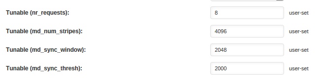

You didn't post your tunables, although not universal, try the ones below, they give good performance with almost all hardware I've tried and should be better than whichever settings you're using.

I thought I read earlier in the thread that since one of the tunables was removed the script was suboptimal, but the normal scans didn't change that value anyway.  Maybe I misunderstood.  In any case, I think sync_window changed increased to the next power of two and that was it.  I only changed the one parameter.
Using the same order as that image, my settings are 128, 1408, 512, 192... so, vastly different.  Will give those a shot.
I have 16GB ECC RAM and sit at about 25% utilization, typically, if it matters.
