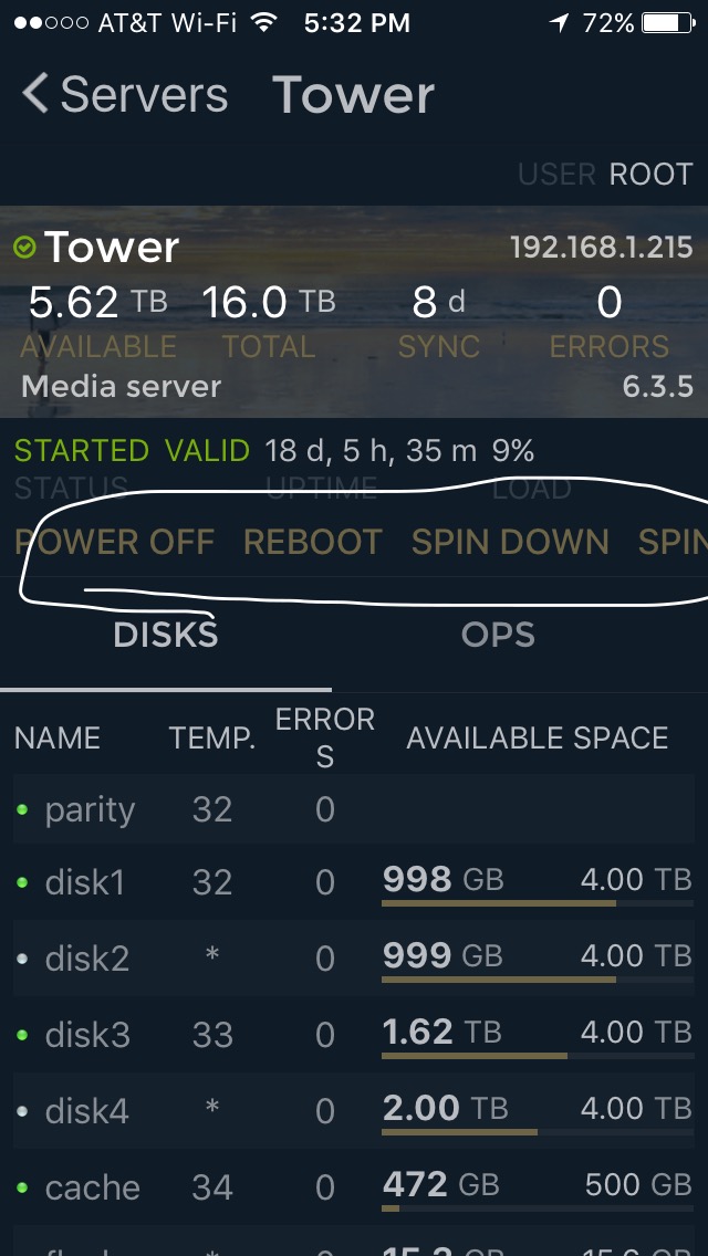

I just updated the app.  I think I remember the "operations" selection being scrollable.  Here's a screenshot capture with the items circled.
No, that section has never been scrollable.
But also note that ERRORS text is split in two 'rows'.
Is it possible that you increased the text size in the display & brightness settings of your iphone ?
If that's the case, you can decrease the text size in the app (to small) so that it 'fits' the screen.
Or reset the iphone's text size (restart the app if you do that) and set the app's text size to normal.
That's probably it. My 57 year old eyes need a little extra size in fonts these days:-)
I'll experiment with another size.
Ok, in any case, I'll check why the operations section doesn't 'wrap' (the way ERRORS did).

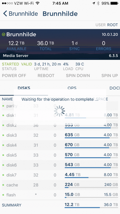

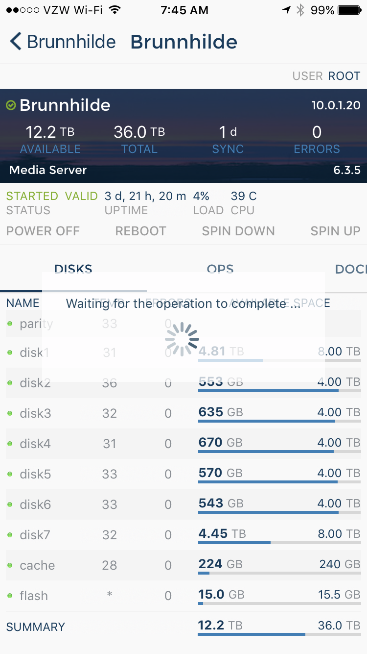

Have only just started testing, but looks like powerdown isn't working. I just get this-
After about 5 minute wait I connected to the server via browser and realized nothing had happened.
Reboot also seems to not be working. Have to quit the app on my iPhone or else it just sits with the spinning wheel. Tried deleting the server and re-adding with same results. Diagnostics are attached. If there's a separate log just let me know.
As far as I can tell all the other ops are working properly.
brunnhilde-diagnostics-20171004-0851.zip
Edit: @jbrodriguez I know this thread is for the plugin rather than the app. Just want to be sure you're aware that not all issues are fixed with this update.
Edited by wgstarks
Thanks for the report @wgstarks !
Yes, the powerdown/reboot issues are app related, I've fixed them in my dev environment.
A new app release should be out soon™ :D
