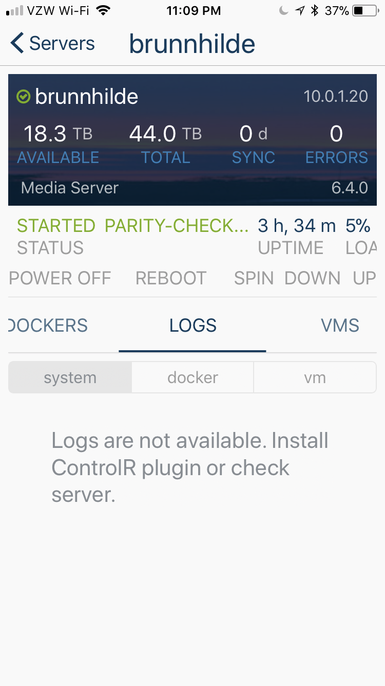

This plugin doesn’t seem to be working with 6.4.0.
Controlr plugin is installed on the server.
Certainly strange.
Do the plugin logs show anything unusual ?
Did you switch between https/http ? Have self-signed certs ?
Let me know to further troubleshoot.

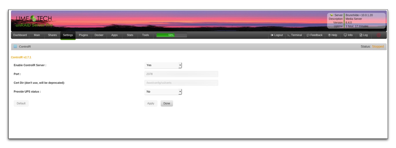

Updated the plugin and now can't get it to start-
Also, can't delete the cert dir.
Clip from sys log-
Jan 19 20:19:09 Brunnhilde ool www[22902]: /usr/local/emhttp/plugins/controlr/scripts/start
Jan 19 20:19:09 Brunnhilde sudo: root : TTY=unknown ; PWD=/usr/local/emhttp ; USER=root ; COMMAND=/usr/bin/bash -c /usr/local/emhttp/plugins/controlr/controlr -port 2378 -certdir ''

I got the same with CLI. Used the webGUI and just manually entered the cert dir path and I think that part is fixed.
Jan 20 08:36:48 Brunnhilde ool www[1414]: /usr/local/emhttp/plugins/controlr/scripts/stop
Jan 20 08:36:55 Brunnhilde ool www[27202]: /usr/local/emhttp/plugins/controlr/scripts/start
Jan 20 08:36:55 Brunnhilde sudo: root : TTY=unknown ; PWD=/usr/local/emhttp ; USER=root ; COMMAND=/usr/bin/bash -c /usr/local/emhttp/plugins/controlr/controlr -port 2378 -certdir '/boot/config/ssl/certs'
Plugin still doesn't start though.
