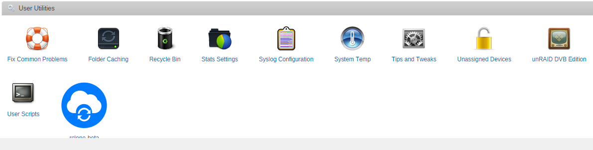

Hey guys!
I've pushed an update to the beta branch that updates the rclone version to the latest beta.
However in other and bigger news the new beta includes a very (very) basic webgui that allows you to edit the rclone.config as well as a few template scripts that can be edited and moved to the User Scripts Plugin all from the unraid webgui. I'm sure you might find some bugs but it's a start, and i've been using it in my own setup the last couple of days with no hickups :)
Any suggestions for improvement are very welcome :)
Great work,
I haven't tested the scripts yet, I already have some working once, but it is a good step forward for new users.
Only issue I did spot is that your icon seems to be a different size to the others.
Try clearing the browser cache - I have downsized the icon, so either its not getting overwritten with the new 48px icon or your browser cached the old one :)
I just reopened the web interface it and its fine now.
Thanks
