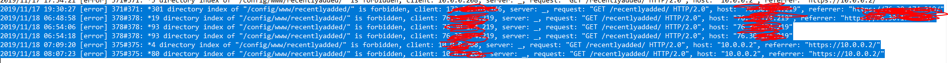

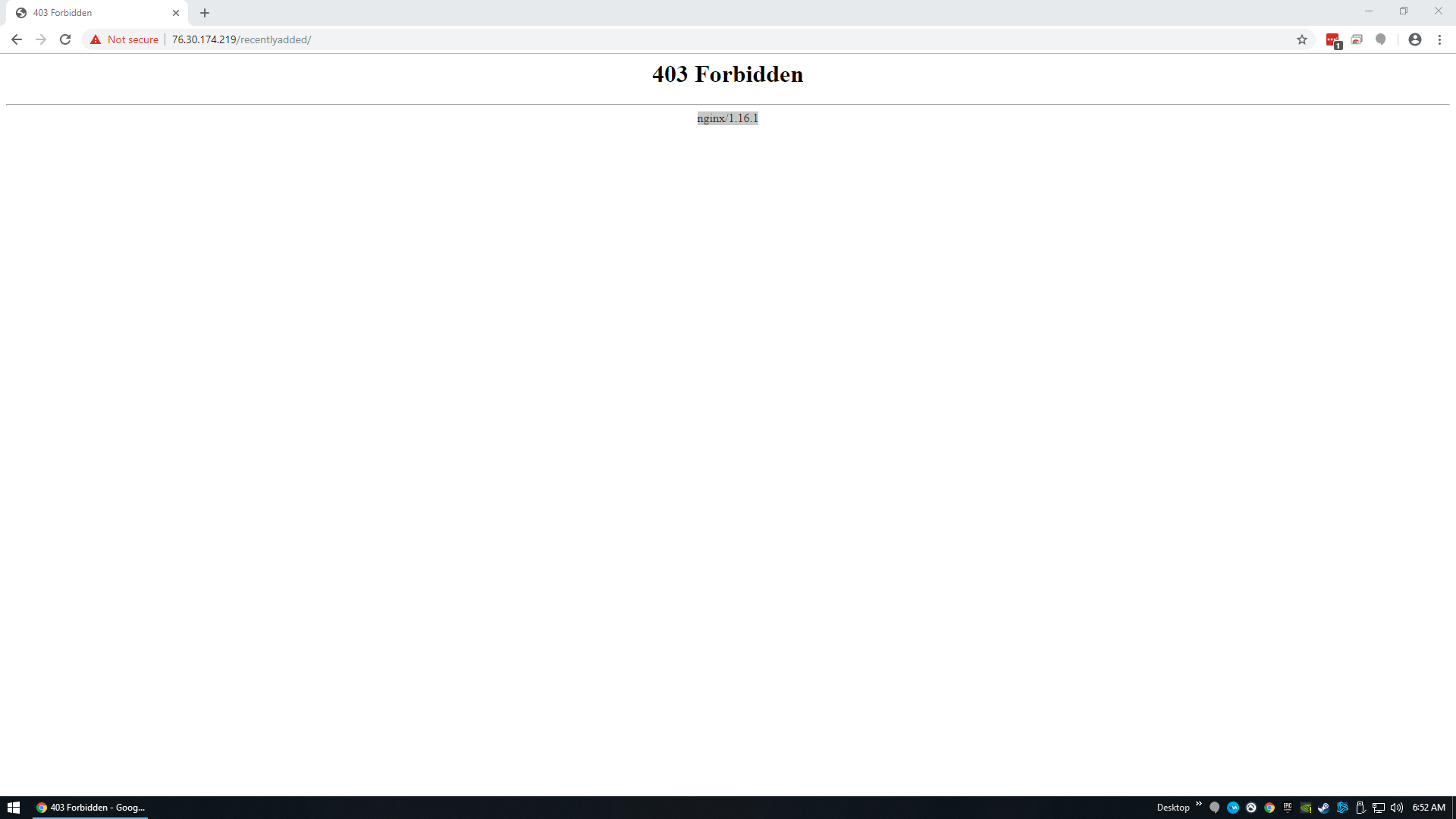

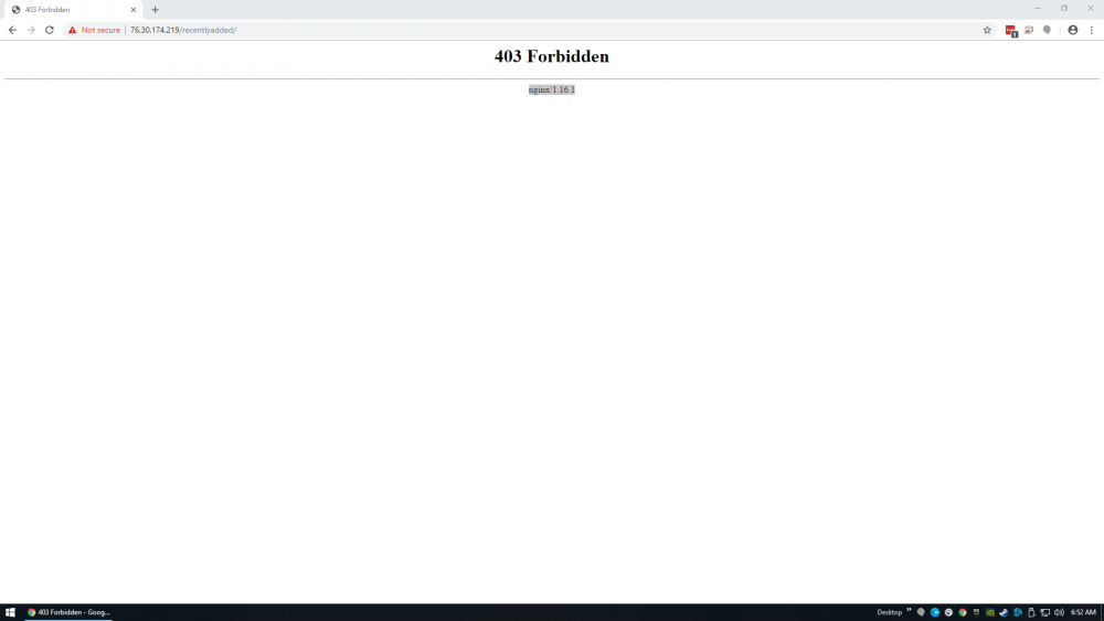

1 hour ago, saarg said:
Permission issues is my guess. So check the permissions on the recentlyadded folder. Should be nobody:users
Everything has full access - i even changed the permission via unraid terminal and terminal on the container as well
Edited by Ladrek
Link to comment
If you are going to post a screenshot of permissions, please post the ones from unraid command line, not something from windows.
