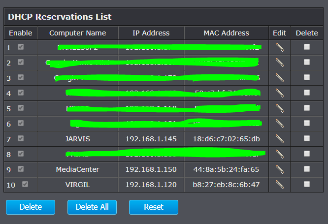

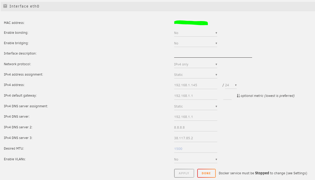

How do I create a static dns record? I have done the following in the UnRaid server.
Then in the router I have done the following through the DHCP List:
So:

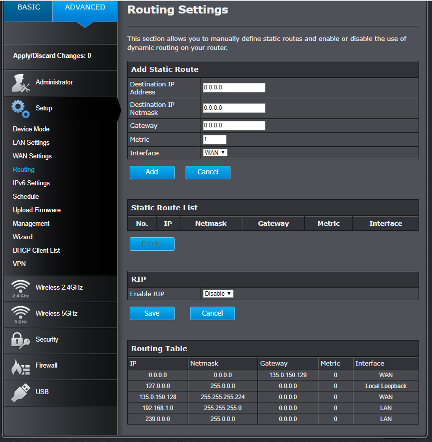

Ok I found this, is there where you can set the loopback?
I've been poking all round your emulator trying to find a loopback / multi-homed thing or perhaps even a DNS rebind and not found anything.  I've also looked in the software for custom DNS records which is also not available.
Someone else may have better luck than me, but to be honest this is not uncommon with consumer routers.  Which is why DD-WRT was born - you can flash your router with firmware that does have these kinds of features.  The router compatibility list is here: https://wiki.dd-wrt.com/wiki/index.php/Supported_Devices#TRENDnet
It appears your router is still a work in progress, but perhaps you can have a poke around there - they may have a working beta or something.
So for you, the best thing will be to put the settings manually into the hosts files of your internal computers.  Or get a different router firewall.  If you want to go the whole hog you can get your own firewall like opnsense.  Or take your luck with another consumer router.

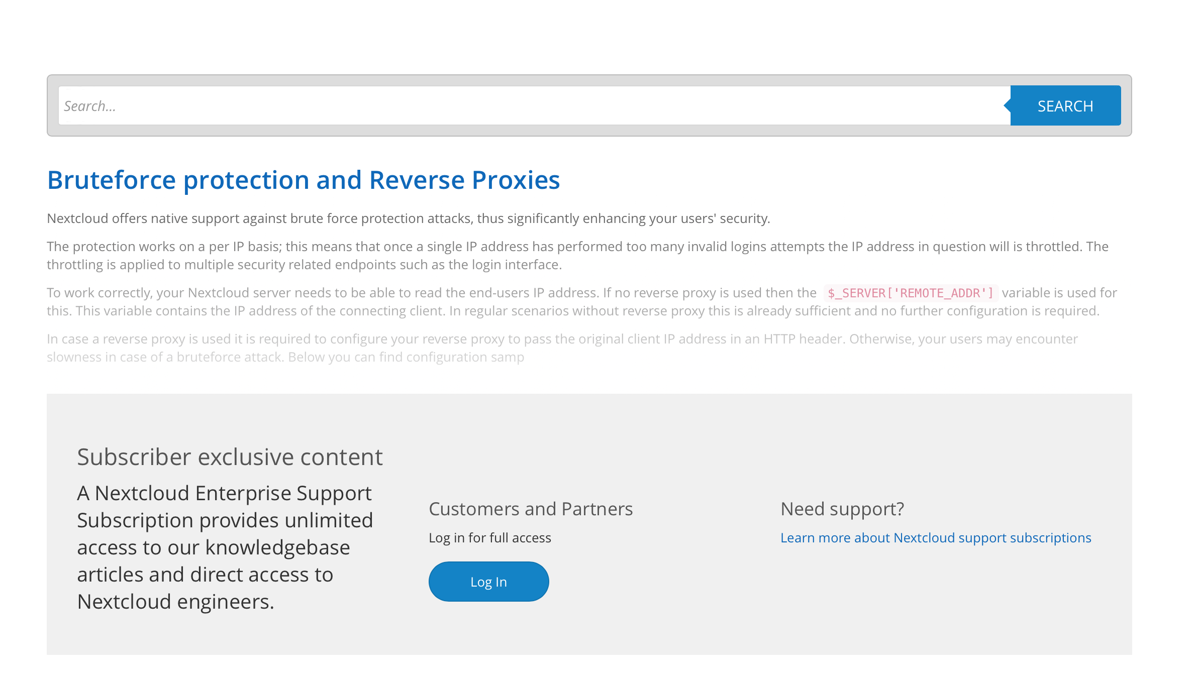

I am trying to setup fail2ban with the nextcloud, letsencrypt and OnlyOffice Document Server dockers, (Nextcloud, letsencrypt & ONLYOFFICE currently work perfectly)  When I look at Nextcloud's log file it shows all logins are coming from a single IP, probably because of the letsencrypt reverse proxy. So I found this page but it says I need a subscription to view it.
260196963_ScreenShot2019-10-27at4_24_14PM.thumb.png.a2c4cad7947f7fb8545685326cbc73f1.png
Can anyone help with allowing the reverse proxy to pass the client IP so I can configure fail2ban to work using this as a rough guide:
https://dennisnotes.com/note/20180831-nextcloud-docker-nginx-reverse-proxy/
Are these the lines that I need to add to the letsencrypt conf file for nextcloud that will do the client IP passthrough?
proxy_set_header X-Real-IP $remote_addr;
proxy_set_header X-Forwarded-For $proxy_add_x_forwarded_for;
proxy_set_header X-Forwarded-Proto $scheme;
Do I need to add all three or just one or etc? I am not exactly sure what they do which is why I don't want to add them....
