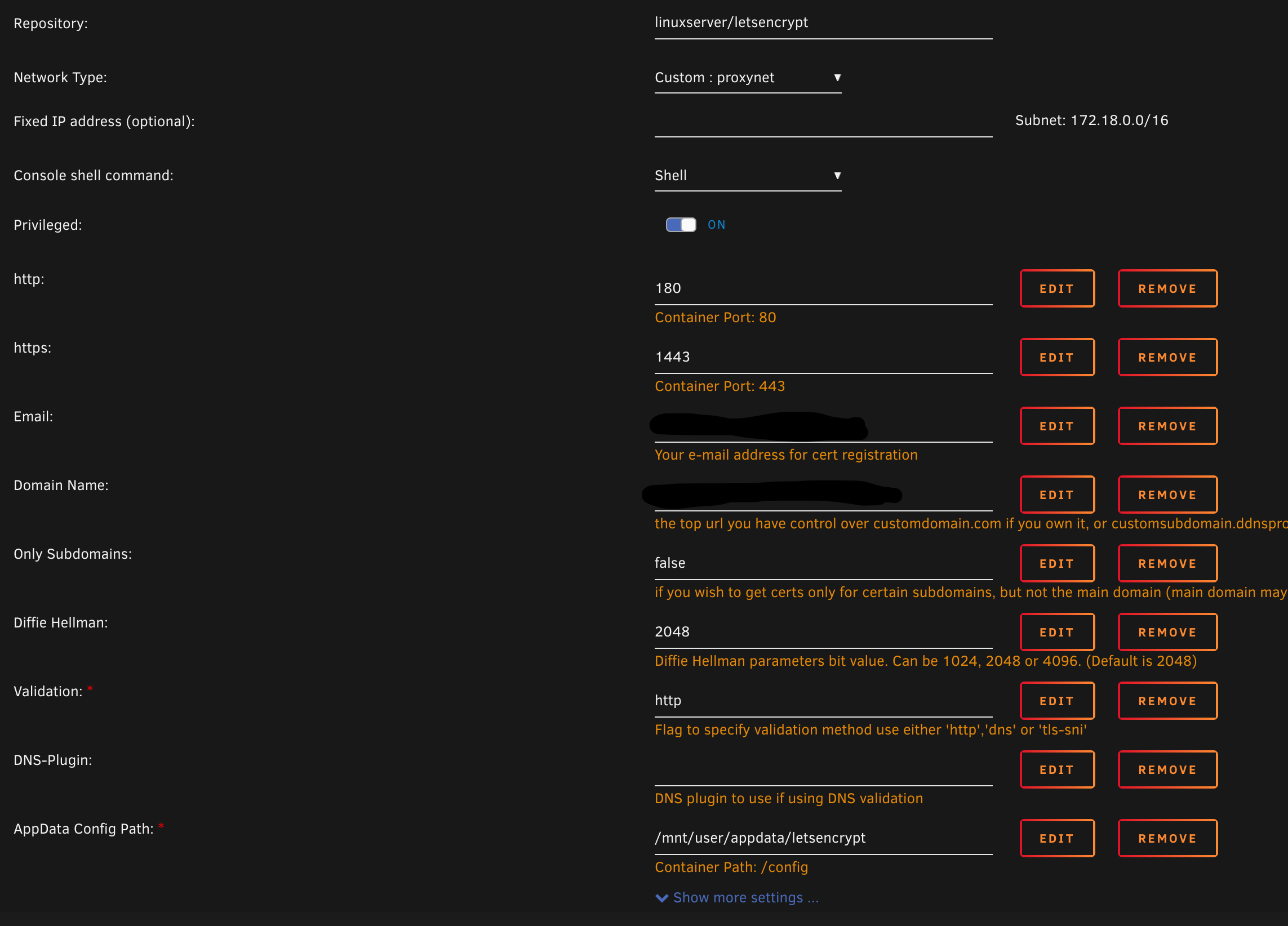

I updated letsecrypt this morning and i cant reach Nextcloud. I have looked through the thread and cant find anyone having the same problem. After the update i cannot go to my nextcloud using the web browser. "Your connection is not private" and "NET::ERR_CERT_REVOKED". Can someone help me please or direct me to someone that was having the issue and have fixed it. Thank you guys.

Maybe something on the router / DNS side?

Have you found a solution for this I also have been trying to solve it and tried these options without luck. One thing I found out is that you can manually test the websocket call via this command: curl --insecure --include --no-buffer --header "Connection: Upgrade" --header "Upgrade: websocket" --header "Host: example.com:80" --header "Origin: http://example.com:80" --header "Sec-WebSocket-Key: dGhlIHNhbXBsZSBub25jZQ==" --header "Sec-WebSocket-Version: 13" https://192.168.x.x:443/
(Found it on this page https://help.ubnt.com/hc/en-us/articles/115015690147-UNMS-Device-Discovery#blocking discover)
And I noticed that the websocket call does not work going through the nginx proxy. I can make it work if I go directly to the unms server and port. And I also can access the UI, just the registry does not work due to the websocket calls not going though the nginx/letsencrypt reverse proxy.
Any one else have any luck with unms ?
