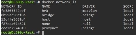

Hi - I hope someone can help... I have been trying to setup a reverse proxy (following SpaceInvader Ones excellent video)... but when I create a docker network called "ProxyNet" - it doesn't appear in the config page for setting up LetsEncrypt. Its definitely there as I can view it from terminal, but it just isnt listed in the drop down box. I am using UnRAID 6.5.0. Attached are a couple of pictures, one showing the options I have in the LetsEncrypt setup page and one showing "ProxyNet" exists when I list the docker networks in terminal.
Any thoughts?
Thanks
Any thoughts?
Thanks
Update to latest unraid first, then come if you have the same issue.
Thanks - but I am reluctant to upgrade as the server is an HP DL380p G8 in a remote datacenter and when I upgraded to the latest version I had massive problems (no mouse or keyboard control in ILO) ending up with the machine falling over and I had to drive to the DC, remove it, roll back to 6.5.0 to get it working then drive it back to the DC. Apart from changing the onboard P420i RAID controller to work in HBA mode rather than RAID I have done nothing to comfort me that I won't get the same problem again if I upgrade.
All I have on the machine, which I am using, is a number of VMs (Ubuntu Webservers / Exchange Server), then 2 dockers MariaDB and NextCloud. But am keen to get reverse proxy working.
Thanks - any other pointers would be well appreciated.

I would say that your issue isn't a container issue but a bug within unraid 6.5 itself, I would contact lime tech about it or search the forum to see if someone else has had this issue (I suspect someone has).

OK, I consider this solved now... not ideal, but in case anyone else finds this thread @j0nnymoe seems to be correct.
I also had an HP Microserver running 6.5.0 at home, because it had the same issues with the new version as the machine in the DC... so, as it's here and I can easily access it, I just upgraded from 6.5.0 to 6.7.2 and now I do see the custom network in the settings for LetsEncrypt - so this certainly does look like a bug with 6.5.0. I will monitor this machine and see if it behaves with 6.7.2!
So, it looks like I'll have to schedule a visit to the DC and then try the upgrade on the DC machine the night before - that way if I lose connection I will be able to pop in the next day to fix it, rather than having it offline while I wait for a slot to get in 😑
Thanks for the advice @j0nnymoe
