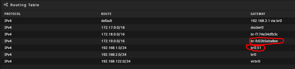

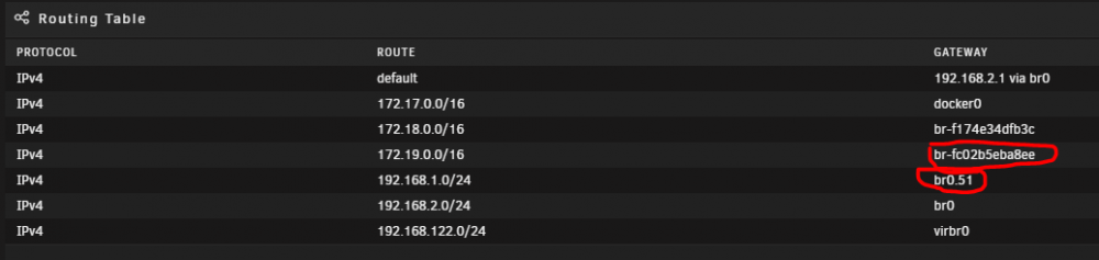

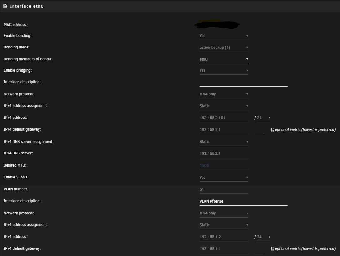

2 hours ago, aptalca said:
If sonarr and radarr are on macvlan, and others are on a custom bridge, they won't be able to connect to each other. That's a docker security feature to prevent connections between the host (and the host networks) and macvlan
Ok so just to confirm, with macvlan you mean this VLAN (VLAN pfsense) ? :
My custom network for ombi and other proxy containers are on the br.fc02.... and the br0.51 is the pfsense network:
If in my case there is no way to do it with Unraid, is there another possibility through my unify controller? i also have a ubiquiti managed switch i was hoping to use in case i can't config it within Unraid...
Thanks for your help aptalca! :)

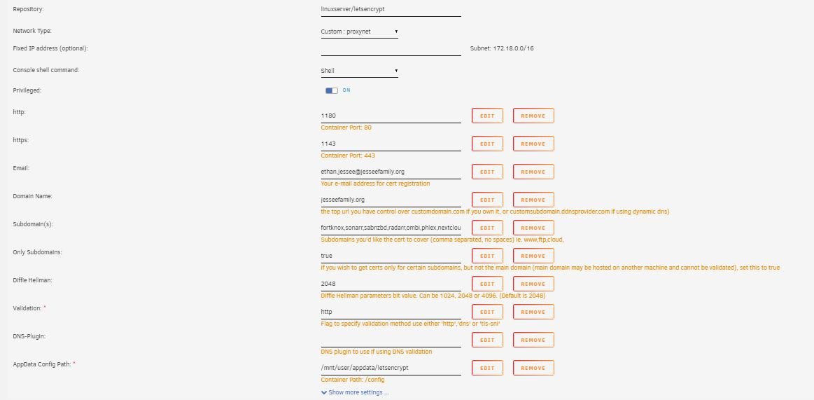

Newbie here. Trying to get the container setup but it is failing on all of my subdomains during the http-01 challenge verfication.
Setup:
domain - jesseefamily.org (subdomains have been setup for various other containers and CNAMEs have been added to the domain to point to a DDNS service. So far, everthing is routing correctly)
DDNS - using No-IP
Router: Have forwarded ports to 80 and 443
letsencrypt.log
There are three types of networking for docker: host, bridge and macvlan.
Host and bridge networks use the same ip as the host machine. Macvlan let's the container get its own ip. In this case you're using macvlan, and it has that security feature where it blocks communications between the container and the host ip (and everything that's using that ip).
I don't know what your other containers are on so can't comment on them.
Setup:
DDNS - using No-IP
Either your ip is incorrect on your dns, or your port forwarding is incorrect.
