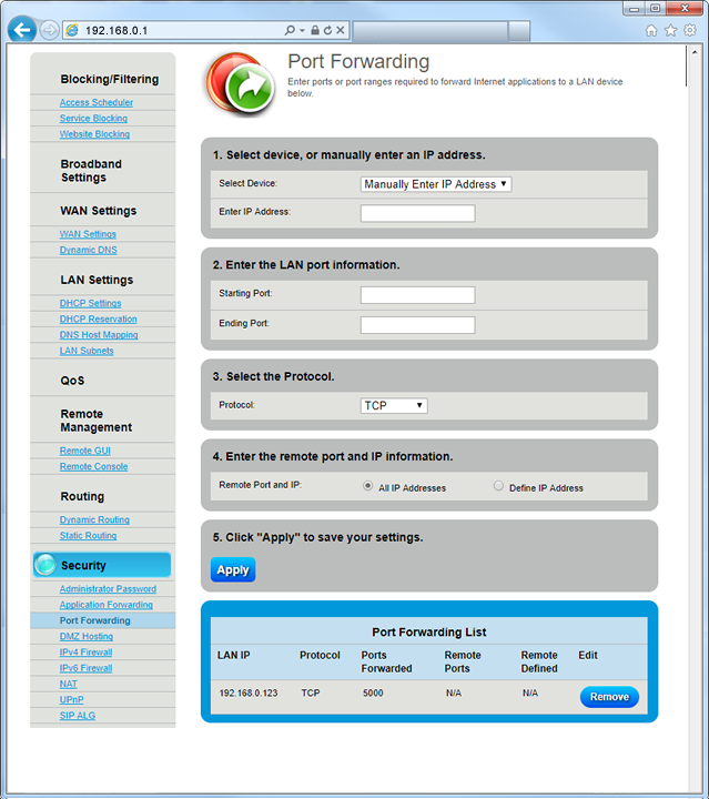

July 20, 20197 yr 17 hours ago, saarg said: I think you don't fully understand port forwarding. You are not forwarding port 8008. You are forwarding port 80 on the Wan side to port 8008 on the container. So on the wsn side it's always 443 and 80, but in the actual router/firewall you use the Wan side ports as the source ports and the ports you set in the container template you set as the destination ports. From looking at your screenshot, you are just opening the ports, and not port forwarding. No, I fully understand port forwarding. I'm just really distracted lately and at the risk of getting too personal, I'm on some new ADD meds that are kind of messing with my memory and cognition (and you guys have been super patient with me so thanks). I see what you are saying now, I just didn't notice it before. The router doesn't allow me that level of control like my other did and I just didn't notice it until you said something. It seems I can only forward a port to a specific IP of the SAME port. The layout sucks but it seems start port and end port refers to port range and not source and destination. I included a stock image of the menu (not what I actually have in my settings). So I don't think I can forward port 80 from outside my network to 8008 on my UnRAID server, just 80 to 80. I may have to go back to my previous set up. This is kind of what I meant when I said the feature of ISP branded routers being sub-par.
July 20, 20197 yr 1 hour ago, bobbintb said: No, I fully understand port forwarding. I'm just really distracted lately and at the risk of getting too personal, I'm on some new ADD meds that are kind of messing with my memory and cognition (and you guys have been super patient with me so thanks). I see what you are saying now, I just didn't notice it before. The router doesn't allow me that level of control like my other did and I just didn't notice it until you said something. It seems I can only forward a port to a specific IP of the SAME port. The layout sucks but it seems start port and end port refers to port range and not source and destination. I included a stock image of the menu (not what I actually have in my settings). So I don't think I can forward port 80 from outside my network to 8008 on my UnRAID server, just 80 to 80. I may have to go back to my previous set up. This is kind of what I meant when I said the feature of ISP branded routers being sub-par. I believe you need to change the remote port shown on there

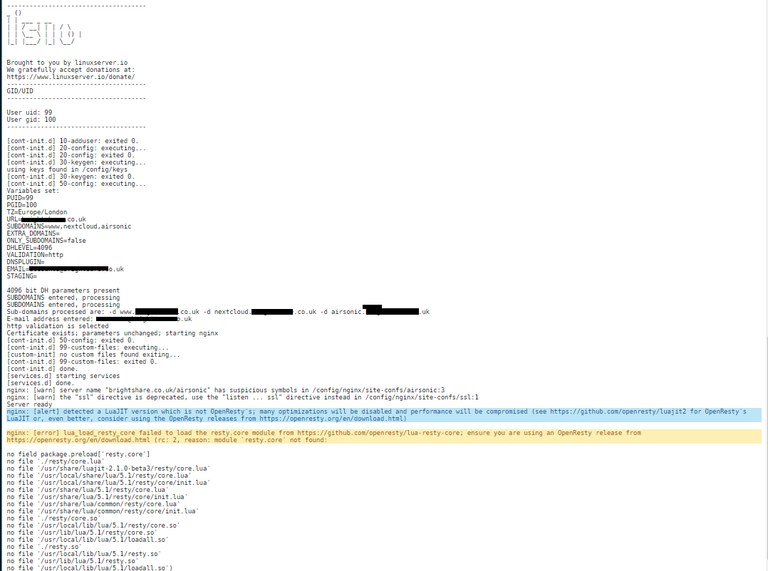

July 20, 20197 yr 2 hours ago, Chandler said: Alright, I've been reading through this forum getting all the answers to my problems so far. I was able to figure it out and get everything in a working state. I just have just a few questions now -- On startup I see the alert about the LuaJIT version issue, is that a problem? I also see the warnings for conflicting server names. How do I fix that? I have only used the default templates and only edited them where necessary. Certificate exists; parameters unchanged; starting nginx [cont-init.d] 50-config: exited 0. [cont-init.d] 99-custom-files: executing... [custom-init] no custom files found exiting... [cont-init.d] 99-custom-files: exited 0. [cont-init.d] done. [services.d] starting services [services.d] done. nginx: [alert] detected a LuaJIT version which is not OpenResty's; many optimizations will be disabled and performance will be compromised (see https://github.com/openresty/luajit2 for OpenResty's LuaJIT or, even better, consider using the OpenResty releases from https://openresty.org/en/download.html) nginx: [error] lua_load_resty_core failed to load the resty.core module from https://github.com/openresty/lua-resty-core; ensure you are using an OpenResty release from https://openresty.org/en/download.html (rc: 2, reason: module 'resty.core' not found: no field package.preload['resty.core'] no file './resty/core.lua' no file '/usr/share/luajit-2.1.0-beta3/resty/core.lua' no file '/usr/local/share/lua/5.1/resty/core.lua' no file '/usr/local/share/lua/5.1/resty/core/init.lua' no file '/usr/share/lua/5.1/resty/core.lua' no file '/usr/share/lua/5.1/resty/core/init.lua' no file '/usr/share/lua/common/resty/core.lua' no file '/usr/share/lua/common/resty/core/init.lua' no file './resty/core.so' no file '/usr/local/lib/lua/5.1/resty/core.so' no file '/usr/lib/lua/5.1/resty/core.so' no file '/usr/local/lib/lua/5.1/loadall.so' no file './resty.so' no file '/usr/local/lib/lua/5.1/resty.so' no file '/usr/lib/lua/5.1/resty.so' no file '/usr/local/lib/lua/5.1/loadall.so') nginx: [warn] conflicting server name "ombi.*" on 0.0.0.0:443, ignored nginx: [warn] conflicting server name "sl.*" on 0.0.0.0:443, ignored nginx: [warn] conflicting server name "tautulli.*" on 0.0.0.0:443, ignored nginx: [warn] conflicting server name "ombi.*" on [::]:443, ignored nginx: [warn] conflicting server name "sl.*" on [::]:443, ignored nginx: [warn] conflicting server name "tautulli.*" on [::]:443, ignored Server ready In my default site config I enable the http redirect to https server { listen 80; listen [::]:80; server_name _; return 301 https://$host$request_uri; } This works for all dockers except for Tautulli. When I go to the http for that I get page not found, any ideas? Lua issues are harmless. Server name conflicts are a problem you need to fix. You likely have duplicate site configs
July 20, 20197 yr 16 minutes ago, aptalca said: Lua issues are harmless. Server name conflicts are a problem you need to fix. You likely have duplicate site configs Ok I fixed the name conflicts. Accidentally included subdomains.conf twice in the default. Any idea on the Tautulli not redirecting to https when attempting to reach from http?

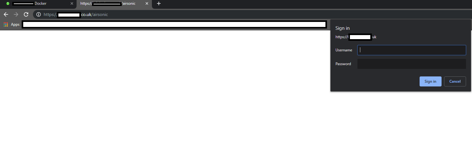

July 20, 20197 yr 1 hour ago, Greygoose said: unable to access the airsonic from web browser via Your confs don't match your logs. The web address you're trying to connect to has http auth turned on. It looks like you have a conf somewhere that has an incorrect server name set (with /airsonic at the end), etc. Either go back to defaults and start over, it post your full config or it is impossible for us to help you

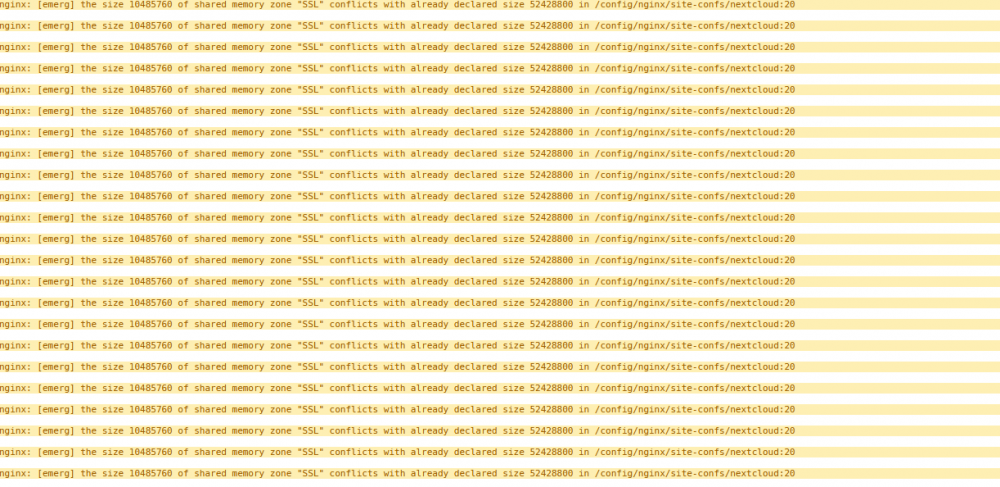

July 20, 20197 yr Hi Sarrg, I have tried this using the airconic, domain sample. I renamed it to airsonic and copied into the nginx/site-confs folder # make sure that your dns has a cname set for airsonic and that your airsonic container is not using a base url server { listen 443 ssl; listen [::]:443 ssl; server_name airsonic.domain.co.uk*; include /config/nginx/ssl.conf; client_max_body_size 0; # enable for ldap auth, fill in ldap details in ldap.conf #include /config/nginx/ldap.conf; location / { # enable the next two lines for http auth #auth_basic "Restricted"; #auth_basic_user_file /config/nginx/.htpasswd; # enable the next two lines for ldap auth #auth_request /auth; #error_page 401 =200 /login; include /config/nginx/proxy.conf; resolver 127.0.0.11 valid=30s; set $upstream_airsonic airsonic; proxy_pass http://192.168.1.100:4040; } } }

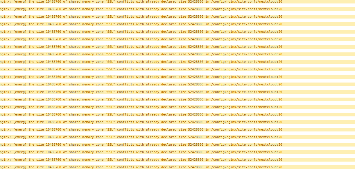

July 20, 20197 yr So i renamed the subdomain conf file to airsonic and copyed into the site-confs folder, still getting the issue above. # make sure that your dns has a cname set for airsonic and that your airsonic container is not using a base url server { listen 443 ssl; listen [::]:443 ssl; server_name airsonic.*; include /config/nginx/ssl.conf; client_max_body_size 0; # enable for ldap auth, fill in ldap details in ldap.conf #include /config/nginx/ldap.conf; location / { # enable the next two lines for http auth #auth_basic "Restricted"; #auth_basic_user_file /config/nginx/.htpasswd; # enable the next two lines for ldap auth #auth_request /auth; #error_page 401 =200 /login; include /config/nginx/proxy.conf; resolver 127.0.0.11 valid=30s; set $upstream_airsonic airsonic; proxy_pass http://$upstream_airsonic:4040; } }
July 20, 20197 yr when i remove the airsonic file from the site-confs folder then nextcloud works fine without any issues. I'm lost. 4hrs into this now

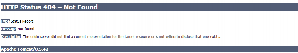

July 20, 20197 yr PROGRESS I deleted the letsencrypt docker & folder. I started fresh with spaceinvader one guide. 10minutes later things look much better,. however I now get this error, its getting the airsonic docker via the domain but this error below
July 21, 20197 yr 2 hours ago, Greygoose said: PROGRESS I deleted the letsencrypt docker & folder. I started fresh with spaceinvader one guide. 10minutes later things look much better,. however I now get this error, its getting the airsonic docker via the domain but this error below You don't move the files. You just remove the sample part from the file. And also read the top of the file to check if you have to make any changes.
July 21, 20197 yr You're only supposed to rename the files, not move them to different folders. Documentation is pretty clear on that.
July 21, 20197 yr guys, sorry for wasting your time. all sorted now. I also changed the context path in the airsonic docker to work using airsonic.domain instead of the airsonic.domain/airsonic I was making things way too complex, you guys did all the work. Thank you, thnak you for now loosing it with me

July 22, 20197 yr On 7/19/2019 at 8:02 PM, aptalca said: I believe you need to change the remote port shown on there Weird, that column is in the stock image but not on my actual router. I did try the remote port settings but I must have done it wrong initially because I tried it just now and it worked. Hopefully I can manage from here. Thanks for the help, I know I wasn't making things easy but I just really needed another set of eyes because I haven't been able to keep things straight lately.
