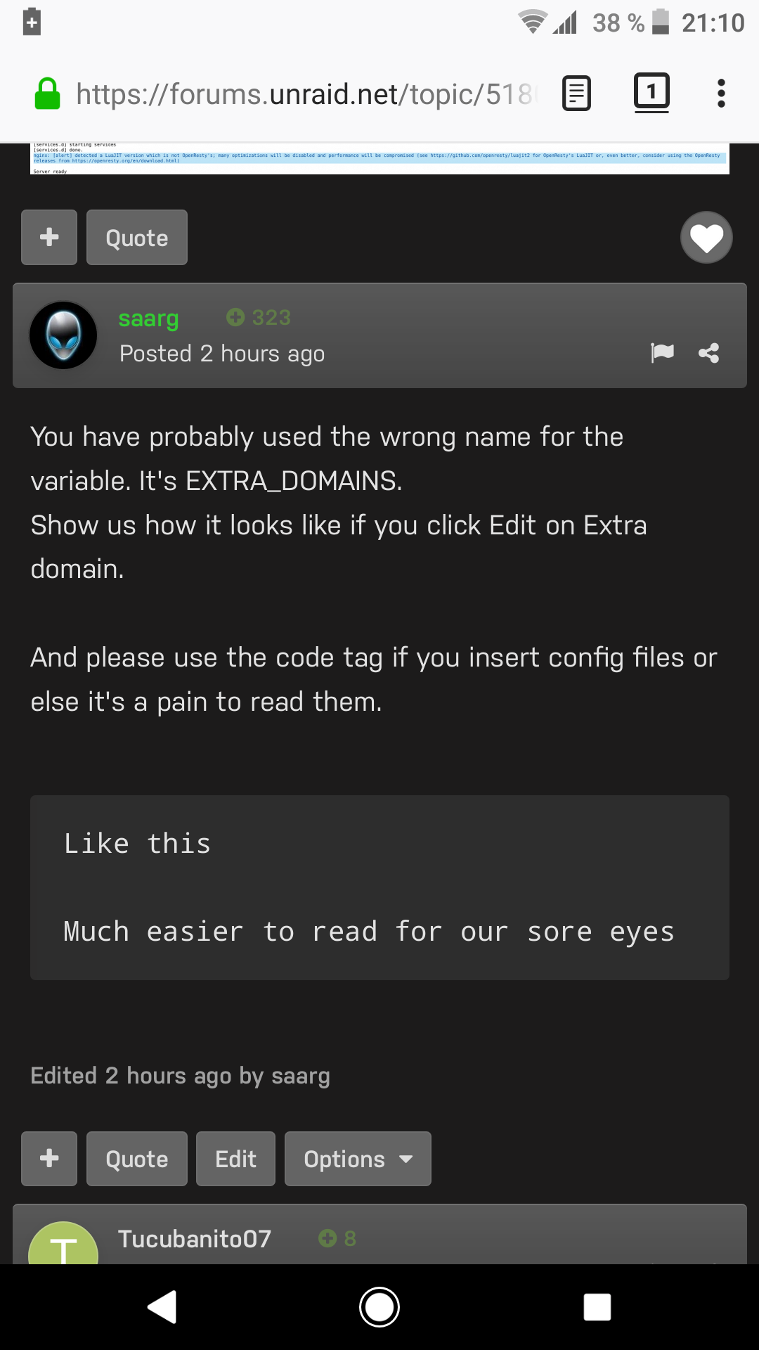

You have probably used the wrong name for the variable. It's EXTRA_DOMAINS.
Show us how it looks like if you click Edit on Extra domain.
And please use the code tag if you insert config files or else it's a pain to read them.
Like this
Much easier to read for our sore eyes
Edited by saarg

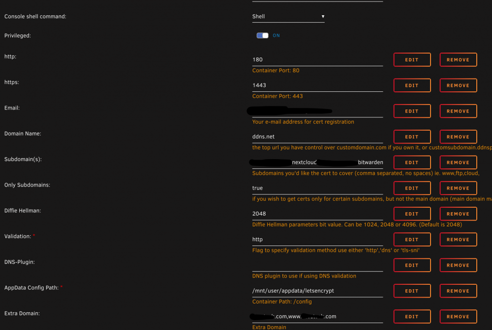

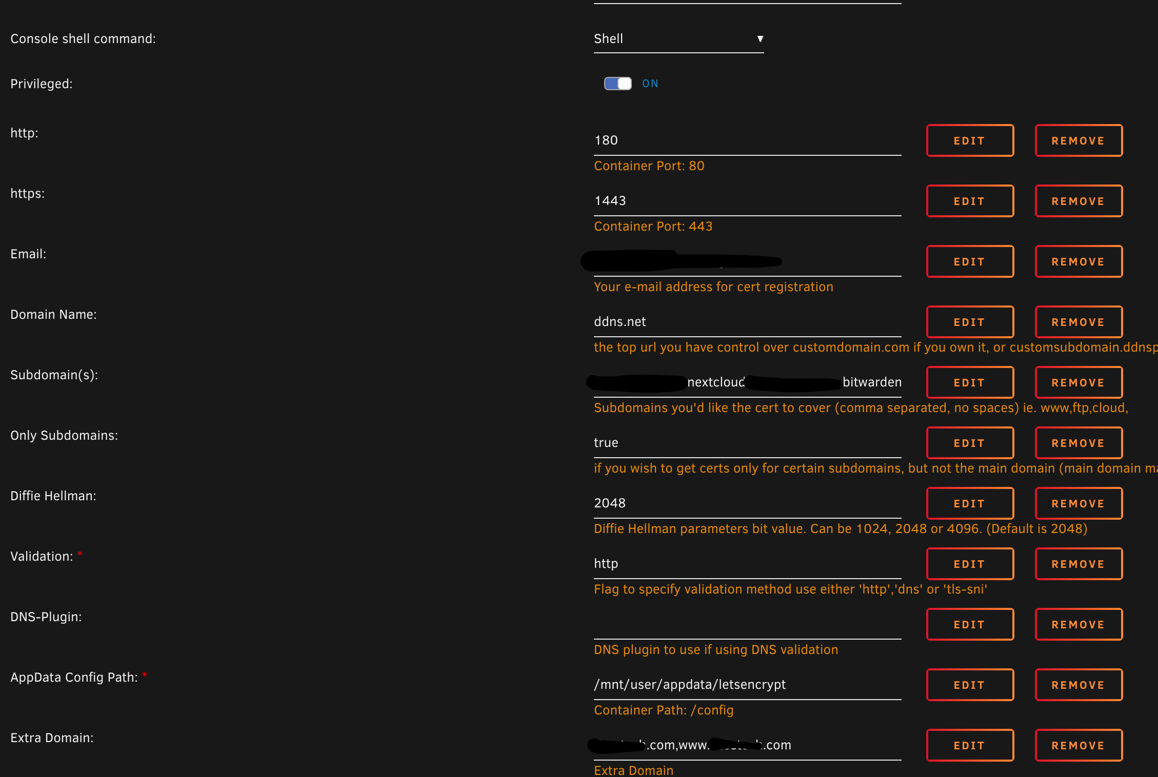

Like this
Ok so i was missing the S in EXTRA_DOMAINS i had EXTRA_DOMAIN. I do see that my domain on the logs does not have an error. Before i was doing domainname.com,www.domainname.com. The www.domainname.com was the one throwing an error. I delete it. Now i have been trying other configs like the ones above and grrr.

Don't we already have a wordpress proxy-conf?

3 minutes ago, Tucubanito07 said:
I don't see in under proxy-conf. That is where i looked first before asking and i don't see anything. What do you mean by putting a config in a code tag?
Look a couple of posts up. I already asked you to do it there.
I thought we had one, but no we don't have a proxy-conf for it.
Link to comment
5 minutes ago, saarg said:
I have already resolve the problem with not getting the certificate. I only need to point the NGINX to the wordpress domain so people can see the site. I know on nextcloud they have a config file we have to change to connect to reverse proxy. However, i dont see a config file in wordpress.
Link to comment

You have way too many modifications there. Either contact the author of the guide you used, or use our guide here: https://blog.linuxserver.io/2019/04/25/letsencrypt-nginx-starter-guide/
