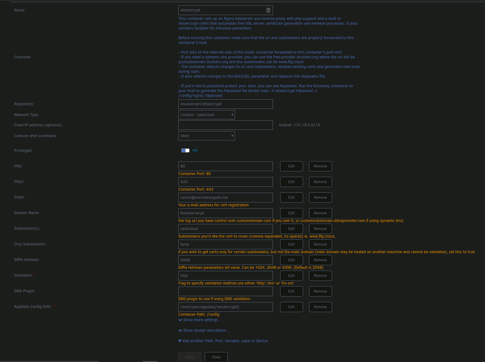

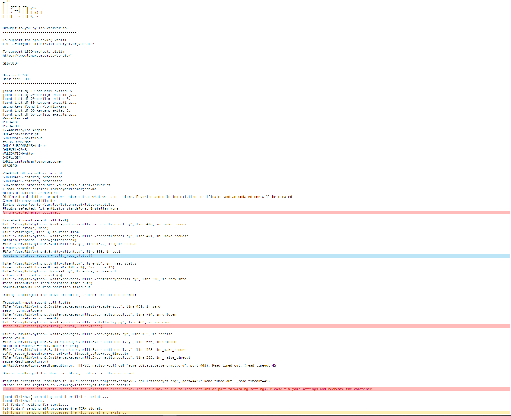

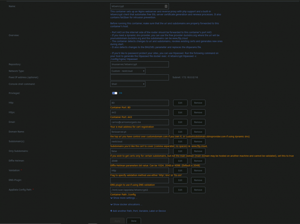

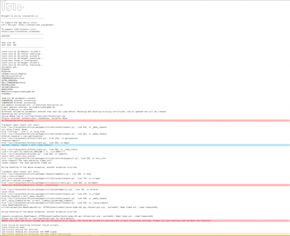

5 hours ago, carlosmorgado said:
Hey guys I've been trying to get this to work, but was not sucssefull.
I have the following log:image.thumb.png.1ca81911c5cc0363bbc6f35ce9ac8c5c.png
And the following config: image.thumb.png.b12e93e015dc7e021f52ed4fab9eadc5.png
Hope you guys can help
You have networking or dns issues. The container cannot reach out to letsencrypt servers. Check your dns, turn off pihole or whatever else blocker you may be using.

3 hours ago, carlosmorgado said:
Yes, I just configured those ports on other services on unraid (for test purposes) and was able to access them from outside the network, using the domain I configured.
Your issues are with "outgoing" connections, not incoming. That's why I suggested dns

10 hours ago, carlosmorgado said:
So I entered the console of the container and tested the following (this url was the one mentioned in the logs):
root@168ecbf2d373:/# curl acme-v02.api.letsencrypt.org 443
<html>
<head><title>301 Moved Permanently</title></head>
<body>
<center><h1>301 Moved Permanently</h1></center>
<hr><center>nginx</center>
</body>
</html>
curl: (7) Couldn't connect to server
You need to tell curl to follow redirects
