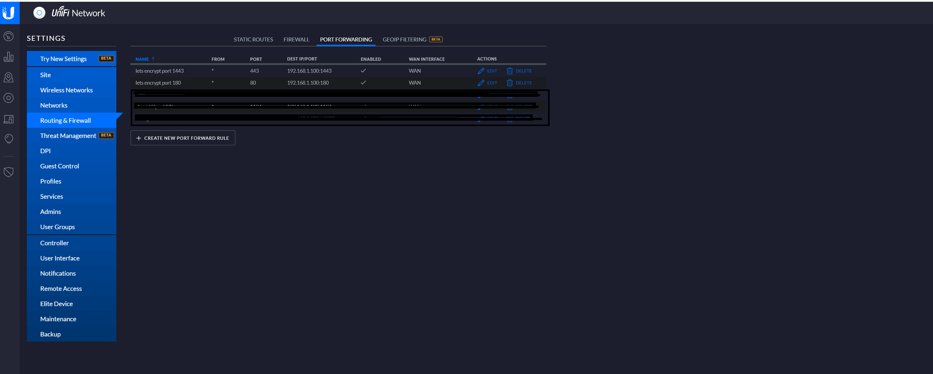

8 hours ago, Alphacosmos said:
Hey All,
Having an Issue....not sure why im getting this fail.  Pretty sure my ports are right. what is :/mnt/mtd/WebSites/.well and where and how do i fix this :s

Thanks for the troubleshooting guide. I gave it a go but it seems my ports are configured correctly. when i ran the Nginx docker with worked fine. It must be something to do with the the file it cant locate. I have tried removing lets encrypt and retrying a few times. Same error
When I try to connect to your domain, I get a blank yellow/green page with "webcam" as the page title.
Are you sure you did the test correctly as described?

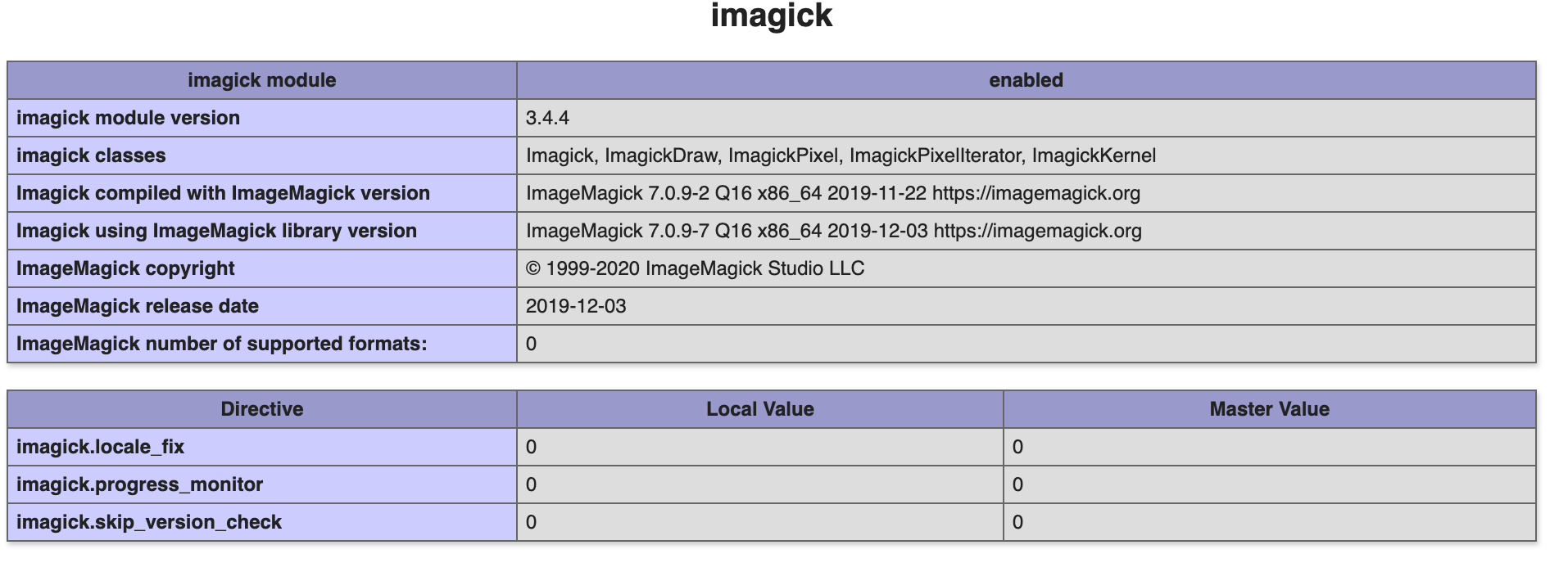

I'm having an issue on wordpress and it's erroring regarding Imagick; ImagickException thrown – NoDecodeDelegateForThisImageFormat `JPEG’.
I'v checked on phpinfo and it shows "ImageMagick number of supported formats:0" Any idea how i could fix this? Or is this part of the docker build that needs fixing?
