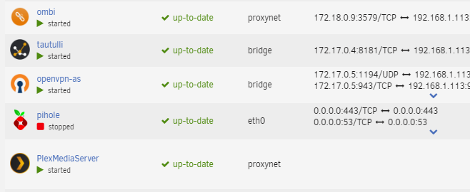

Hello alli am currently going crazy, I am currently trying to reverse proxy plex using my own domain with letsencrypt and cant seem to get this working. Can someone tell me where i am going wrong ?, i have the address set in the plexmediaserver docker as https://mydomain.org and have created a CNAME for it. Here is my current config
server {
    listen 443 ssl;
    listen [::]:443 ssl;
    server_name plexh.*;
    include /config/nginx/ssl.conf;
    client_max_body_size 0;
    proxy_redirect off;
    proxy_buffering off;
    # enable for ldap auth, fill in ldap details in ldap.conf
    #include /config/nginx/ldap.conf;
    location / {
        # enable the next two lines for http auth
        #auth_basic "Restricted";
        #auth_basic_user_file /config/nginx/.htpasswd;
        # enable the next two lines for ldap auth
        #auth_request /auth;
        #error_page 401 =200 /login;
        include /config/nginx/proxy.conf;
        resolver 127.0.0.11 valid=30s;
        set $upstream_app PlexMediaServer;
        set $upstream_port 32400;
        set $upstream_proto http;
        proxy_pass $upstream_proto://$upstream_app:$upstream_port;
        proxy_set_header Upgrade $http_upgrade;
        proxy_set_header Connection "upgrade";
        proxy_set_header X-Plex-Client-Identifier $http_x_plex_client_identifier;
        proxy_set_header X-Plex-Device $http_x_plex_device;
        proxy_set_header X-Plex-Device-Name $http_x_plex_device_name;
        proxy_set_header X-Plex-Platform $http_x_plex_platform;
        proxy_set_header X-Plex-Platform-Version $http_x_plex_platform_version;
        proxy_set_header X-Plex-Product $http_x_plex_product;
        proxy_set_header X-Plex-Token $http_x_plex_token;
        proxy_set_header X-Plex-Version $http_x_plex_version;
        proxy_set_header X-Plex-Nocache $http_x_plex_nocache;
        proxy_set_header X-Plex-Provides $http_x_plex_provides;
        proxy_set_header X-Plex-Device-Vendor $http_x_plex_device_vendor;
        proxy_set_header X-Plex-Model $http_x_plex_model;
i am using dns verication with wildcard
@Sinister upstream doesnt allow upper cases ... looks like u use the official plex docker and not the lsio one, change to the ip and u should be fine.
also your listening domain name is plexh.* ? if thats correct, ok
yes i am now able to reach plex via my domain name but now i cant reach it locally through unraid GUI via the WEBUI option when you click the docker. Any idea how to fix that ? also docker is not showing any IP address info like other dockers on proxynet custom network
