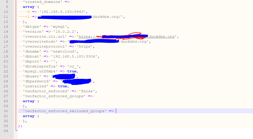

having issues getting nextcloud to work, I only care about nextcloud no other dockers, Any help would be amazing!
So I half found the issue. Not sure how to resolve though.
This gets the error saying it needs to be setup yet.
However if I alter the URL, Then it works fine. How can I have it where the URL is actually correct?
https://mydomainname.duckdns.org/index.php/login
Edited by scubieman
Nextcloud should be available at a subdomain like https://nextcloud.yoursubdomain.duckdns.org
How did you try to set it up?
What information do you need? I followed space invaders video. I guess I did something wrong.
How you set it up.
"I followed X video or guide" is not the least bit helpful.
Like I said, you should be accessing it at the nextcloud subdomain, not the main url. Either you're not using the right address, or you set it up very differently than we suggest.
