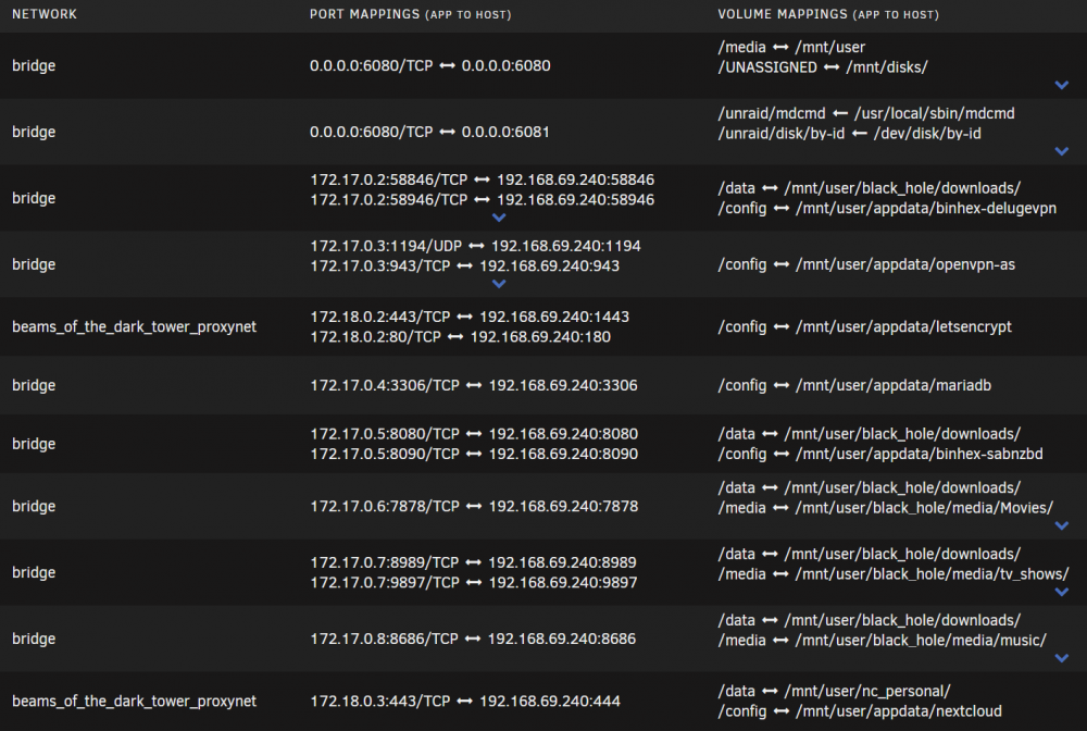

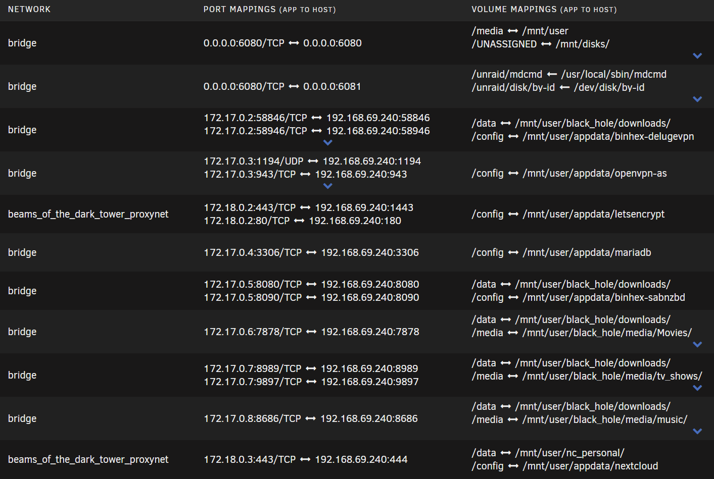

5 minutes ago, TechMed said:
BTW... any chance you could shed any light on my question?
Do all your containers use the same IP?
Edit: just realized I inserted my image over the text
@jonathanm as directed LE and NC are on the self-created proxy network. However, they are all on the same IP which is that of the server. Is that what you mean?
Edited by TechMed

4 hours ago, JoHimself said:
Hi guys, I'm having issues with this container. I have my domain set up, it has been for a while since this was working until I changed one of the subdomains so it had to re-generate the certificate. The validation fails using http challenge.
I have tried removing the container and appdata and even that does not rectify the issue. If I fire up an NGINX container with the default config then it shows the NGINX startup page by going to the domain. When I use this container with the same port forwarding there doesn't seem to be anything listening.

When you put up the nginx container, are you trying the http endpoint? From outside of the lan?
Yes. Also, when NGINX is up the site https://letsdebug.net/ reports everything is fine, this is not the case using letsencrypt
I'm reading your responses to previous posts, you say that nginx isn't running until it get's a cert so what is supposed to be providing the HTTP response?
Edited by JoHimself
further questions
