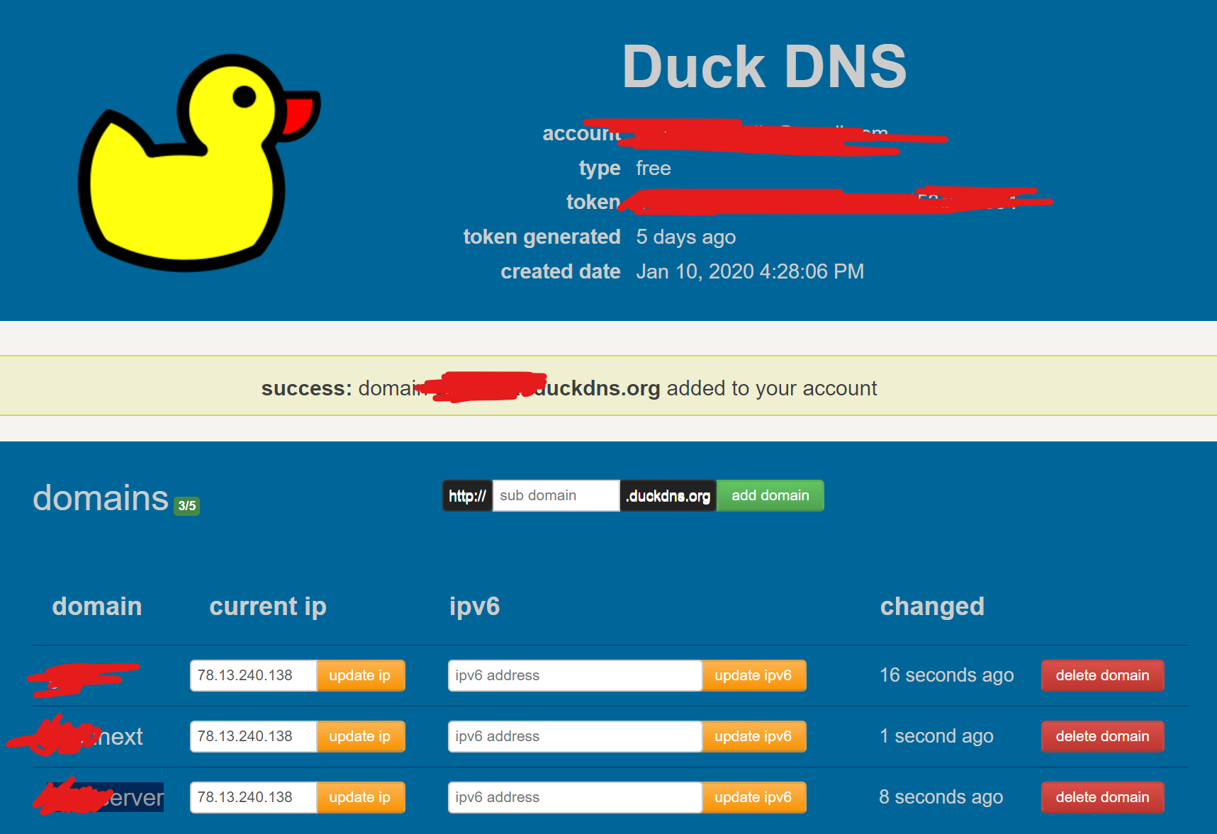

January 14, 20206 yr 29 minutes ago, aptalca said: That ip is what letsencrypt is getting for your domain name. Check your dns settings if that is not your public ip most definitely not what duck DNS is pointing to...if I enter the url that I'm redirecting to duck DNS without port forwarding on and the firewall letting the connection through I get to my routers login page. It's the only reason I'm still working under the assumption that this is a router or docker config issue. If we think duck DNS is the issue, I can just redirect to my ip from my domain. and worry about updating it when/if it changes. I

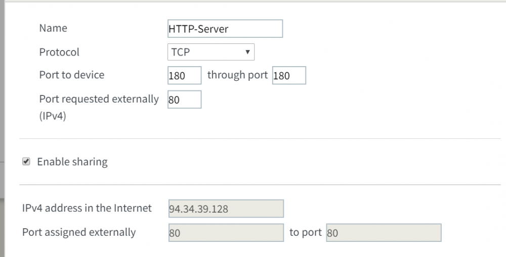

January 15, 20206 yr I'm having trouble setting up letsencrypt. Like many people here I've learned about this in the spaceinvaderone video about nextcloud. The error is ERROR: Cert does not exist! Please see the validation error above. The issue may be due to incorrect dns or port forwarding settings. Please fix your settings and recreate the container The whole log is User uid: 99 User gid: 100 ------------------------------------- [cont-init.d] 10-adduser: exited 0. [cont-init.d] 20-config: executing... [cont-init.d] 20-config: exited 0. [cont-init.d] 30-keygen: executing... using keys found in /config/keys [cont-init.d] 30-keygen: exited 0. [cont-init.d] 50-config: executing... Variables set: PUID=99 PGID=100 TZ=Europe/Berlin URL=duckdns.org SUBDOMAINS=xxx,yyy,zzz EXTRA_DOMAINS= ONLY_SUBDOMAINS=true DHLEVEL=2048 VALIDATION=http DNSPLUGIN= EMAIL=***@gmail.com STAGING= 2048 bit DH parameters present SUBDOMAINS entered, processing SUBDOMAINS entered, processing Only subdomains, no URL in cert Sub-domains processed are: -d xxx.duckdns.org -d zzz.duckdns.org -d yyy.duckdns.org E-mail address entered: ***@gmail.com http validation is selected Generating new certificate Saving debug log to /var/log/letsencrypt/letsencrypt.log Plugins selected: Authenticator standalone, Installer None Renewing an existing certificate IMPORTANT NOTES: - Congratulations! Your certificate and chain have been saved at: /etc/letsencrypt/live/zzz.duckdns.org/fullchain.pem Your key file has been saved at: /etc/letsencrypt/live/zzz.duckdns.org/privkey.pem Your cert will expire on 2020-04-14. To obtain a new or tweaked version of this certificate in the future, simply run certbot again. To non-interactively renew *all* of your certificates, run "certbot renew" - If you like Certbot, please consider supporting our work by: Donating to ISRG / Let's Encrypt: https://letsencrypt.org/donate Donating to EFF: https://eff.org/donate-le Now, the dns should be configured correctly yet when trying to access it from remote it doesn't load anything, it doesn't matter if the ports are open or closed. I also have a dyndns account, configured in the settings of the router (a crappy zyxel) - from there when portforwarding I can also access the webui from remote, but for obvious reasons I don't want that, so I'm using duckdns. I don't know if this is the problem. This is the portforwarding page on my router. As you can see, as the noob I am, I wasn't sure if I needed to open the internal (translation ports) or external port (start-end ports), so I alternatively tried both configuration. Obviously I got the same results for both attempts. I also created a duckdns container as specified in the video (which is this one, minute 10 starts to talk about the portforwarding) I honestly don't know how to deal with this, so I hope there's someone willing to suggest me some troubleshooting techniques.
January 15, 20206 yr 2 hours ago, anongum said: I'm having trouble setting up letsencrypt. Like many people here I've learned about this in the spaceinvaderone video about nextcloud. The error is ERROR: Cert does not exist! Please see the validation error above. The issue may be due to incorrect dns or port forwarding settings. Please fix your settings and recreate the container The whole log is User uid: 99 User gid: 100 ------------------------------------- [cont-init.d] 10-adduser: exited 0. [cont-init.d] 20-config: executing... [cont-init.d] 20-config: exited 0. [cont-init.d] 30-keygen: executing... using keys found in /config/keys [cont-init.d] 30-keygen: exited 0. [cont-init.d] 50-config: executing... Variables set: PUID=99 PGID=100 TZ=Europe/Berlin URL=duckdns.org SUBDOMAINS=xxx,yyy,zzz EXTRA_DOMAINS= ONLY_SUBDOMAINS=true DHLEVEL=2048 VALIDATION=http DNSPLUGIN= EMAIL=***@gmail.com STAGING= 2048 bit DH parameters present SUBDOMAINS entered, processing SUBDOMAINS entered, processing Only subdomains, no URL in cert Sub-domains processed are: -d xxx.duckdns.org -d zzz.duckdns.org -d yyy.duckdns.org E-mail address entered: ***@gmail.com http validation is selected Generating new certificate Saving debug log to /var/log/letsencrypt/letsencrypt.log Plugins selected: Authenticator standalone, Installer None Renewing an existing certificate IMPORTANT NOTES: - Congratulations! Your certificate and chain have been saved at: /etc/letsencrypt/live/zzz.duckdns.org/fullchain.pem Your key file has been saved at: /etc/letsencrypt/live/zzz.duckdns.org/privkey.pem Your cert will expire on 2020-04-14. To obtain a new or tweaked version of this certificate in the future, simply run certbot again. To non-interactively renew *all* of your certificates, run "certbot renew" - If you like Certbot, please consider supporting our work by: Donating to ISRG / Let's Encrypt: https://letsencrypt.org/donate Donating to EFF: https://eff.org/donate-le Now, the dns should be configured correctly yet when trying to access it from remote it doesn't load anything, it doesn't matter if the ports are open or closed. I also have a dyndns account, configured in the settings of the router (a crappy zyxel) - from there when portforwarding I can also access the webui from remote, but for obvious reasons I don't want that, so I'm using duckdns. I don't know if this is the problem. This is the portforwarding page on my router. As you can see, as the noob I am, I wasn't sure if I needed to open the internal (translation ports) or external port (start-end ports), so I alternatively tried both configuration. Obviously I got the same results for both attempts. I also created a duckdns container as specified in the video (which is this one, minute 10 starts to talk about the portforwarding) I honestly don't know how to deal with this, so I hope there's someone willing to suggest me some troubleshooting techniques. The error in the beginning of the post is not in the full log you posted. In the log it says the certificate was created. Without your docker run command its hard to say if your port forwarding is correct. What does not work?
January 16, 20206 yr 9 hours ago, anongum said: I'm having trouble setting up letsencrypt. Like many people here I've learned about this in the spaceinvaderone video about nextcloud. The error is ERROR: Cert does not exist! Please see the validation error above. The issue may be due to incorrect dns or port forwarding settings. Please fix your settings and recreate the container The whole log is User uid: 99 User gid: 100 ------------------------------------- [cont-init.d] 10-adduser: exited 0. [cont-init.d] 20-config: executing... [cont-init.d] 20-config: exited 0. [cont-init.d] 30-keygen: executing... using keys found in /config/keys [cont-init.d] 30-keygen: exited 0. [cont-init.d] 50-config: executing... Variables set: PUID=99 PGID=100 TZ=Europe/Berlin URL=duckdns.org SUBDOMAINS=xxx,yyy,zzz EXTRA_DOMAINS= ONLY_SUBDOMAINS=true DHLEVEL=2048 VALIDATION=http DNSPLUGIN= EMAIL=***@gmail.com STAGING= 2048 bit DH parameters present SUBDOMAINS entered, processing SUBDOMAINS entered, processing Only subdomains, no URL in cert Sub-domains processed are: -d xxx.duckdns.org -d zzz.duckdns.org -d yyy.duckdns.org E-mail address entered: ***@gmail.com http validation is selected Generating new certificate Saving debug log to /var/log/letsencrypt/letsencrypt.log Plugins selected: Authenticator standalone, Installer None Renewing an existing certificate IMPORTANT NOTES: - Congratulations! Your certificate and chain have been saved at: /etc/letsencrypt/live/zzz.duckdns.org/fullchain.pem Your key file has been saved at: /etc/letsencrypt/live/zzz.duckdns.org/privkey.pem Your cert will expire on 2020-04-14. To obtain a new or tweaked version of this certificate in the future, simply run certbot again. To non-interactively renew *all* of your certificates, run "certbot renew" - If you like Certbot, please consider supporting our work by: Donating to ISRG / Let's Encrypt: https://letsencrypt.org/donate Donating to EFF: https://eff.org/donate-le Now, the dns should be configured correctly yet when trying to access it from remote it doesn't load anything, it doesn't matter if the ports are open or closed. I also have a dyndns account, configured in the settings of the router (a crappy zyxel) - from there when portforwarding I can also access the webui from remote, but for obvious reasons I don't want that, so I'm using duckdns. I don't know if this is the problem. This is the portforwarding page on my router. As you can see, as the noob I am, I wasn't sure if I needed to open the internal (translation ports) or external port (start-end ports), so I alternatively tried both configuration. Obviously I got the same results for both attempts. I also created a duckdns container as specified in the video (which is this one, minute 10 starts to talk about the portforwarding) I honestly don't know how to deal with this, so I hope there's someone willing to suggest me some troubleshooting techniques. https://blog.linuxserver.io/2019/07/10/troubleshooting-letsencrypt-image-port-mapping-and-forwarding/

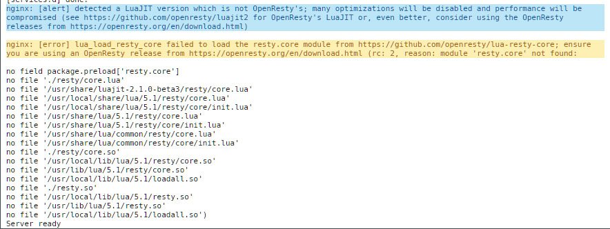

January 17, 20206 yr Literally just upgraded the container to the latest version and now cannot access any of the sites/servers on my unraid box. When I look at my logs I am getting the error message shown below: Thanks for any help, Jason

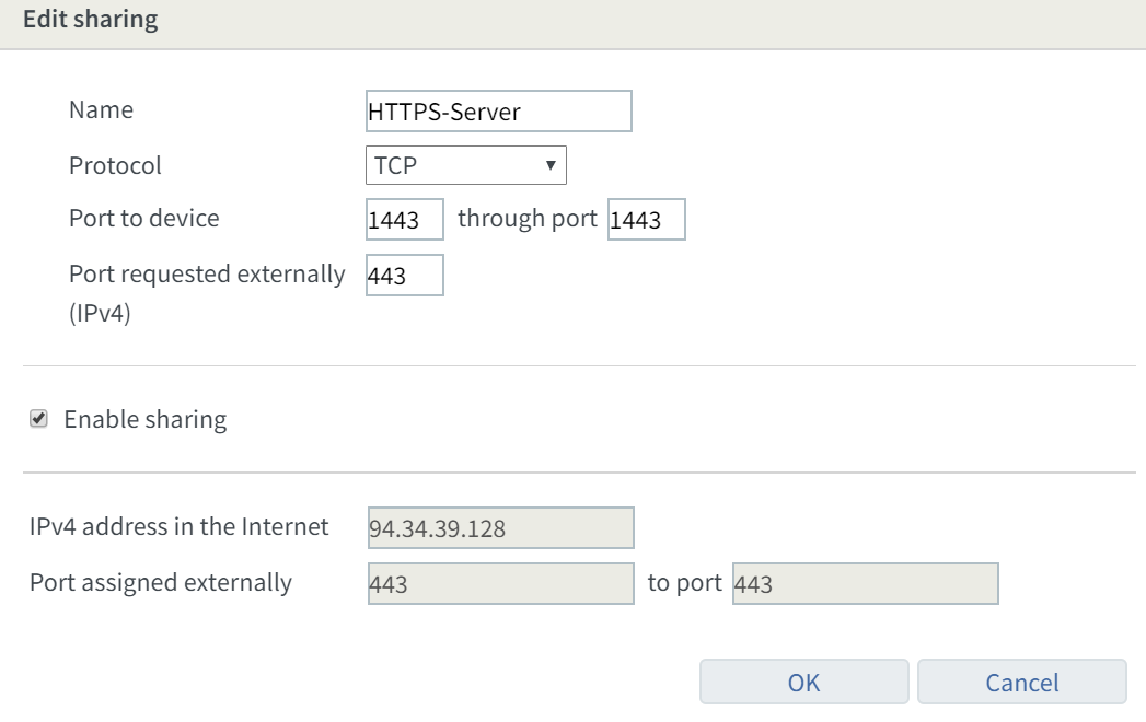

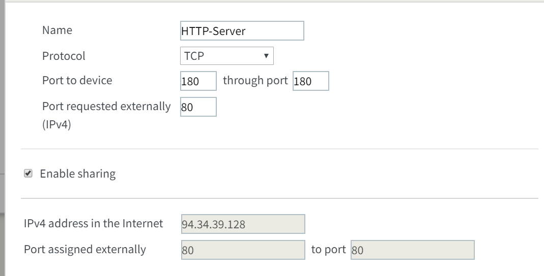

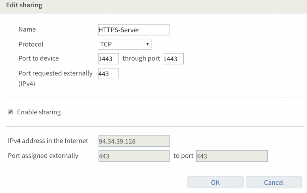

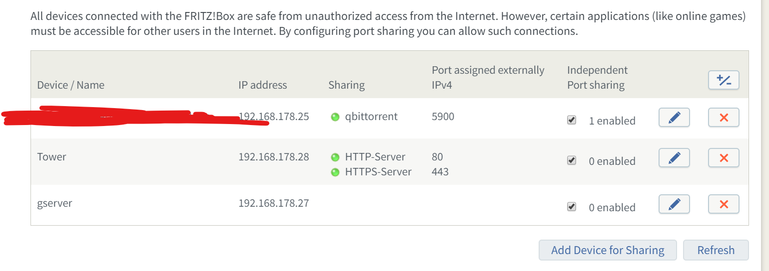

January 17, 20206 yr On 1/15/2020 at 9:34 PM, saarg said: What does not work? On 1/16/2020 at 4:46 AM, aptalca said: https://blog.linuxserver.io/2019/07/10/troubleshooting-letsencrypt-image-port-mapping-and-forwarding/ I changed router. I'm using a fritzbox 5790 now, the ports are open but I can't get past this error. ERROR: Cert does not exist! Please see the validation error above. The issue may be due to incorrect dns or port forwarding settings. Please fix your settings and recreate the container Considering the screen I already provided in the previous posts too, what could the problem be?
January 17, 20206 yr 2 minutes ago, anongum said: I changed router. I'm using a fritzbox 5790 now, the ports are open but I can't get past this error. ERROR: Cert does not exist! Please see the validation error above. The issue may be due to incorrect dns or port forwarding settings. Please fix your settings and recreate the container Considering the screen I already provided in the previous posts too, what could the problem be? Please post full logs, not only the error. Earlier log you showed a cert was generated. You can use staging to test so you don't get rate limited. Did you read the blog post you linked? Have you tried setting up the nginx container to see if you can access it on port 80 remotely or if your isp blocks port 80?
January 18, 20206 yr 5 hours ago, jjthacker said: Literally just upgraded the container to the latest version and now cannot access any of the sites/servers on my unraid box. When I look at my logs I am getting the error message shown below: Thanks for any help, Jason It's been discussed to death. Harmless lua error. Unrelated. Server ready means nginx is up and running. Check your dns settings and port forwarding
January 18, 20206 yr 6 minutes ago, aptalca said: It's been discussed to death. Harmless lua error. Unrelated. Server ready means nginx is up and running. Check your dns settings and port forwarding Thanks for the advice. Turns out that the port forwarding on my router was screwed up when I changed the NIC in my server. Turns out it did port forwarding by MAC address not IP address.
January 18, 20206 yr 16 hours ago, jjthacker said: Thanks for the advice. Turns out that the port forwarding on my router was screwed up when I changed the NIC in my server. Turns out it did port forwarding by MAC address not IP address. Glad to hear you figured it out. And just an fyi, "Literally just upgraded the container to the latest version" often means "I changed a bunch of other things as well but I can't remember at the moment" 😉
