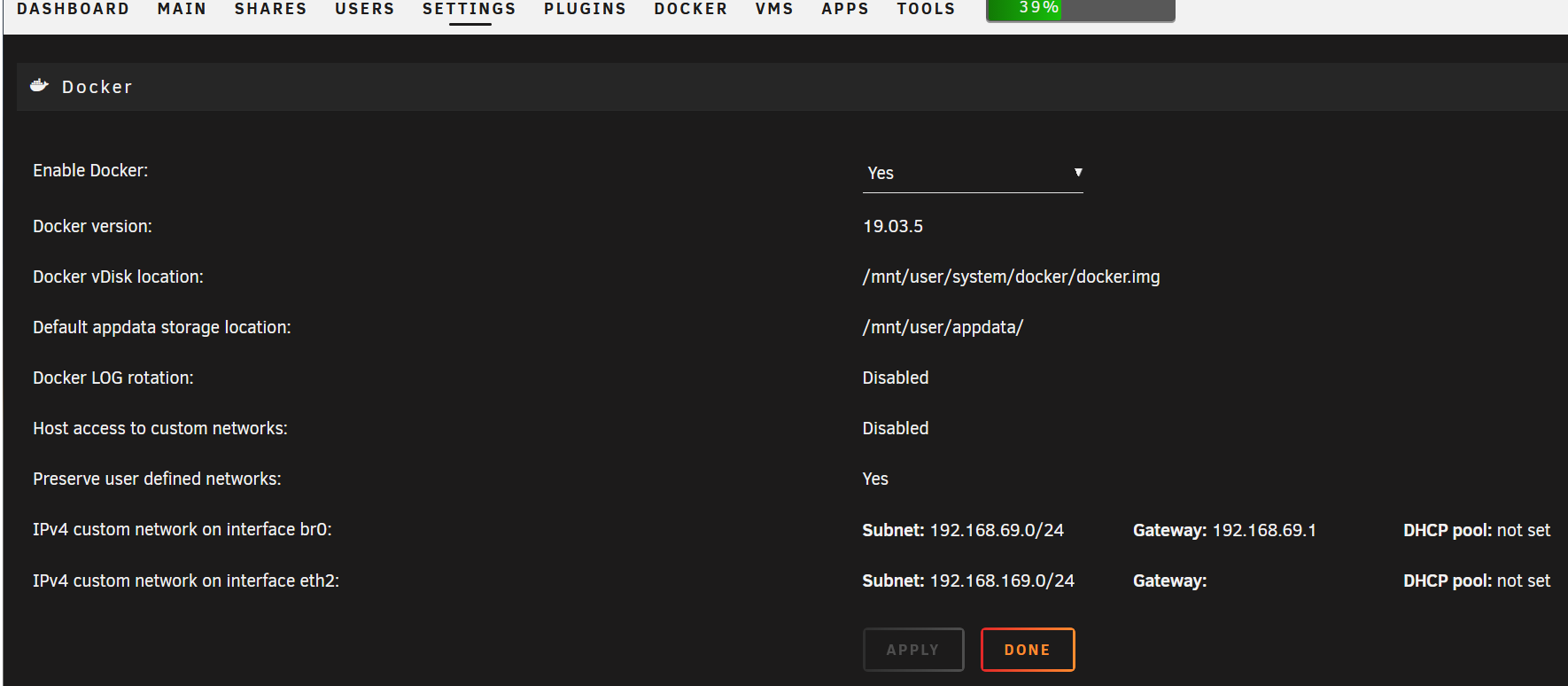

Hi All,
This may be a “duh” question, but I am trying to learn and not hose this box’s dialed in setup in the process. So, my question is, should I just change the ip addy/subnet for the LetsEncrypt (LE) container?
Background:
br0: 192.168.69.0/24
eth2: 192.168.169.0/24
I originally installed LE using the bonded (br0) interface which is working perfectly. I have since added a small 10Gb second subnet (eth2) which includes my servers and one desktop. When I have the desktop on the original br0 subnet, I can access anything behind the LE proxy as expected. When I switch the desktop over to the new eth2 subnet I can do everything BUT access anything behind the LE proxy.
Therefore, it seems to me that by simply changing the LE proxy’s subnet to that of the eth2 interface, I should be able to utilize my 10Gb interface on the desktop for everything, including those services behind the LE proxy. However, if I am overlooking a better way of doing this, I am open to suggestions and the ‘why’ so I understand for future needs and having the ability pay it forward. As a sample, here is info from the Nextcloud config.php file and the Docker network:

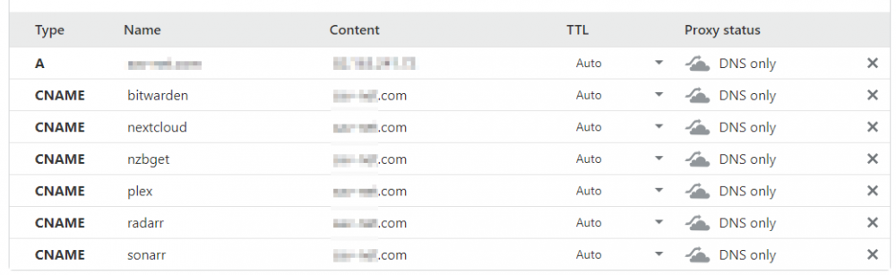

Hi all,
So I have this working but really want to get CloudFlare to work with Proxies.
I have it working without the Proxies, just as DNS and its working fine.
I have it set like so:
So A record to my WAN IP, then CNAME subdomains for each thing I want.
I also have LetsEncrypt set as DNS verification challenge and its working using wildcard.
I have ports forwarded from my router for 1443 and 180 and all good there too.
BUT my question is!
1) Can I remove said ports as its doing DNS verification or just the 180 (80) one?
2) Is there a way I can get the Proxy status to work, as every time I set it as Proxy I cannot access anything remotely?
Thanks

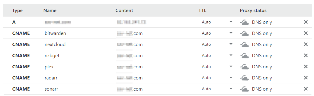

6 hours ago, SavellM said:
Hi all,
BUT my question is!
Thanks
If you're doing dns validation, you don't need port 80 mapping.
Can't help you with cloudflare proxy. I don't use it

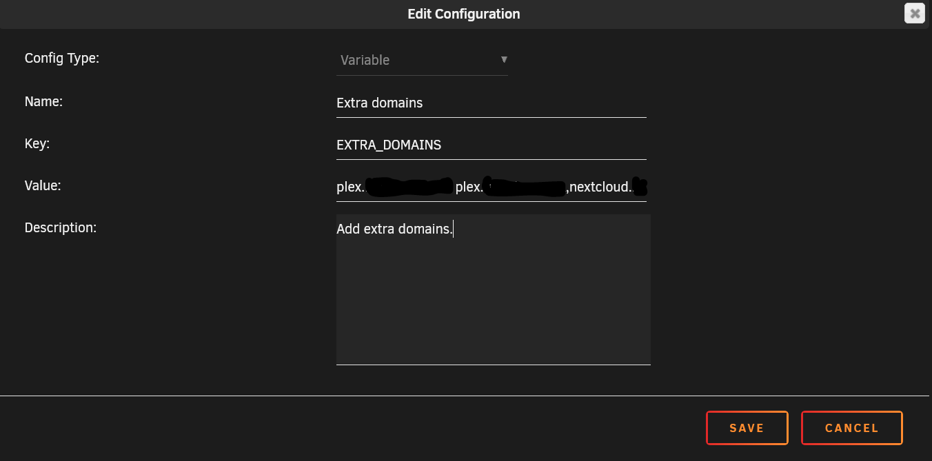

Would it be possible to run multiple instances of the letsencrypt container? All instances would have to have the same port mapping (i presume). Would this be possible by defining custom docker networks for each instance of letsencrypt and would http validation still work?
Thank you for the help!
Hi not sure why you would want multiple instances for let's encrypt. If you need to add extra domains just add an extra variable with the name Extra domains. As the value use EXTRA_DOMAINS and then in the key you can add extra domains note this has to be the full version you want so example.domain.com and not domain.com if you need even more add them with a comma like this example.domain.com,example2.domain.com,example3.domain.com etc...
So in my case I want to be able to reach my plex from 3 different domains I add one the normal way as top domain and with the sub domains. and the other two in the extra domains.
  Hope this helps!
