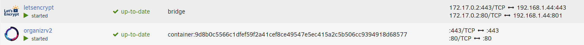

Hello, I had updated to Unraid 6.8 which broke the --network extra param I was using so after a bunch of looking around and digging I finally got it to work.. with most dockers. The issue I have ran into is getting it to work with dockers that have the same container ports. For example, right now I am trying to get it to work with OrganizrV2 which has port 80 and port 443 as its ports. The solution I found for getting it to work with other dockers was to, in the conf, instead of using the docker name I had to use the IP of the letsencrypt docker. If I try to point the Organizr with the letsencrypt IP I get endless redirects and it fails because letsencrypt is using port 80 and port 443. This does not give me any errors in the logs. So I tried putting the container name in the conf instead of the IP and I get an operation timed out:
2020/02/04 18:23:20 [error] 397#397: *3 organizrv2 could not be resolved (110: Operation timed out), client: 192.168.1.1, server: organizr.*, request: "GET / HTTP/2.0", host:
This is my conf for OrganizrV2:
server {
    listen 443 ssl;
    listen [::]:443 ssl;
	server_name organizr.*;
	include /config/nginx/ssl.conf;
	client_max_body_size 0;
 	location / {
		include /config/nginx/proxy.conf;
        resolver 127.0.0.11 valid=30s;
        set $upstream_organizr organizrv2;
        proxy_pass http://$upstream_organizr:80;
		proxy_buffering off;
On 2/2/2020 at 3:09 PM, phreeq said:

I tried
#root /config/www;
root /wwwroot;
and
root /mnt/user/wwwroot;
But it can't find either.  Something is mapping /config to a path and I guess it doesn't know where the real / is.
You need to post the docker run command so we can see which folder you are mapping. With the info you posted, we can only guess.
