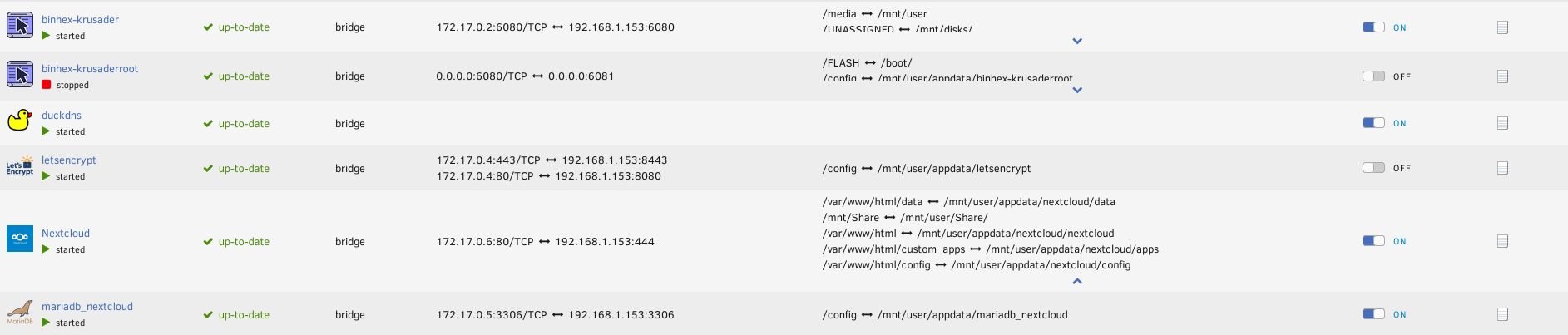

Guys, I'm at a complete loss here. On my Unraid server I've got a working nextcloud container plus a working letsencrypt container (for ports see screenshot). Nextcloud can be reached if I use the internal IP and over the subdomain bodenwiesli.duckdns.org I can reach the nginx server which tells me that the subdomain works and the port forwarding of the router is also active. But not matter what guide I follow (this one, this one or this one) it never works. I would really appreciate if someone could tell me how I need to configure the containers to get this working.
By the way for testing purposes I forwarded incoming requests to port 80 to the nextcloud container and was able to login to my nextcloud account so I'm 100 % positive that both the subdomain and the nextcloud container actually work. But I'm not ok with unencrypted traffic.
Edited by oeci
17 hours ago, kbbeer said:
Going down a rabbit hole this morning, curious if a solution exists to this problem. I've been using this container to allow access to one subdomain externally. I noticed today that if I go to my public ip (when remote) chrome prompts with a privacy error and gives the reason that this ip and the subdomain certs which I setup are different. Is it possible to configure so that my ip doesn't respond and you need to hit the subdomain for a response? Or is it best to create a cert for the main page to camouflage the subdomain?
You can set the main server block (the one that's defined as default) to serve a 404 or not even respond. So only the match for the subdomain will be displayed, any other request will go to the default block and get denied
Edited by aptalca
You're not using our nextcloud image
Ooops, changed to yours and indeed the reverse proxy seems to work. But now I cannot setup nextcloud, when I try to do so I can start the process (enter an admin account, choose database, set credentials for database) but it will always terminate with a 504 Gateway Time-Out message after a few minutes.

Today something weird happened to letsencrypt.
I had a clean installation of unraid, on docker just Plex, Nextcloud, Mariadb, duckdns and letsencrypt. Everything perfectly worked until this afternoon, when things just stopped working. Nextcloud and plex would kept working when trying to access them locally, but would timeout whenever trying to use the reverse proxy. So, since I'm far from being an expert user, and one time I already broke my docker containers by messing too much, I deleted my docker image, all my folders in appdata relative to docker containers, and just installed plex and letsencrypt, to see if the problem went away. But it still doesn't work - tried to change domain, issue new certificates - no luck.
Then I started thinking. For the sake of explaining I'll my plex domain plex.duckdns.org. I issued one certificate for this subdomain, but never actually used. Yet, for the sake of testing, I tried to access remotely my machine by typing plex.duckdns.org:32400, which is the port used by plex for its webgui, and it worked. I could access plex remotely just fine. Then I went, created a conf file in letsencrypt, which I'm posting:
# make sure that your dns has a cname set for plex
# if plex is running in bridge mode and the container is named "plex", the below config should work as is
# if not, replace the line "set $upstream_app plex;" with "set $upstream_app <containername>;"
# or "set $upstream_app <HOSTIP>;" for host mode, HOSTIP being the IP address of plex
# in plex server settings, under network, fill in "Custom server access URLs" with your domain (ie. "https://plex.yourdomain.url:443")
server {
    listen 443 ssl;
    listen [::]:443 ssl;

Changed the name from plex to the docker container name, so PlexMediaServer, obviously changed plex.* to the actual subdomain. And it worked! I shared the link with my friend, so that he could access my plex webgui remotely.
Everything was fine, but tonight everything is "time out" and I can't wrap my head around this.
The port forwarding is working fine. The certs are issued without issues, and the letsencrypt log looks normal, the server is up (Server ready, as end message of the log). Before tonight, when trying to access one of the domains for which I issued a certificate I would get a white and simple html page saying "Welcome to our server. The website is currently being setup under this address. For help and support, please contact: [email protected]", but now, no matter the certs I issued, everything would just time out.
Letsencrypt is in a custom "proxynet" network (yes, I too followed, or better bought unraid thanks to the spaceinvaderone tutorials) and the command is the same of when the reverse proxy worked. Since the port forwarding is fine, the plex container itself is fine, the problem is either duckdns or letsencrypt, tertium non datur.
What can I do to see what is the problem? I tried a minimal troubleshooting, but I'm not an expert user, and already disheartened at how could this even happen without touching the nas or any settings.
Please, help me.
Edited by anongum

A few things wrong here.
Using uppercase letters in container name will prevent nginx from properly resolving it. You'll get a 502
If you're trying to access https://url:32400, you're not going through reverse proxy as letsencrypt is accessed at port 443, not 32400. You are giving direct access to Plex via that port.
Start over and follow our guides: https://blog.linuxserver.io/2019/04/25/letsencrypt-nginx-starter-guide/
And for troubleshooting: https://blog.linuxserver.io/2019/07/10/troubleshooting-letsencrypt-image-port-mapping-and-forwarding/
