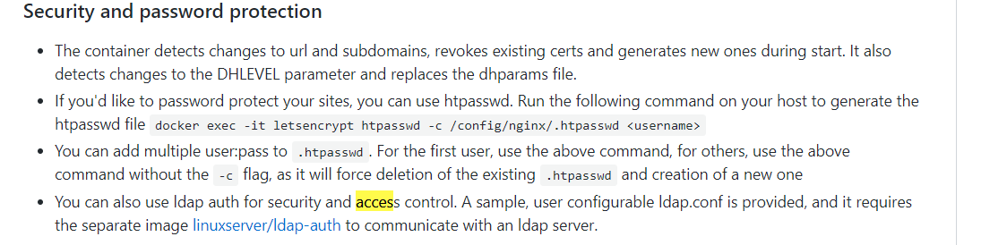

Hello,
I have created a .htacces in www and a .passwd in "/nginx/.htpasswd" but still it keeps letting me in without asking for username and password, what am I doing wrong? Thank you!
.htaccess:
AuthName "Restricted Area"
AuthType Basic
AuthUserFile /mnt/disks/Samsung_SSD_860_EVO_1TB_6Y3105056W/appdata/letsencrypt/nginx/.htpasswd
require valid-user
Edited by milfer322
Link to comment
6 hours ago, milfer322 said:
Hello,
.htaccess:
AuthType Basic
require valid-user
Read the instructions in the readme on how to use htpasswd

13 hours ago, milfer322 said:
I read it
But i dont see nothing about .htaccess.
I generated the htpasswd how as the readme file indicates.
That's the point I'm trying to make. We don't use .htaccess, that's an apache thing. Just create the htpasswd file as it says and uncomment the relevant auth lines in the confs
Link to comment
What files i need edit for the auth lines? I think the readme does not just explain all the necessary steps :(
Thanks for all.
Link to comment
Thanks for all.
Did you look at the config files?
https://github.com/linuxserver/docker-letsencrypt/blob/master/root/defaults/default#L43
https://github.com/linuxserver/reverse-proxy-confs/blob/master/bazarr.subdomain.conf.sample#L17
Edited by aptalca
