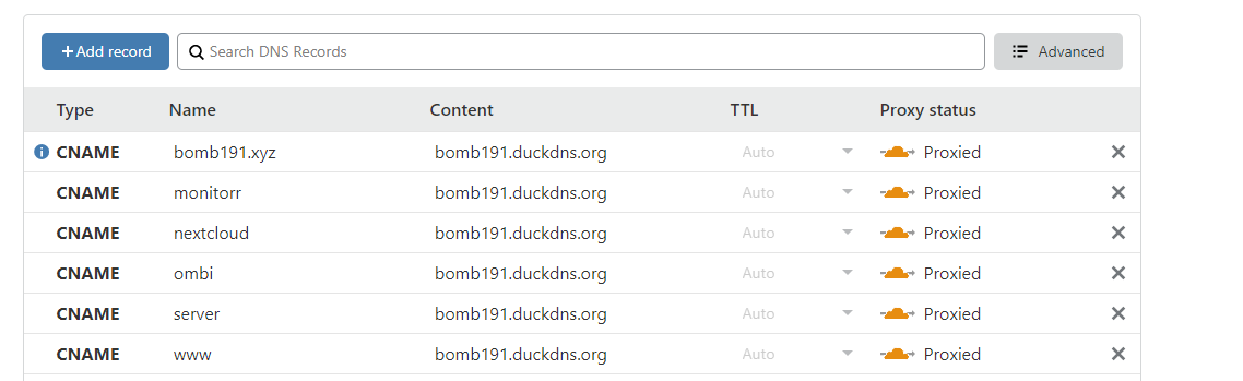

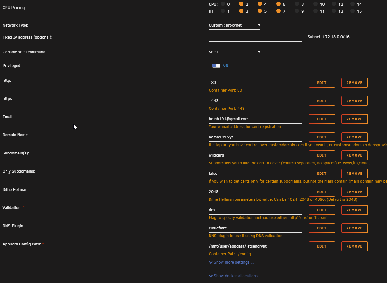

Ive been banging my head on this all day. I have my domains DNS linked up with cloudflare and cloudflare pointing to duckdns pointing to me.
Lets encrypt got its cert all fine and happy as.
I'm currently only trying to get ombi and nextcloud sorted out and have followed space invaders videos on lets encrypt and dns certs
What else do you guys need to help? it should just work but i only get 522 errors :(
I feel ipv6 might be screwing things up but i have ipv4 and 6 forwarded. I'm at a complete loss
2020-04-04 18_06_03-DNS _ bomb191.xyz _ Account _ Cloudflare - Web Performance & Security.png
Did you Google error 522? It tells you exactly what the problem is. Cloudflare can't reach your server. Check your port forwarding
https://blog.linuxserver.io/2019/07/10/troubleshooting-letsencrypt-image-port-mapping-and-forwarding/
  • Thanks 1
Link to comment
OMFG! ok so i shouldn't do stuff on 3 hours sleep. I was under the impression I could use port 180 and 1443 externally But couldn't figure out how it was mapped. forwarding port 80 and 443 works. I am an idiot. Thanks for the assistance :)
Makes me wonder though can one change the external port used to not be 80 or 443? or is that something embedded withing the protocol?
Link to comment
Https default is 443. If you use a different port, you'll have to define it to browse it like https://domain.com:1443

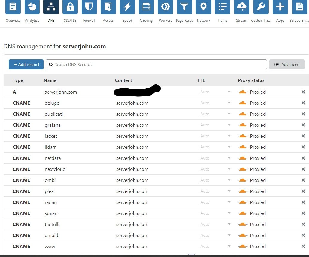

Hi can anyone help me figure out how to get pass this error?
[fix-attrs.d] done.
[cont-init.d] 01-envfile: executing...
[cont-init.d] 01-envfile: exited 0.
[cont-init.d] 10-adduser: executing...
_ ()
| | ___ _ __
| | / __| | | / \
| | \__ \ | | | () |
|_| |___/ |_| \__/
Brought to you by linuxserver.io
We gratefully accept donations at:
https://www.linuxserver.io/donate/
GID/UID
User uid: 99
User gid: 100
[cont-init.d] 10-adduser: exited 0.
[cont-init.d] 20-config: executing...
[cont-init.d] 20-config: exited 0.
[cont-init.d] 30-keygen: executing...
using keys found in /config/keys
[cont-init.d] 30-keygen: exited 0.
[cont-init.d] 50-config: executing...
Variables set:
PUID=99
PGID=100
TZ=America/Los_Angeles
URL=serverjohn.com
SUBDOMAINS=deluge,duplicati,grafana,jacket,lidarr,netdata,nextcloud,ombi,plex,radarr,sonarr,tautulli,unraid,www
EXTRA_DOMAINS=
ONLY_SUBDOMAINS=false
DHLEVEL=4096
VALIDATION=http
DNSPLUGIN=
EMAIL=@serverjohn.com
STAGING=
DH parameters bit setting changed. Deleting old dhparams file.
Creating DH parameters for additional security. This may take a very long time. There will be another message once this process is completed
Generating DH parameters, 4096 bit long safe prime, generator 2
This is going to take a long time
DH parameters successfully created - 4096 bits
SUBDOMAINS entered, processing
Sub-domains processed are: -d deluge.serverjohn.com -d duplicati.serverjohn.com -d grafana.serverjohn.com -d jacket.serverjohn.com -d lidarr.serverjohn.com -d netdata.serverjohn.com -d nextcloud.serverjohn.com -d ombi.serverjohn.com -d plex.serverjohn.com -d radarr.serverjohn.com -d sonarr.serverjohn.com -d tautulli.serverjohn.com -d unraid.serverjohn.com -d www.serverjohn.com
E-mail address entered: stefan@serverjohn.com
http validation is selected
Generating new certificate
Saving debug log to /var/log/letsencrypt/letsencrypt.log
Plugins selected: Authenticator standalone, Installer None
Obtaining a new certificate
Performing the following challenges:
http-01 challenge for deluge.serverjohn.com
http-01 challenge for duplicati.serverjohn.com
http-01 challenge for grafana.serverjohn.com
http-01 challenge for jacket.serverjohn.com
http-01 challenge for lidarr.serverjohn.com
http-01 challenge for netdata.serverjohn.com
http-01 challenge for nextcloud.serverjohn.com
http-01 challenge for ombi.serverjohn.com
http-01 challenge for plex.serverjohn.com
http-01 challenge for radarr.serverjohn.com
http-01 challenge for serverjohn.com
http-01 challenge for sonarr.serverjohn.com
http-01 challenge for tautulli.serverjohn.com
http-01 challenge for unraid.serverjohn.com
http-01 challenge for www.serverjohn.com
Waiting for verification...
Challenge failed for domain deluge.serverjohn.com
Challenge failed for domain duplicati.serverjohn.com
Challenge failed for domain grafana.serverjohn.com
Challenge failed for domain jacket.serverjohn.com
Challenge failed for domain lidarr.serverjohn.com
Challenge failed for domain netdata.serverjohn.com
Challenge failed for domain nextcloud.serverjohn.com
Challenge failed for domain ombi.serverjohn.com
Challenge failed for domain plex.serverjohn.com
Challenge failed for domain radarr.serverjohn.com
Challenge failed for domain serverjohn.com
Challenge failed for domain sonarr.serverjohn.com
Challenge failed for domain tautulli.serverjohn.com
Challenge failed for domain unraid.serverjohn.com
Challenge failed for domain www.serverjohn.com
Cleaning up challenges
Some challenges have failed.
IMPORTANT NOTES:
- The following errors were reported by the server:
Domain: deluge.serverjohn.com
Type: unauthorized
Detail: Invalid response from
http://deluge.serverjohn.com/.well-known/acme-challenge/8E4H5IDuYFjxlRZ7FL86Xdzaf_Vk-3Up0zTw1CyTDS8
[2606:4700:3035::681c:1611]: "<html>\r\n<head><title>404 Not
Found</title></head>\r\n<body>\r\n<center><h1>404 Not
Found</h1></center>\r\n<hr><center>nginx</center>\r\n"
Domain: duplicati.serverjohn.com
Type: unauthorized
http://duplicati.serverjohn.com/.well-known/acme-challenge/lQLmdIzX8m3WM0tx24HXfVKGORWtOlBMVmB93ncP61g
[2606:4700:3037::681c:1711]: "<html>\r\n<head><title>404 Not
Domain: grafana.serverjohn.com
Type: unauthorized
http://grafana.serverjohn.com/.well-known/acme-challenge/CcXRaYWrjNHyPlleeYmJM1rtVNhg1czIZH6O4bQiXDg
Domain: jacket.serverjohn.com
Type: unauthorized
http://jacket.serverjohn.com/.well-known/acme-challenge/2H2wGqtkdmkSZErQ5SUDJH3OA0K2EJUMYKKC9L45VkA
Domain: lidarr.serverjohn.com
Type: unauthorized
http://lidarr.serverjohn.com/.well-known/acme-challenge/xBL_PgEnSbp9XrFS5mJKP3IEn2eUp96uMaXk8RnkykM
Domain: netdata.serverjohn.com
Type: unauthorized
http://netdata.serverjohn.com/.well-known/acme-challenge/6EOzYpleuHVzQ7LrXNOMn6aN_KrOa_3butIiwsfWDd0
Domain: nextcloud.serverjohn.com
Type: unauthorized
http://nextcloud.serverjohn.com/.well-known/acme-challenge/ik2SU9PAfQtcfvBqUByD14HQQ4skGLmB_7_MDFuY6-A
Domain: ombi.serverjohn.com
Type: unauthorized
http://ombi.serverjohn.com/.well-known/acme-challenge/rtjrqFCDHlOXNfjmLQo1QlTERbeNTFHkLhqTlREsEA0
Domain: plex.serverjohn.com
Type: unauthorized
http://plex.serverjohn.com/.well-known/acme-challenge/BID2vNE7WmlcDwO3JwQ0PNhhWjDWrMBUSxXhEUTD9EY
Domain: radarr.serverjohn.com
Type: unauthorized
http://radarr.serverjohn.com/.well-known/acme-challenge/c4iFeq_CYWokLiWtGofA292kDGu5HrgyliJEBOH3V9o
Domain: serverjohn.com
Type: unauthorized
http://serverjohn.com/.well-known/acme-challenge/_J2wAH3GZxcEfrC3GlE7fk1pHxXYLgDOOfNYUYpY7jg
Domain: sonarr.serverjohn.com
Type: unauthorized
http://sonarr.serverjohn.com/.well-known/acme-challenge/v3mVCVA_UJ5avFqcpSVIGRLhzMt_uGyuhRcV2m-srkA
Domain: tautulli.serverjohn.com
Type: unauthorized
http://tautulli.serverjohn.com/.well-known/acme-challenge/A1xvnyKmyR9_x76KwOR3zWOnE6Hhdrvevq5IK0HUMW4
Domain: unraid.serverjohn.com
Type: unauthorized
http://unraid.serverjohn.com/.well-known/acme-challenge/UrtTqcVJ0QpFaaPTytbLU6OBRyQZ4VUFkbn2Ijlx7Pw
Domain: www.serverjohn.com
Type: unauthorized
http://www.serverjohn.com/.well-known/acme-challenge/VBomGHuZb9CQGQpDMKkYlqChznPbdsnbh4yJ0OT_b2U
To fix these errors, please make sure that your domain name was
entered correctly and the DNS A/AAAA record(s) for that domain
contain(s) the right IP address.
ERROR: Cert does not exist! Please see the validation error above. The issue may be due to incorrect dns or port forwarding settings. Please fix your settings and recreate the container
Edited by STEFAN1987
added picture
Link to comment

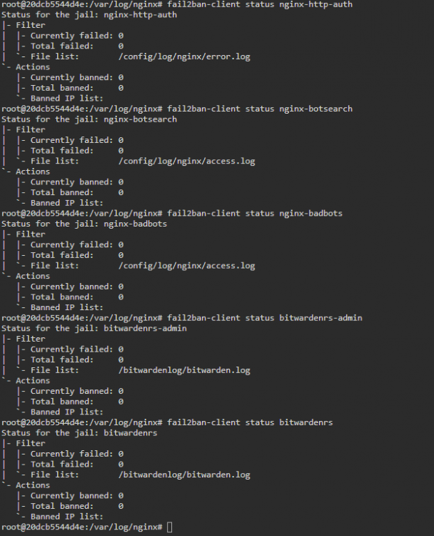

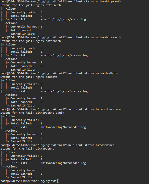

On 4/7/2020 at 12:08 PM, drsparks68 said:
Hello all,
I am trying to configure f2b for permanent bans.
I have started the container with "--cap-add=NET_ADMIN" and have set the bantime to "-1" for each jail (as noted under "Jail Options" at https://www.fail2ban.org/wiki/index.php/MANUAL_0_8).
I am able to see IP's being detected:
2020-03-30 22:04:20,572 fail2ban.filter         [392]: INFO    [nginx-botsearch] Found 148.72.207.250 - 2020-03-30 22:04:20
2020-03-31 06:46:10,028 fail2ban.filter         [386]: INFO    [nginx-botsearch] Found 34.76.172.157 - 2020-03-31 06:46:09
2020-03-31 09:29:25,455 fail2ban.filter         [386]: INFO    [nginx-botsearch] Found 128.199.254.23 - 2020-03-31 09:29:25
2020-03-31 11:38:48,885 fail2ban.filter         [386]: INFO    [nginx-botsearch] Found 103.5.150.16 - 2020-03-31 11:38:48
But I'm not seeing those in the persistent DB (fail2ban.sqlite3):
Curious if I'm missing something that is preventing this from working.
Thanks in advance,
D
Now it seems that Fail2Ban isn't working at all...or at least none of the default jails flagged this traffic and banned the source IP (and there were over 600 lines of it in the NGINX access.log):
Link to comment
