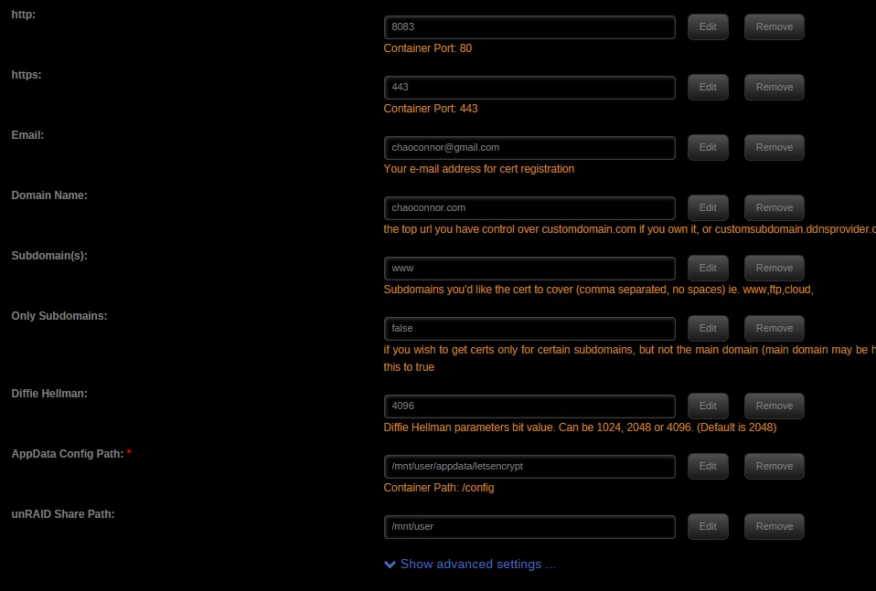

Good morning!  So I've finally gotten around to setting up ddclient to use my dynamic IP with my already registered Google Domain, per the advice of this thread earlier.  Letsencrypt is now throwing the following error message:
IMPORTANT NOTES:
- The following errors were reported by the server:
Domain: chaoconnor.com
Type: unknownHost
Detail: No valid IP addresses found for chaoconnor.com
To fix these errors, please make sure that your domain name was
entered correctly and the DNS A record(s) for that domain
contain(s) the right IP address.
My setup is as follows:
Letsencrypt (see picture)
Google DNS (see picture)
DDclient:
## Google Domains (www.google.com/domains)
protocol=googledomains,
login=<removed>,
password=<removed>
www.chaoconnor.com
If I type in www.chaoconnor.com it brings me to my router homepage, so doesn't that mean DDclient is working?  Note the Google DNS is updated with my IP.  If I go to chaoconnor.com (without the www), it doesn't work.
I also tried using the @ identifier in Google DNS instead of www, and the error for Letsencrypt is:
IMPORTANT NOTES:
Domain: www.chaoconnor.com
Type: connection
Detail: DNS problem: NXDOMAIN looking up A for www.chaoconnor.com
I appreciate any help/guidance you can provide, thanks!

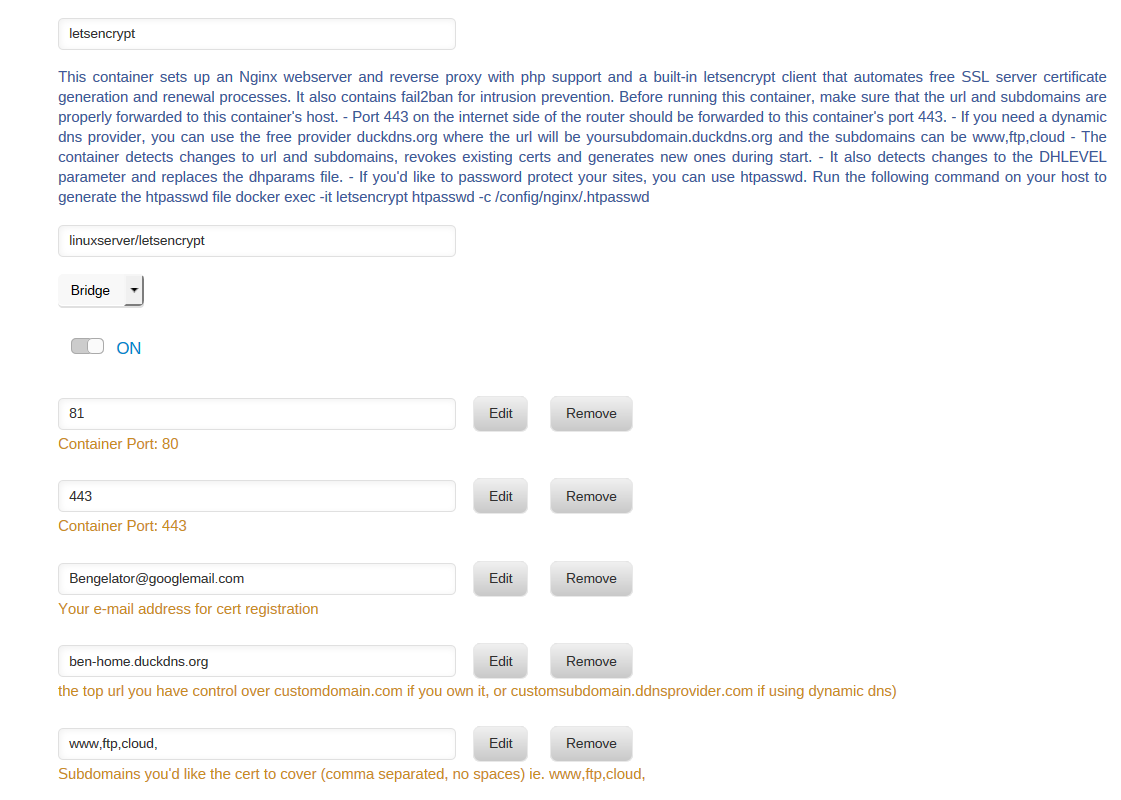

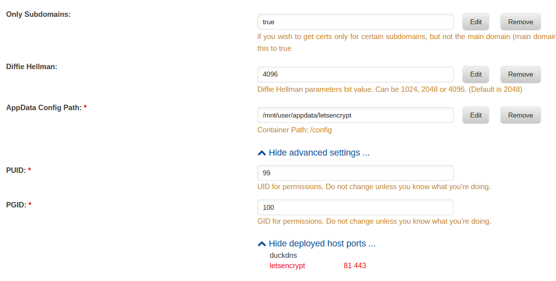

Hello im stuck with the certificate itself
i made a subdomain at duckdns.org "ben-home.duckdns.org" wich is showing the right ip adress.
i made a portforwading in the fritzbox 80->81 and 443 to 443 (fritzbox)
then i added the stuff to the letsencrypt docker:
docker1.thumb.PNG.6ed4d28ee89acd402e186edcad503bd6.PNGdocker2.thumb.PNG.fb0ae93326862406728b64b5d7f6123b.PNG
Now the magically moment:
[fix-attrs.d] done.
[cont-init.d] 10-adduser: executing...
_ _ _
| |___| (_) ___
| / __| | |/ _ \
| \__ \ | | (_) |
|_|___/ |_|\___/
|_|
Brought to you by linuxserver.io
We gratefully accept donations at:
https://www.linuxserver.io/donations/
GID/UID
User uid: 99
User gid: 100
[cont-init.d] 10-adduser: exited 0.
[cont-init.d] 20-config: executing...
[cont-init.d] 20-config: exited 0.
[cont-init.d] 30-keygen: executing...
using keys found in /config/keys
[cont-init.d] 30-keygen: exited 0.
[cont-init.d] 50-config: executing...
DH parameters bit setting changed. Deleting old dhparams file.
Creating DH parameters for additional security. This may take a very long time. There will be another message once this process is completed
Generating DH parameters, 4096 bit long safe prime, generator 2
This is going to take a long time
DH parameters successfully created - 4096 bits
SUBDOMAINS entered, processing
Only subdomains, no URL in cert
Sub-domains processed are: -d www.ben-home.duckdns.org -d ftp.ben-home.duckdns.org -d cloud.ben-home.duckdns.org
E-mail address entered: [email protected]
Different sub/domains entered than what was used before. Revoking and deleting existing certificate, and an updated one will be created
usage:
certbot [SUBCOMMAND] [options] [-d DOMAIN] [-d DOMAIN] ...
Certbot can obtain and install HTTPS/TLS/SSL certificates. By default,
it will attempt to use a webserver both for obtaining and installing the
cert.
certbot: error: argument --cert-path: No such file or directory
Generating new certificate
Saving debug log to /var/log/letsencrypt/letsencrypt.log
Obtaining a new certificate
Performing the following challenges:
tls-sni-01 challenge for www.ben-home.duckdns.org
tls-sni-01 challenge for ftp.ben-home.duckdns.org
tls-sni-01 challenge for cloud.ben-home.duckdns.org
Waiting for verification...
Cleaning up challenges
Failed authorization procedure. www.ben-home.duckdns.org (tls-sni-01): urn:acme:error:connection :: The server could not connect to the client to verify the domain :: Error getting validation data, cloud.ben-home.duckdns.org (tls-sni-01): urn:acme:error:connection :: The server could not connect to the client to verify the domain :: Error getting validation data, ftp.ben-home.duckdns.org (tls-sni-01): urn:acme:error:connection :: The server could not connect to the client to verify the domain :: Error getting validation data
IMPORTANT NOTES:
Domain: www.ben-home.duckdns.org
Type: connection
Detail: Error getting validation data
Domain: cloud.ben-home.duckdns.org
Type: connection
Domain: ftp.ben-home.duckdns.org
Type: connection
contain(s) the right IP address. Additionally, please check that
your computer has a publicly routable IP address and that no
firewalls are preventing the server from communicating with the
client. If you're using the webroot plugin, you should also verify
that you are serving files from the webroot path you provided.
- Your account credentials have been saved in your Certbot
configuration directory at /etc/letsencrypt. You should make a
secure backup of this folder now. This configuration directory will
also contain certificates and private keys obtained by Certbot so
making regular backups of this folder is ideal.
/var/run/s6/etc/cont-init.d/50-config: line 117: cd: /config/keys/letsencrypt: No such file or directory
[cont-init.d] 50-config: exited 1.
[cont-finish.d] executing container finish scripts...
[cont-finish.d] done.
[s6-finish] syncing disks.
[s6-finish] sending all processes the TERM signal.
IMPORTANT NOTES:
Type: connection
Type: connection
Type: connection
[s6-finish] sending all processes the KILL signal and exiting.
Troubleshooting so far:
i switched in fritzbox from port 81 to 80 and checked if i can reach my unraid webside per www.ben-home.duckdns.org and it worked.
i redownloaded this docker again and again but im stuck.
Have you ideas? i realy realy realy would appreciate your help
Regards
Bengele
Edited by bengele
