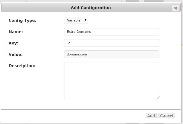

On 7.7.2017 at 6:11 AM, ijuarez said:
I've updated my docker how do I add the new variable?
I am also interested how to add the new variable.
Br,
Johannes
Br,
Johannes
Click on "Add another Path, Port or Variable"
Like this?
Like this?
Key should be EXTRA_DOMAINS and don't forget the underscore in the middle
If you go to edit one of the other variables like the PUID, you can see the format
