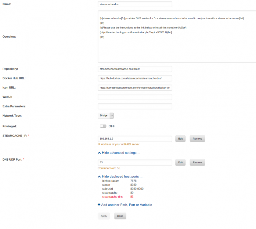

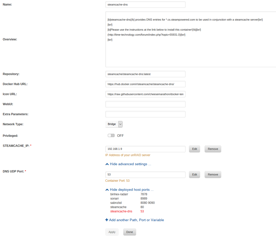

I keep getting this problem with port 53 for the DNS server. I'm unsure how to correct it...
59f68f574f6d5_2017-10-2921_31_58-Tower_UpdateContainer.thumb.png.7b0912799d2e7a74865ee49c2de512d0.png
Do you have virtual machines enabled in your settings? If so where turning that on unraid starts a dnsmasq service listening on port 53 so it's unavailable for the docker container to use. This is only fixed by turning of VM's in unraid settings.

On 26.10.2017 at 11:08 PM, cheesemarathon said:
Remove the TPC port. Make sure the network is in bridge mode not host. Turn privelaged off. Change the key for steamcache-ip to STEAMCACHE_IP.

Why via terminal. Do you not have access to web UI. It's much easier with the web UI.
I have not tried this via terminal however if you stop and remove the current container:
docker stop steamcache-dns
docker rmi steamcache-dns
Then try running the following command. I have not tried this so I have no idea if it will work but it should be the command that the web UI runs. Don't forget to change the IP to the IP of your unraid server.
/usr/local/emhttp/plugins/dynamix.docker.manager/scripts/docker create --name="steamcache-dns" --net="bridge" -e TZ="Europe/London" -e HOST_OS="unRAID" -e "STEAMCACHE_IP"="111.111.111.111" -p 53:53/udp steamcache/steamcache-dns:latest
EDIT:
I have just tried the above command. It appears to work. The container appears in the GUI. I did have to tell it to update for it to report if it was up to date or not in the GUI. It started off saying unavailable. Another note. There should be an update available now so you should just be able to click the update button in the GUI for it to pull these changes.

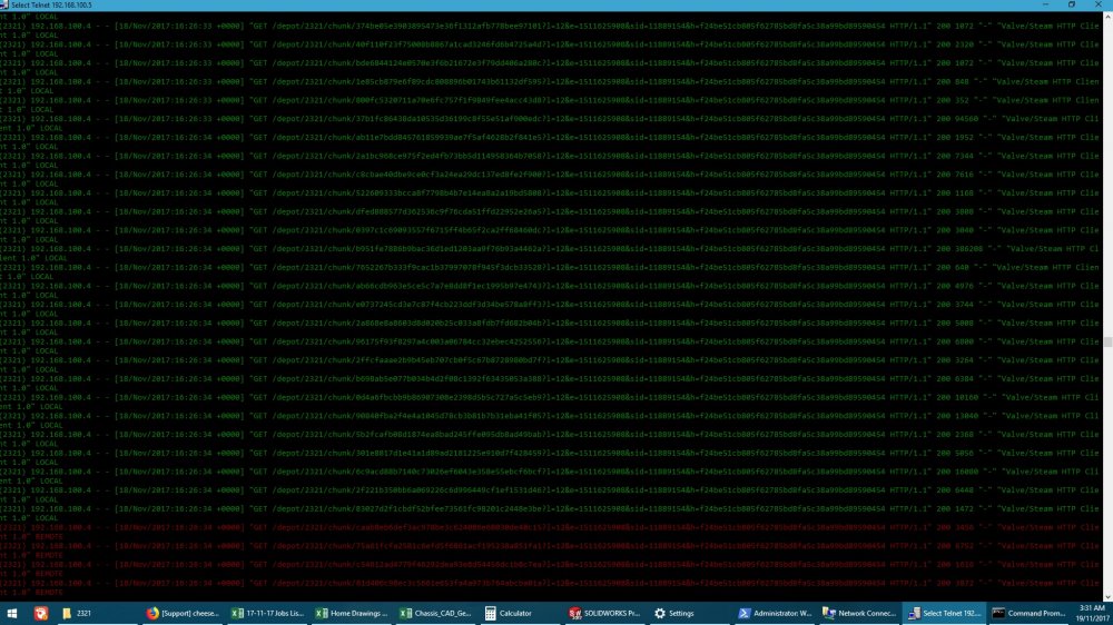

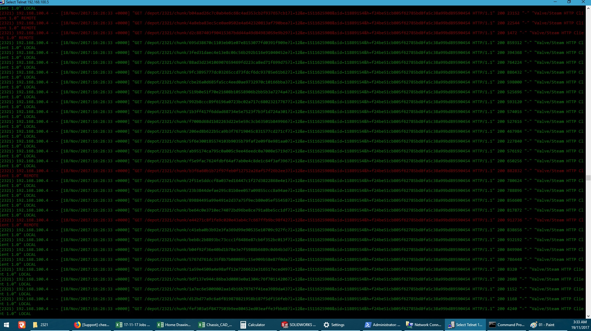

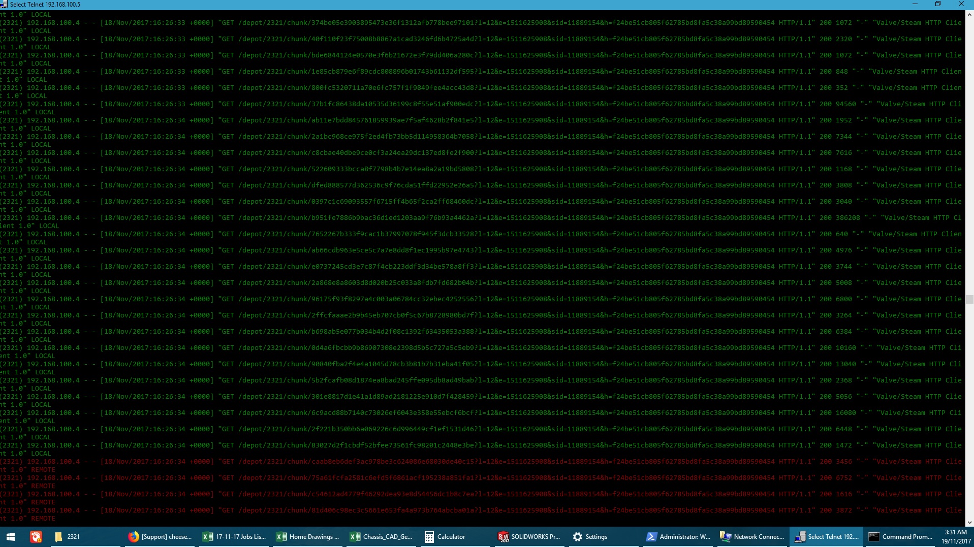

i have done everything you have said and games install really fast like there coming right off the server but i get a few red lines amoung the crap load of green is this normal or am i missing somthing
Hi There
That's perfectly normal. Green text is data steam is getting from your cache. Red is data steam is getting from steam servers. Yellow (none here but you may see some at some point) is any other internet traffic. The download in the pictures looks like you have most of the data but there has been an update since the cache was made so it's grabbing those parts from steams servers!
