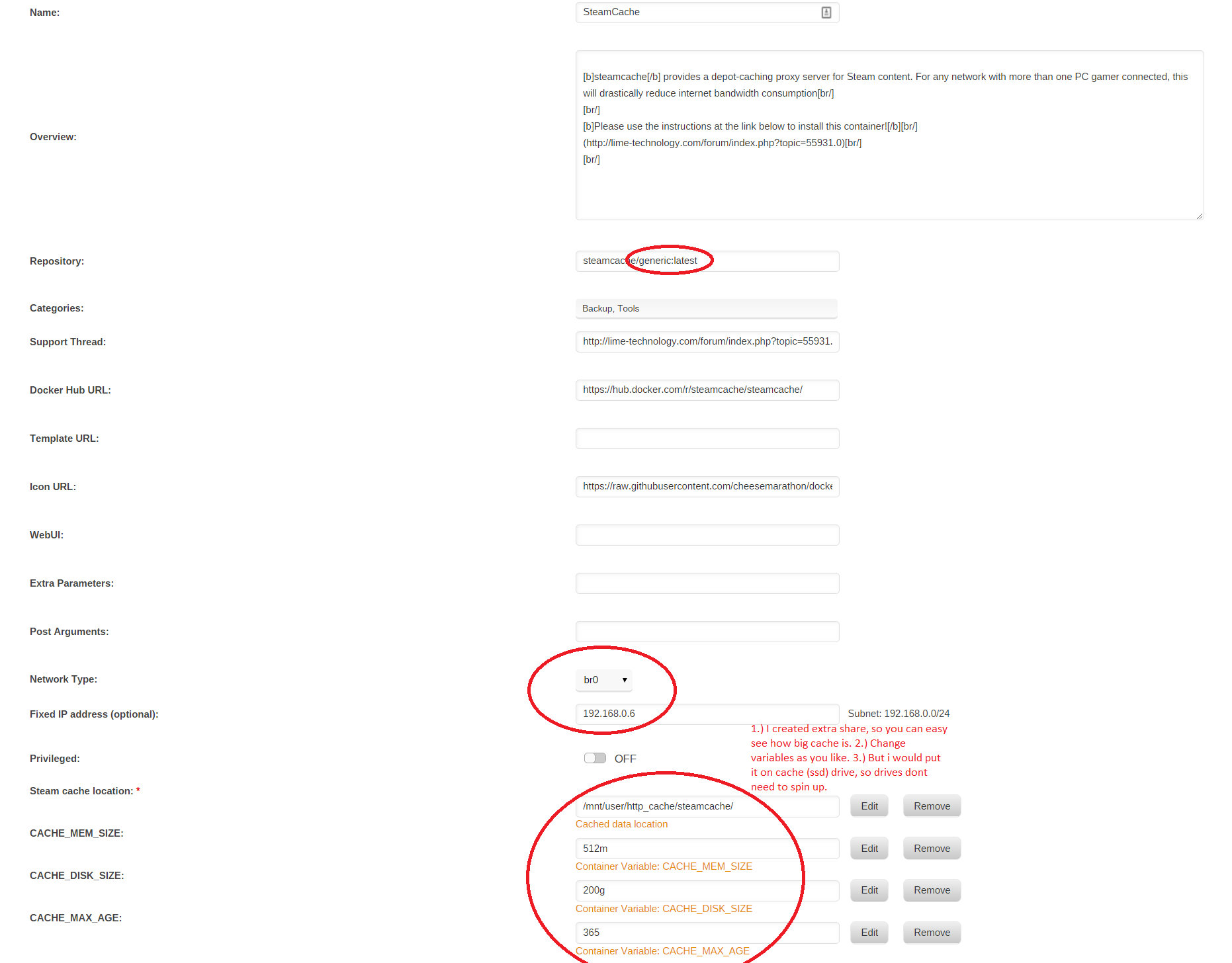

When i come home from work, i make pcitures of all settings i did.. Would be great if u could add that all into on docker.. :D

Fantastic, yes post pictures of of how you have it all set up and ill see what I can out together! Well done!

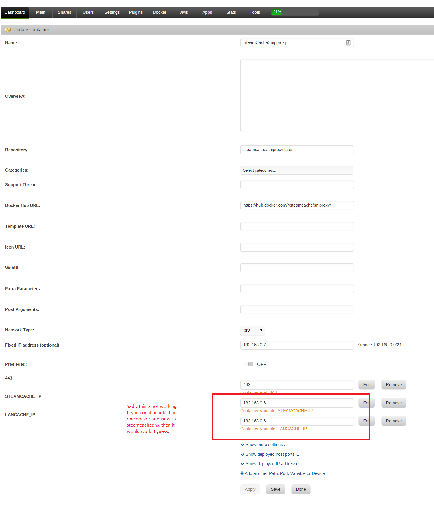

does work in Sniproxy.
I need a way to tell sniproxy where the steamcache is.

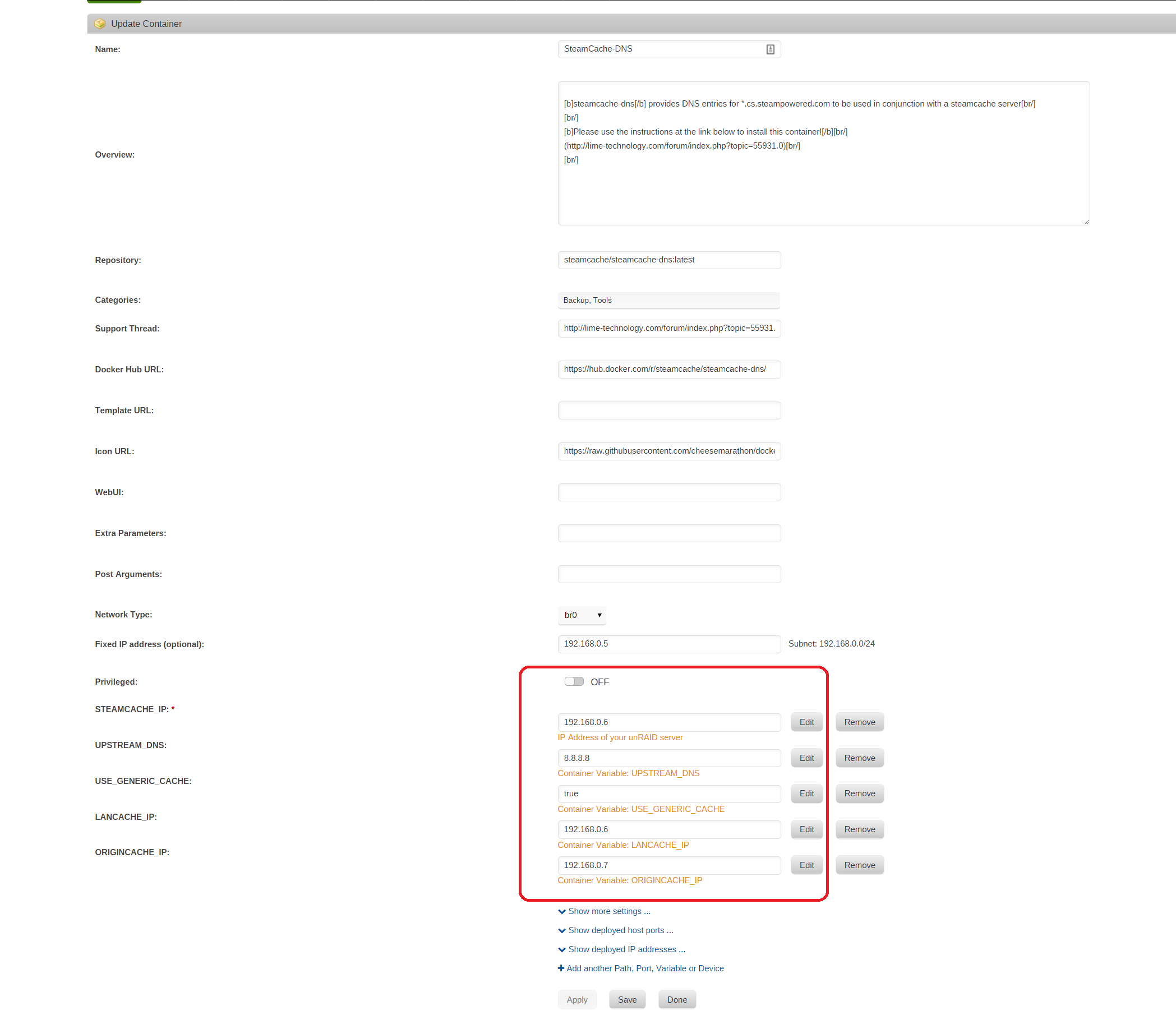

I add screenshots of all my settings, if u have any questions, feel free to ask:
Edited by nuhll
LANCACHE_IP = Steamcache Docker IP
ORIGINCACHE_IP = SNiPPROXY Docker IP -> i guess SNIPPROXY then redirects to his own IP, which ofc, is not working bc Steamcache is another IP
UPSTREAM_DNS = very important, i use google dns, but i guess any work, if there is no upstream DNS the docker uses your own, which may or may not your own local DNS (loop).
How hard is it to bundle Steamcache, Steamcache DNS and Snipproxy into one docker?

Did you got my messages? Could you please combine sip proxy with Steamcache? Atleast only this 2 dockers. (i wrote on picture combine with steamcachedns, which is wrong). It need to be combined snip proxy + steamcache.
