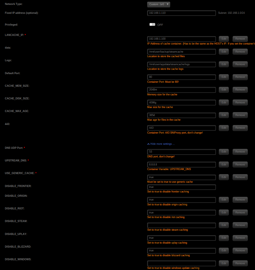

Hey guys,
Having a little trouble getting this working.
I have SteamCache configured to use the host's IP (192.168.1.100). I've tried setting a fixed IP for the container itself as well, that doesn't seem to chance things.

Hey @-Daedalus
Sorry it's taken me ages to reply.
It looks like you have checked all the obvious stuff so ill get @mlebjerg to chime in here as well.
When you say you run bootstrap.sh, is that when you start the container or are you manually running bootstrap.sh. Bootstrap.sh runs when the container starts so there is no need to manually run it. Running it again would probably create a similar output to above.
If that's not the case, can we see a screenshot of your config for SteamCache? Also I'd suggest stopping all your VM's and restarting SteamCache, just in case there was something running your unaware of.
Hey cheese, thanks for the reply!
The bootstrap output from before was me manually running it when the container was started. Didn't realise it was run anyway.
I changed nothing, restarted the container (for the hundredth time) and it the DNS test in PowerShell works!
... but now when I change a machine's DNS to point to SteamCache, I get a no internet error when trying to download a game. My machine still has internet access though, so I think it's just the Steam servers themselves that can't resolve. I can't login to Steam in this state either.
Container config attached. I also tried changing LANCACHE_IP to match the container at x.x.x.110 (the wording was a little unclear which one I should use) but everything's the same.
Any help would be great!
@-Daedalus You definitely need to set LANCACHE_IP to 192.168.1.110
I would also remove all the "true" values you entered to disable some of the caching services for now to make sure they are not causing issues. You can set them back to what you like once it is all working. DO NOT remove the "true" value for USE_GENERIC_CACHE. That will break it ?
Make sure to set your DNS settings on your gaming machine to 192.168.1.110. Also make sure that that is the only IP you set. Try that and see how it go's. If that doesn't work let me know and post the output log from the container (best to use paste bin if it's long).

Hey cheese, thanks for the help! I did try .110 this morning before work for the steamcache_ip, and it didn't seem to change things, but trying it again now worked. I'm getting "MISS / HIT" output in the log (also for a Windows update that got pulled down at the same time).
The only odd thing is that it doesn't seem to keep everything.
I install a 1GB game, and I only have 600MB of cached files. I install another 1GB game, and the cache grows to 1.2GB. I'm not even sure how much of it is Steam and how much is from the Windows update. Any idea what might be happening? Looking for content on a different endpoint, maybe?
Anyway, it's working, so that's a plus. I'll start re-enabling bits tomorrow to see if it still works with the 'true' flags set (no reason why it wouldn't, but hey).

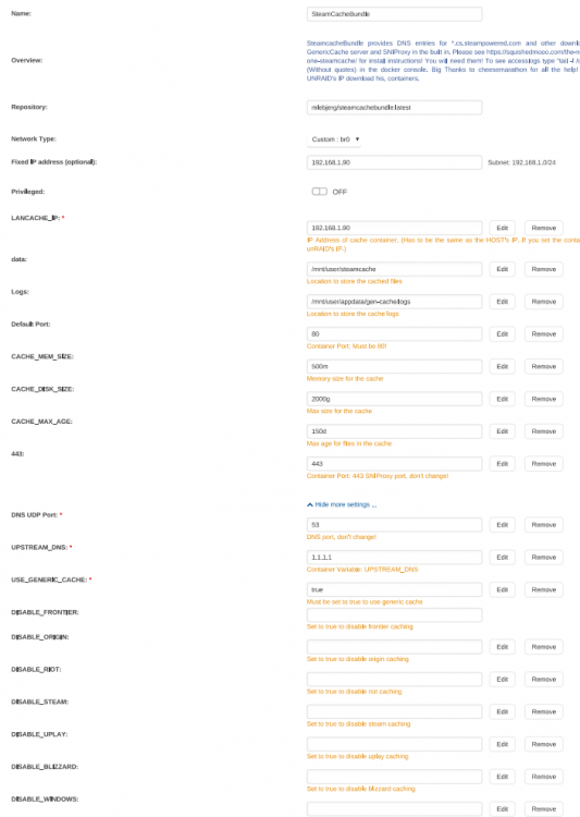

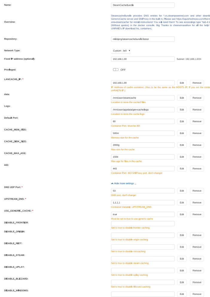

Hi
I am having some issues getting the steam cache bundle going.
Steps to get where I am at now:
- set unraid ports to something else than 80 and 443
- install steamcachebundle from community applications
- cleared download cache in steam
- in windows manually set the dns ip to '192.168.1.90' (no secondary server)
- in windows disable ipv6

Hi there!
As @nuhll said, there if powershell gives the correct IP there should't be a problem :)
Sometimes it takes some time for the client to get the hint. How long have you waited?
Also if the steamcache IP is different from UnRaid's IP there is no reason to change its ports ;)
yeah, also true.
btw, i mean the cache folder from steamcache, if that is increasing or not.
Because not all will get cached, for me it happend too often that only 1/4 of a game was cache (able) , thats why i removed it.

Hi @nuhll, @mlebjerg
Thanks for the tips!
I think i have given it half an hour or something, i'll leave it on while i'm sleeping to see if it changes something.
I have tried to be as thorough as possible when testing it:
windows:
1. check the hosts file, nothing strange there
2. set dns ip to 192.168.1.90
3. flushdns
4. clear download cache on steam
5. clear the steam content log
unraid:
1. compute steamcache share: 0B
2. make sure that steamcache share is not using the cache drive
3. clear the logfiles
4. open 2 command windows that tail the /data/logs/access.log and error.log
windows:
1. check dns in powershell --> gives me 192.168.1.90
2. start a download on steam
unraid:
1. check the steamcache share size: 0 B
windows:
1. uninstall game
2. reinstall game
3. try another game
dd-wrt router:
1. check if there is traffic going outside of the LAN: yes
unraid:
1. observe the tails that i had started on error.log and access.log. they are empty
2. double check on the docker container, logs are empty
I have added the steam content log, maybe that can help.
Are there other ways I can test if it is working properly?
Thanks for the help!
