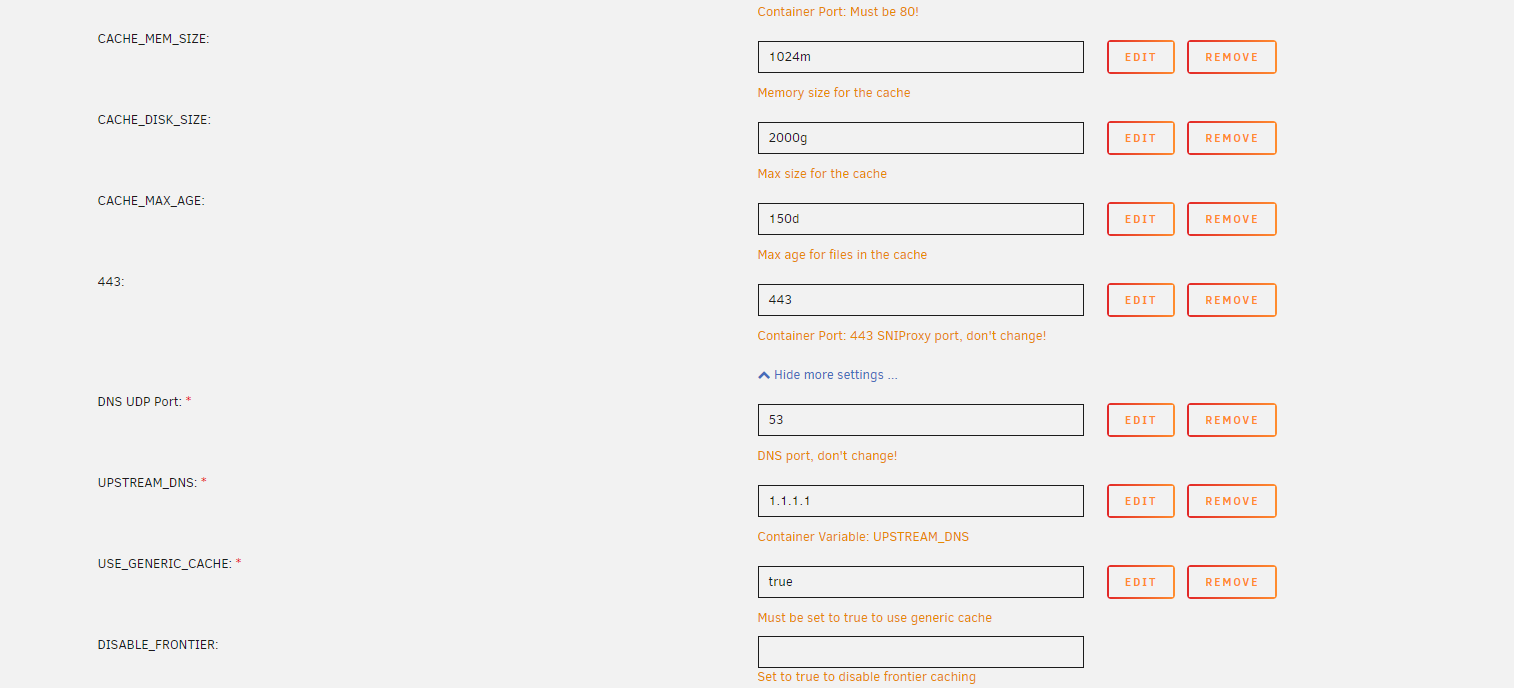

Hello guy´s,
i have tried to get this working under Unraid 6.6.4 but it don´t work
Heare are some data:
Settings from Steamcache:
Logs from the Docker
Powershell:
Fritzbox settings
(i also tried to set secondary DNS Server to 8.8.8.8
Windows:
In the folder from steamcache ther is only a cache folder.
And this folder is completly empty
The HDD doesn´t spin up when i downloading a game in steam.
What can i do to get this work?

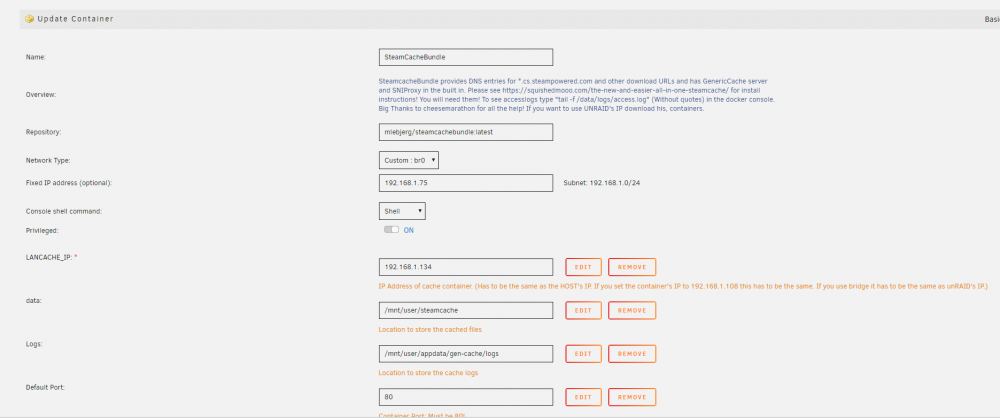

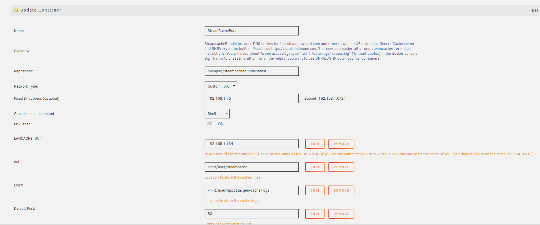

On 11/10/2018 at 10:44 PM, Freshavakado said:
Thanks for the information, that's really good to know, always appreciate learning something new. So I did try it again with the correct commands while using SteamCacheBundle console and I'm still now seeing anything happening after entering the command. I thought maybe some screen caps might help explain a bit. So that's what the console looks like when I put in the command, I tried it twice and the rest of the photos are how I have the container set up. I really appreciate your help.
Hey!
Year very nearly there. There is just one error in your config. The "LANCACHE_IP" setting wants to be the same IP as you set in the "Fixed IP" setting. So in your case both should be 192.168.1.75
Then you should be good to go. That command you run will then output the logs from the container and you will see the cache working.

So i turned off Privileged and this is the error i get in the logs
Running bootstrap.sh...
nginx: the configuration file /etc/nginx/nginx.conf syntax is ok
nginx: configuration file /etc/nginx/nginx.conf test is successful
Bind9 {
Enabling cache for Blizzard
2018-11-23 22:22:31 Failed to set file handle limit: Operation not permitted
Enabling cache for Frontier
Enabling cache for Origin
Enabling cache for Riot
Enabling cache for Steam
Enabling cache for Uplay
Enabling cache for Windows
Enabling custom DNS forwarder
bootstrap finished.
checking Bind9 config
Running Bind9
Tried it again and nothing showing in the log its just blank...
Could this be down to IPV6? someone above had a similar problem..
or could me running a VPN be an issue? i tried turning off the VPn and it made no difference
Edited by enigma27
ok scrap all that.. seem to have got it working..
Seems i had to specify the Steamcache IP under the DHCP server as a DNS server rather than the general page... seems to be working now..
One question.. whats the best option to get max speed when installing from the cache? right now I have the steamcache on my mechanical HD shares..
Well there is really no need to put it on an SSD unless you have a 10 Gig network, HDD should be fine with a 1 gig network. Besides some game files you have unpack, so your CPU will be the bottleneck if you have the cache on a fast SSD and a 10 gig network ;)
This is really a bandwidth saver, the speed is just a niceness thing!
thanks.
I tested last night with a few small games and it wasnt going much faster than my internet speed
I usually get 3.7Mb/s from steam and from the cache it was only giving 4.4mb/s
I thought it would be a bit quicker.
57 minutes ago, enigma27 said:
thanks.
It really should be faster, how much ram have you given it?
Could also be it doesn't hit on all the files, sometimes you have to wait a day or two so your cache has been warmed up, it sounds weird but it has happened to me :)
server spec is as below
Xeon 4core / 8 thread
16gb ram
1gb network
you maybe right and it may need a few days to bed in.
