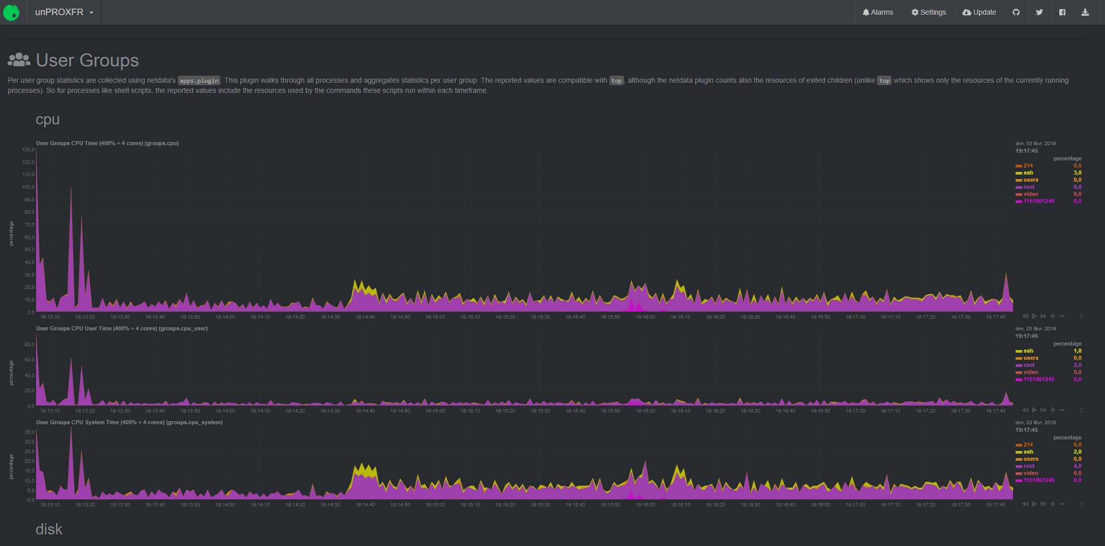

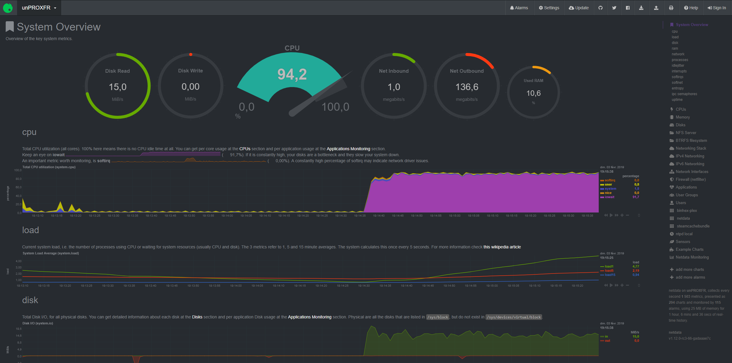

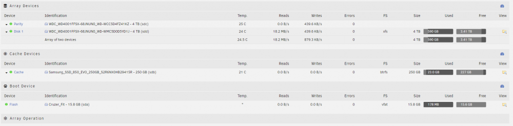

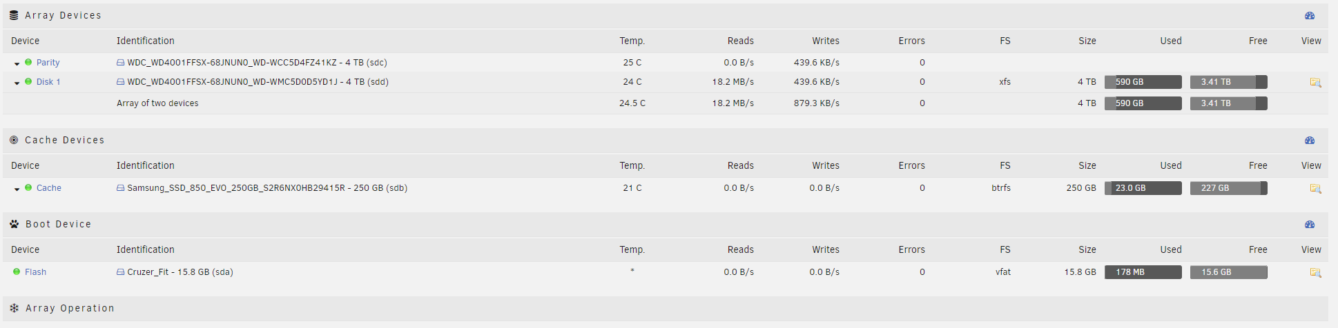

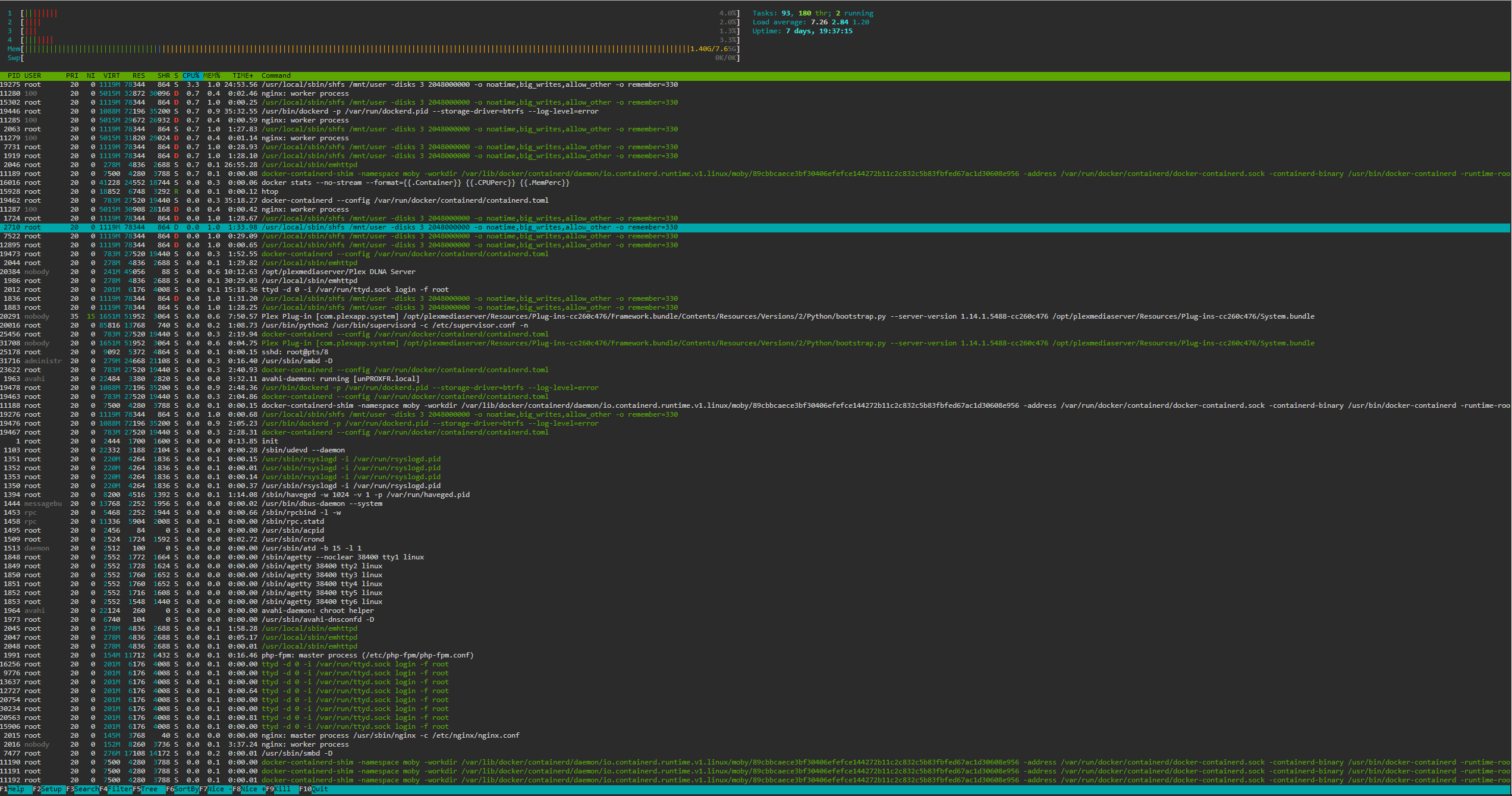

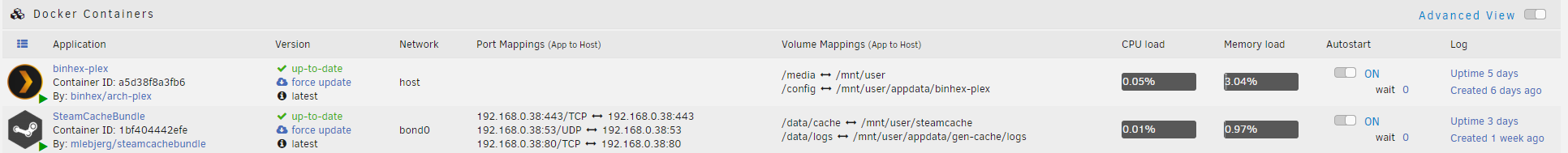

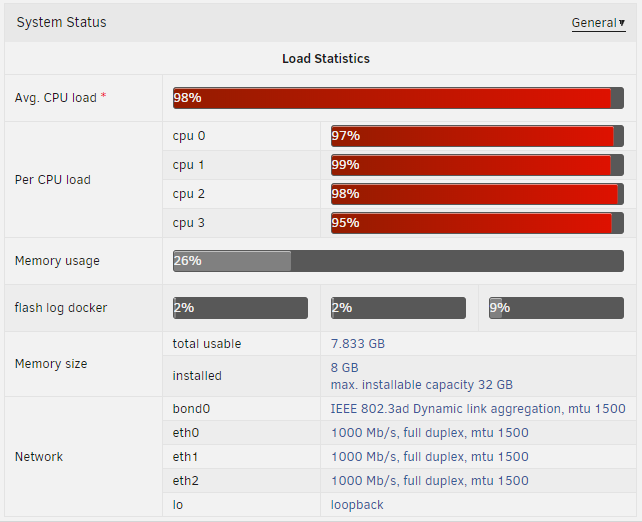

Hello, thank you for your work.
I am new to unraid, I managed to make your image work, but when transferring to a client with the files already cached, the CPU usage of my unraid server is close to 100%, but I do not know where it comes from, the CPU usage read by docker is only 3%, and when I connect in SSH and I monitore the use CPU with htop, it is very weak too ...
This CPU usage is due to the OS unraid or the docker image?
Maybe I'm bottleneck by my CPU configuration?
I am attaching you, the screenshots that I was able to read and the diagnostic file.
Thank you for your help and sorry for my average english, I am french. 😉

Hmm that is very strange! If that first screenshot was taken at the same time as your ran htop then I would say that the dashboard is doing something wrong. I suggest you install Netdata from community applications. This will show you a lot of useful stats for diagnosing issues. Overall statistics and stats are broken down to individual containers.

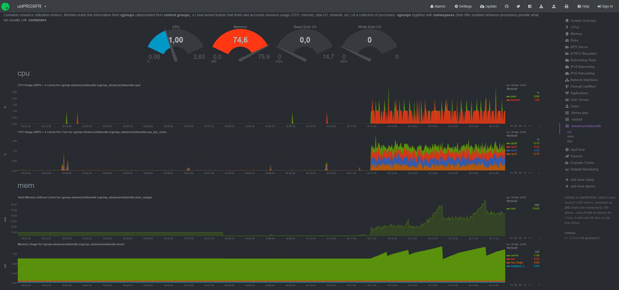

I downloaded netdata and the CPU is 100% ... I don't know where it can come from at all. Maybe you need more accurate screenshots?
Thanks for your help!
I'm not an expert in system stats but by the looks of things, your system usage is high because of IO wait. This is the system waiting for input/output operations to complete. If in netdata on the right hand side you click on steamcache, I would imagine you will see nearly 100% cpu usage on this container. To fix this there are several things you can look at. One of your disks may have an issue with it, slowing down read/write operations, you may also be running low on RAM in the system. I have not seen this issue before with Steamcache so I don't think that it is anything specific to steam cache causing an issue, it has just highlighted the problem. When building a NAS IOWait is an issue because most the of the applications you use a NAS for will at some point perform large read/write operations to disks. So I suggest that you do some googling to find a solution as there is no deffinitive fix for this. If you do need more help however, just ask! 🙂
Thank you for your answer, it's a pleasure to speak with people like you!
I will study the problems of iowait to find a solution.
The only thing that is used at about 100% is the iowait. I can't find anything else in netdata ...
Thanks again! 😉
