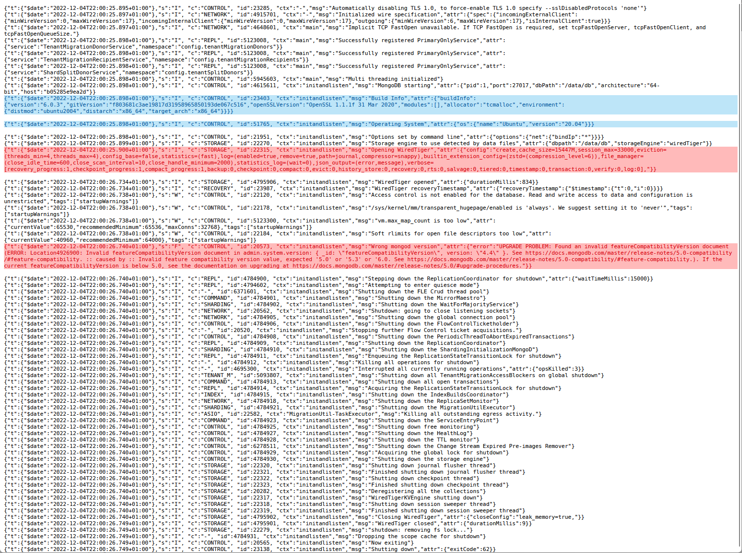

Hey, I'm having issues recently where the docker shuts itself down. Logs below, I'm not entirely sure where to start troubleshooting here...  Every time I start the docker it stops and under "uptime" it says "Exited (14): xx seconds ago"
Spoiler
ErrorWarningSystemArrayLogin
{"t":{"$date":"2021-07-20T17:32:40.419-07:00"},"s":"I", "c":"NETWORK", "id":4915701, "ctx":"-","msg":"Initialized wire specification","attr":{"spec":{"incomingExternalClient":{"minWireVersion":0,"maxWireVersion":13},"incomingInternalClient":{"minWireVersion":0,"maxWireVersion":13},"outgoing":{"minWireVersion":0,"maxWireVersion":13},"isInternalClient":true}}}
{"t":{"$date":"2021-07-20T17:32:40.422-07:00"},"s":"I", "c":"CONTROL", "id":23285, "ctx":"-","msg":"Automatically disabling TLS 1.0, to force-enable TLS 1.0 specify --sslDisabledProtocols 'none'"}
{"t":{"$date":"2021-07-20T17:32:40.423-07:00"},"s":"W", "c":"ASIO", "id":22601, "ctx":"main","msg":"No TransportLayer configured during NetworkInterface startup"}
{"t":{"$date":"2021-07-20T17:32:40.423-07:00"},"s":"I", "c":"NETWORK", "id":4648601, "ctx":"main","msg":"Implicit TCP FastOpen unavailable. If TCP FastOpen is required, set tcpFastOpenServer, tcpFastOpenClient, and tcpFastOpenQueueSize."}
{"t":{"$date":"2021-07-20T17:32:40.424-07:00"},"s":"W", "c":"ASIO", "id":22601, "ctx":"main","msg":"No TransportLayer configured during NetworkInterface startup"}
{"t":{"$date":"2021-07-20T17:32:40.425-07:00"},"s":"I", "c":"REPL", "id":5123008, "ctx":"main","msg":"Successfully registered PrimaryOnlyService","attr":{"service":"TenantMigrationDonorService","ns":"config.tenantMigrationDonors"}}
{"t":{"$date":"2021-07-20T17:32:40.425-07:00"},"s":"I", "c":"REPL", "id":5123008, "ctx":"main","msg":"Successfully registered PrimaryOnlyService","attr":{"service":"TenantMigrationRecipientService","ns":"config.tenantMigrationRecipients"}}
{"t":{"$date":"2021-07-20T17:32:40.425-07:00"},"s":"I", "c":"CONTROL", "id":4615611, "ctx":"initandlisten","msg":"MongoDB starting","attr":{"pid":1,"port":27017,"dbPath":"/data/db","architecture":"64-bit","host":"b36d9065024d"}}
{"t":{"$date":"2021-07-20T17:32:40.425-07:00"},"s":"I", "c":"CONTROL", "id":23403, "ctx":"initandlisten","msg":"Build Info","attr":{"buildInfo":{"version":"5.0.0","gitVersion":"1184f004a99660de6f5e745573419bda8a28c0e9","openSSLVersion":"OpenSSL 1.1.1f 31 Mar 2020","modules":[],"allocator":"tcmalloc","environment":{"distmod":"ubuntu2004","distarch":"x86_64","target_arch":"x86_64"}}}}
{"t":{"$date":"2021-07-20T17:32:40.425-07:00"},"s":"I", "c":"CONTROL", "id":51765, "ctx":"initandlisten","msg":"Operating System","attr":{"os":{"name":"Ubuntu","version":"20.04"}}}
{"t":{"$date":"2021-07-20T17:32:40.425-07:00"},"s":"I", "c":"CONTROL", "id":21951, "ctx":"initandlisten","msg":"Options set by command line","attr":{"options":{"net":{"bindIp":"*"}}}}
{"t":{"$date":"2021-07-20T17:32:40.437-07:00"},"s":"W", "c":"STORAGE", "id":22271, "ctx":"initandlisten","msg":"Detected unclean shutdown - Lock file is not empty","attr":{"lockFile":"/data/db/mongod.lock"}}
{"t":{"$date":"2021-07-20T17:32:40.438-07:00"},"s":"I", "c":"STORAGE", "id":22270, "ctx":"initandlisten","msg":"Storage engine to use detected by data files","attr":{"dbpath":"/data/db","storageEngine":"wiredTiger"}}
{"t":{"$date":"2021-07-20T17:32:40.438-07:00"},"s":"W", "c":"STORAGE", "id":22302, "ctx":"initandlisten","msg":"Recovering data from the last clean checkpoint."}
{"t":{"$date":"2021-07-20T17:32:40.438-07:00"},"s":"I", "c":"STORAGE", "id":22315, "ctx":"initandlisten","msg":"Opening WiredTiger","attr":{"config":"create,cache_size=7437M,session_max=33000,eviction=(threads_min=4,threads_max=4),config_base=false,statistics=(fast),log=(enabled=true,archive=true,path=journal,compressor=snappy),builtin_extension_config=(zstd=(compression_level=6)),file_manager=(close_idle_time=600,close_scan_interval=10,close_handle_minimum=250),statistics_log=(wait=0),verbose=[recovery_progress,checkpoint_progress,compact_progress],"}}
{"t":{"$date":"2021-07-20T17:32:40.902-07:00"},"s":"E", "c":"STORAGE", "id":22435, "ctx":"initandlisten","msg":"WiredTiger error","attr":{"error":0,"message":"[1626827560:902726][1:0x14b5ab06fc80], file:WiredTiger.wt, connection: __wt_block_read_off, 297: WiredTiger.wt: read checksum error for 4096B block at offset 12288: block header checksum of 0x61746164 doesn't match expected checksum of 0xb2ca58a9"}}
{"t":{"$date":"2021-07-20T17:32:40.902-07:00"},"s":"E", "c":"STORAGE", "id":22435, "ctx":"initandlisten","msg":"WiredTiger error","attr":{"error":0,"message":"[1626827560:902864][1:0x14b5ab06fc80], file:WiredTiger.wt, connection: __wt_bm_corrupt_dump, 139: {0: 12288, 4096, 0xb2ca58a9}: (chunk 1 of 4): 6f 6e 65 2c 61 6c 6c 6f 63 61 74 69 6f 6e 5f 73 69 7a 65 3d 34 4b 42 2c 61 70 70 5f 6d 65 74 61 64 61 74 61 3d 28 66 6f 72 6d 61 74 56 65 72 73 69 6f 6e 3d 38 29 2c 61 73 73 65 72 74 3d 28 63 6f 6d 6d 69 74 5f 74 69 6d 65 73 74 61 6d 70 3d 6e 6f 6e 65 2c 64 75 72 61 62 6c 65 5f 74 69 6d 65 73 74 61 6d 70 3d 6e 6f 6e 65 2c 72 65 61 64 5f 74 69 6d 65 73 74 61 6d 70 3d 6e 6f 6e 65 2c 77 72 69 74 65 5f 74 69 6d 65 73 74 61 6d 70 3d 6f 66 66 29 2c 62 6c 6f 63 6b 5f 61 6c 6c 6f 63 61 74 69 6f 6e 3d 62 65 73 74 2c 62 6c 6f 63 6b 5f 63 6f 6d 70 72 65 73 73 6f 72 3d 2c 63 61 63 68 65 5f 72 65 73 69 64 65 6e 74 3d 66 61 6c 73 65 2c 63 68 65 63 6b 73 75 6d 3d 6f 6e 2c 63 6f 6c 6c 61 74 6f 72 3d 2c 63 6f 6c 75 6d 6e 73 3d 2c 64 69 63 74 69 6f 6e 61 72 79 3d 30 2c 65 6e 63 72 79 70 74 69 6f 6e 3d 28 6b 65 79 69 64 3d 2c 6e 61 6d 65 3d 29 2c 66 6f 72 6d 61 74 3d 62 74 72 65 65 2c 68 75 66 66 6d 61 6e 5f 6b 65 79 3d 2c 68 75 66 66 6d 61 6e 5f 76 61 6c 75 65 3d 2c 69 64 3d 34 38 2c 69 67 6e 6f 72 65 5f 69 6e 5f 6d 65 6d 6f 72 79 5f 63 61 63 68 65 5f 73 69 7a 65 3d 66 61 6c 73 65 2c 69 6e 74 65 72 6e 61 6c 5f 69 74 65 6d 5f 6d 61 78 3d 30 2c 69 6e 74 65 72 6e 61 6c 5f 6b 65 79 5f 6d 61 78 3d 30 2c 69 6e 74 65 72 6e 61 6c 5f 6b 65 79 5f 74 72 75 6e 63 61 74 65 3d 74 72 75 65 2c 69 6e 74 65 72 6e 61 6c 5f 70 61 67 65 5f 6d 61 78 3d 31 36 6b 2c 6b 65 79 5f 66 6f 72 6d 61 74 3d 75 2c 6b 65 79 5f 67 61 70 3d 31 30 2c 6c 65 61 66 5f 69 74 65 6d 5f 6d 61 78 3d 30 2c 6c 65 61 66 5f 6b 65 79 5f 6d 61 78 3d 30 2c 6c 65 61 66 5f 70 61 67 65 5f 6d 61 78 3d 31 36 6b 2c 6c 65 61 66 5f 76 61 6c 75 65 5f 6d 61 78 3d 30 2c 6c 6f 67 3d 28 65 6e 61 62 6c 65 64 3d 74 72 75 65 29 2c 6d 65 6d 6f 72 79 5f 70 61 67 65 5f 69 6d 61 67 65 5f 6d 61 78 3d 30 2c 6d 65 6d 6f 72 79 5f 70 61 67 65 5f 6d 61 78 3d 35 4d 42 2c 6f 73 5f 63 61 63 68 65 5f 64 69 72 74 79 5f 6d 61 78 3d 30 2c 6f 73 5f 63 61 63 68 65 5f 6d 61 78 3d 30 2c 70 72 65 66 69 78 5f 63 6f 6d 70 72 65 73 73 69 6f 6e 3d 74 72 75 65 2c 70 72 65 66 69 78 5f 63 6f 6d 70 72 65 73 73 69 6f 6e 5f 6d 69 6e 3d 34 2c 72 65 61 64 6f 6e 6c 79 3d 66 61 6c 73 65 2c 73 70 6c 69 74 5f 64 65 65 70 65 6e 5f 6d 69 6e 5f 63 68 69 6c 64 3d 30 2c 73 70 6c 69 74 5f 64 65 65 70 65 6e 5f 70 65 72 5f 63 68 69 6c 64 3d 30 2c 73 70 6c 69 74 5f 70 63 74 3d 39 30 2c 74 69 65 72 65 64 5f 73 74 6f 72 61 67 65 3d 28 61 75 74 68 5f 74 6f 6b 65 6e 3d 2c 62 75 63 6b 65 74 3d 2c 6c 6f 63 61 6c 5f 72 65 74 65 6e 74 69 6f 6e 3d 33 30 30 2c 6e 61 6d 65 3d 2c 6f 62 6a 65 63 74 5f 74 61 72 67 65 74 5f 73 69 7a 65 3d 31 30 4d 29 2c 76 61 6c 75 65 5f 66 6f 72 6d 61 74 3d 75 2c 76 65 72 62 6f 73 65 3d 5b 5d 2c 76 65 72 73 69 6f 6e 3d 28 6d 61 6a 6f 72 3d 31 2c 6d 69 6e 6f 72 3d 31 29 2c 77 72 69 74 65 5f 74 69 6d 65 73 74 61 6d 70 5f 75 73 61 67 65 3d 6e 6f 6e 65 2c 63 68 65 63 6b 70 6f 69 6e 74 3d 28 57 69 72 65 64 54 69 67 65 72 43 68 65 63 6b 70 6f 69 6e 74 2e 36 3d 28 61 64 64 72 3d 22 30 31 38 33 38 31 65 34 34 34 66 39 39 34 35 37 38 35 38 31 65 34 30 62 34 38 31 64 34 35 38 36 38 31 65 34 38 39 33 66 62 31 33 39 38 30 38 30 38 30 65 32 "}}
{"t":{"$date":"2021-07-20T17:32:40.902-07:00"},"s":"E", "c":"STORAGE", "id":22435, "ctx":"initandlisten","msg":"WiredTiger error","attr":{"error":0,"message":"[1626827560:902972][1:0x14b5ab06fc80], file:WiredTiger.wt, connection: __wt_bm_corrupt_dump, 139: {0: 12288, 4096, 0xb2ca58a9}: (chunk 2 of 4): 35 66 63 30 63 66 63 30 22 2c 6f 72 64 65 72 3d 36 2c 74 69 6d 65 3d 31 36 31 39 35 34 36 34 31 36 2c 73 69 7a 65 3d 38 31 39 32 2c 6e 65 77 65 73 74 5f 73 74 61 72 74 5f 64 75 72 61 62 6c 65 5f 74 73 3d 30 2c 6f 6c 64 65 73 74 5f 73 74 61 72 74 5f 74 73 3d 30 2c 6e 65 77 65 73 74 5f 74 78 6e 3d 30 2c 6e 65 77 65 73 74 5f 73 74 6f 70 5f 64 75 72 61 62 6c 65 5f 74 73 3d 30 2c 6e 65 77 65 73 74 5f 73 74 6f 70 5f 74 73 3d 2d 31 2c 6e 65 77 65 73 74 5f 73 74 6f 70 5f 74 78 6e 3d 2d 31 31 2c 70 72 65 70 61 72 65 3d 30 2c 77 72 69 74 65 5f 67 65 6e 3d 37 39 32 31 33 2c 72 75 6e 5f 77 72 69 74 65 5f 67 65 6e 3d 37 39 32 31 33 29 29 2c 63 68 65 63 6b 70 6f 69 6e 74 5f 62 61 63 6b 75 70 5f 69 6e 66 6f 3d 2c 63 68 65 63 6b 70 6f 69 6e 74 5f 6c 73 6e 3d 28 35 2c 32 35 36 29 00 95 66 69 6c 65 3a 69 6e 64 65 78 2d 34 36 2d 37 32 30 38 30 37 35 32 36 35 31 36 30 32 30 38 34 31 30 2e 77 74 00 80 c4 a0 61 63 63 65 73 73 5f 70 61 74 74 65 72 6e 5f 68 69 6e 74 3d 6e 6f 6e 65 2c 61 6c 6c 6f 63 61 74 69 6f 6e 5f 73 69 7a 65 3d 34 4b 42 2c 61 70 70 5f 6d 65 74 61 64 61 74 61 3d 28 66 6f 72 6d 61 74 56 65 72 73 69 6f 6e 3d 38 29 2c 61 73 73 65 72 74 3d 28 63 6f 6d 6d 69 74 5f 74 69 6d 65 73 74 61 6d 70 3d 6e 6f 6e 65 2c 64 75 72 61 62 6c 65 5f 74 69 6d 65 73 74 61 6d 70 3d 6e 6f 6e 65 2c 72 65 61 64 5f 74 69 6d 65 73 74 61 6d 70 3d 6e 6f 6e 65 2c 77 72 69 74 65 5f 74 69 6d 65 73 74 61 6d 70 3d 6f 66 66 29 2c 62 6c 6f 63 6b 5f 61 6c 6c 6f 63 61 74 69 6f 6e 3d 62 65 73 74 2c 62 6c 6f 63 6b 5f 63 6f 6d 70 72 65 73 73 6f 72 3d 2c 63 61 63 68 65 5f 72 65 73 69 64 65 6e 74 3d 66 61 6c 73 65 2c 63 68 65 63 6b 73 75 6d 3d 6f 6e 2c 63 6f 6c 6c 61 74 6f 72 3d 2c 63 6f 6c 75 6d 6e 73 3d 2c 64 69 63 74 69 6f 6e 61 72 79 3d 30 2c 65 6e 63 72 79 70 74 69 6f 6e 3d 28 6b 65 79 69 64 3d 2c 6e 61 6d 65 3d 29 2c 66 6f 72 6d 61 74 3d 62 74 72 65 65 2c 68 75 66 66 6d 61 6e 5f 6b 65 79 3d 2c 68 75 66 66 6d 61 6e 5f 76 61 6c 75 65 3d 2c 69 64 3d 35 30 2c 69 67 6e 6f 72 65 5f 69 6e 5f 6d 65 6d 6f 72 79 5f 63 61 63 68 65 5f 73 69 7a 65 3d 66 61 6c 73 65 2c 69 6e 74 65 72 6e 61 6c 5f 69 74 65 6d 5f 6d 61 78 3d 30 2c 69 6e 74 65 72 6e 61 6c 5f 6b 65 79 5f 6d 61 78 3d 30 2c 69 6e 74 65 72 6e 61 6c 5f 6b 65 79 5f 74 72 75 6e 63 61 74 65 3d 74 72 75 65 2c 69 6e 74 65 72 6e 61 6c 5f 70 61 67 65 5f 6d 61 78 3d 31 36 6b 2c 6b 65 79 5f 66 6f 72 6d 61 74 3d 75 2c 6b 65 79 5f 67 61 70 3d 31 30 2c 6c 65 61 66 5f 69 74 65 6d 5f 6d 61 78 3d 30 2c 6c 65 61 66 5f 6b 65 79 5f 6d 61 78 3d 30 2c 6c 65 61 66 5f 70 61 67 65 5f 6d 61 78 3d 31 36 6b 2c 6c 65 61 66 5f 76 61 6c 75 65 5f 6d 61 78 3d 30 2c 6c 6f 67 3d 28 65 6e 61 62 6c 65 64 3d 74 72 75 65 29 2c 6d 65 6d 6f 72 79 5f 70 61 67 65 5f 69 6d 61 67 65 5f 6d 61 78 3d 30 2c 6d 65 6d 6f 72 79 5f 70 61 67 65 5f 6d 61 78 3d 35 4d 42 2c 6f 73 5f 63 61 63 68 65 5f 64 69 72 74 79 5f 6d 61 78 3d 30 2c 6f 73 5f 63 61 63 68 65 5f 6d 61 78 3d 30 2c 70 72 65 66 69 78 5f 63 6f 6d 70 72 65 73 73 69 6f 6e 3d 74 72 75 65 2c 70 72 65 66 69 78 5f 63 6f 6d 70 72 65 73 73 69 6f 6e 5f 6d 69 6e 3d 34 2c 72 65 61 64 6f 6e 6c 79 3d 66 61 6c 73 65 2c 73 "}}
{"t":{"$date":"2021-07-20T17:32:40.903-07:00"},"s":"E", "c":"STORAGE", "id":22435, "ctx":"initandlisten","msg":"WiredTiger error","attr":{"error":0,"message":"[1626827560:903086][1:0x14b5ab06fc80], file:WiredTiger.wt, connection: __wt_bm_corrupt_dump, 139: {0: 12288, 4096, 0xb2ca58a9}: (chunk 3 of 4): 70 6c 69 74 5f 64 65 65 70 65 6e 5f 6d 69 6e 5f 63 68 69 6c 64 3d 30 2c 73 70 6c 69 74 5f 64 65 65 70 65 6e 5f 70 65 72 5f 63 68 69 6c 64 3d 30 2c 73 70 6c 69 74 5f 70 63 74 3d 39 30 2c 74 69 65 72 65 64 5f 73 74 6f 72 61 67 65 3d 28 61 75 74 68 5f 74 6f 6b 65 6e 3d 2c 62 75 63 6b 65 74 3d 2c 6c 6f 63 61 6c 5f 72 65 74 65 6e 74 69 6f 6e 3d 33 30 30 2c 6e 61 6d 65 3d 2c 6f 62 6a 65 63 74 5f 74 61 72 67 65 74 5f 73 69 7a 65 3d 31 30 4d 29 2c 76 61 6c 75 65 5f 66 6f 72 6d 61 74 3d 75 2c 76 65 72 62 6f 73 65 3d 5b 5d 2c 76 65 72 73 69 6f 6e 3d 28 6d 61 6a 6f 72 3d 31 2c 6d 69 6e 6f 72 3d 31 29 2c 77 72 69 74 65 5f 74 69 6d 65 73 74 61 6d 70 5f 75 73 61 67 65 3d 6e 6f 6e 65 2c 63 68 65 63 6b 70 6f 69 6e 74 3d 28 57 69 72 65 64 54 69 67 65 72 43 68 65 63 6b 70 6f 69 6e 74 2e 35 34 3d 28 61 64 64 72 3d 22 30 31 38 35 38 31 65 34 37 65 61 31 63 34 64 66 38 36 38 31 65 34 34 32 34 31 30 37 62 34 38 37 38 31 65 34 32 35 37 39 61 37 36 32 38 30 38 30 38 30 65 32 36 66 63 30 63 66 63 30 22 2c 6f 72 64 65 72 3d 35 34 2c 74 69 6d 65 3d 31 36 32 33 39 30 31 38 39 38 2c 73 69 7a 65 3d 38 31 39 32 2c 6e 65 77 65 73 74 5f 73 74 61 72 74 5f 64 75 72 61 62 6c 65 5f 74 73 3d 30 2c 6f 6c 64 65 73 74 5f 73 74 61 72 74 5f 74 73 3d 30 2c 6e 65 77 65 73 74 5f 74 78 6e 3d 30 2c 6e 65 77 65 73 74 5f 73 74 6f 70 5f 64 75 72 61 62 6c 65 5f 74 73 3d 30 2c 6e 65 77 65 73 74 5f 73 74 6f 70 5f 74 73 3d 2d 31 2c 6e 65 77 65 73 74 5f 73 74 6f 70 5f 74 78 6e 3d 2d 31 31 2c 70 72 65 70 61 72 65 3d 30 2c 77 72 69 74 65 5f 67 65 6e 3d 31 33 39 31 37 31 2c 72 75 6e 5f 77 72 69 74 65 5f 67 65 6e 3d 31 33 39 31 36 39 29 29 2c 63 68 65 63 6b 70 6f 69 6e 74 5f 62 61 63 6b 75 70 5f 69 6e 66 6f 3d 2c 63 68 65 63 6b 70 6f 69 6e 74 5f 6c 73 6e 3d 28 39 2c 36 30 31 38 30 34 38 29 00 95 66 69 6c 65 3a 69 6e 64 65 78 2d 34 39 2d 37 32 30 38 30 37 35 32 36 35 31 36 30 32 30 38 34 31 30 2e 77 74 00 80 c4 a0 61 63 63 65 73 73 5f 70 61 74 74 65 72 6e 5f 68 69 6e 74 3d 6e 6f 6e 65 2c 61 6c 6c 6f 63 61 74 69 6f 6e 5f 73 69 7a 65 3d 34 4b 42 2c 61 70 70 5f 6d 65 74 61 64 61 74 61 3d 28 66 6f 72 6d 61 74 56 65 72 73 69 6f 6e 3d 38 29 2c 61 73 73 65 72 74 3d 28 63 6f 6d 6d 69 74 5f 74 69 6d 65 73 74 61 6d 70 3d 6e 6f 6e 65 2c 64 75 72 61 62 6c 65 5f 74 69 6d 65 73 74 61 6d 70 3d 6e 6f 6e 65 2c 72 65 61 64 5f 74 69 6d 65 73 74 61 6d 70 3d 6e 6f 6e 65 2c 77 72 69 74 65 5f 74 69 6d 65 73 74 61 6d 70 3d 6f 66 66 29 2c 62 6c 6f 63 6b 5f 61 6c 6c 6f 63 61 74 69 6f 6e 3d 62 65 73 74 2c 62 6c 6f 63 6b 5f 63 6f 6d 70 72 65 73 73 6f 72 3d 2c 63 61 63 68 65 5f 72 65 73 69 64 65 6e 74 3d 66 61 6c 73 65 2c 63 68 65 63 6b 73 75 6d 3d 6f 6e 2c 63 6f 6c 6c 61 74 6f 72 3d 2c 63 6f 6c 75 6d 6e 73 3d 2c 64 69 63 74 69 6f 6e 61 72 79 3d 30 2c 65 6e 63 72 79 70 74 69 6f 6e 3d 28 6b 65 79 69 64 3d 2c 6e 61 6d 65 3d 29 2c 66 6f 72 6d 61 74 3d 62 74 72 65 65 2c 68 75 66 66 6d 61 6e 5f 6b 65 79 3d 2c 68 75 66 66 6d 61 6e 5f 76 61 6c 75 65 3d 2c 69 64 3d 35 33 2c 69 67 6e 6f 72 65 5f 69 6e 5f 6d 65 6d 6f 72 79 5f 63 61 63 68 65 5f 73 69 7a 65 3d 66 61 6c 73 65 2c 69 6e 74 65 72 6e 61 6c 5f 69 74 65 6d "}}
{"t":{"$date":"2021-07-20T17:32:40.903-07:00"},"s":"E", "c":"STORAGE", "id":22435, "ctx":"initandlisten","msg":"WiredTiger error","attr":{"error":0,"message":"[1626827560:903201][1:0x14b5ab06fc80], file:WiredTiger.wt, connection: __wt_bm_corrupt_dump, 139: {0: 12288, 4096, 0xb2ca58a9}: (chunk 4 of 4): 5f 6d 61 78 3d 30 2c 69 6e 74 65 72 6e 61 6c 5f 6b 65 79 5f 6d 61 78 3d 30 2c 69 6e 74 65 72 6e 61 6c 5f 6b 65 79 5f 74 72 75 6e 63 61 74 65 3d 74 72 75 65 2c 69 6e 74 65 72 6e 61 6c 5f 70 61 67 65 5f 6d 61 78 3d 31 36 6b 2c 6b 65 79 5f 66 6f 72 6d 61 74 3d 75 2c 6b 65 79 5f 67 61 70 3d 31 30 2c 6c 65 61 66 5f 69 74 65 6d 5f 6d 61 78 3d 30 2c 6c 65 61 66 5f 6b 65 79 5f 6d 61 78 3d 30 2c 6c 65 61 66 5f 70 61 67 65 5f 6d 61 78 3d 31 36 6b 2c 6c 65 61 66 5f 76 61 6c 75 65 5f 6d 61 78 3d 30 2c 6c 6f 67 3d 28 65 6e 61 62 6c 65 64 3d 74 72 75 65 29 2c 6d 65 6d 6f 72 79 5f 70 61 67 65 5f 69 6d 61 67 65 5f 6d 61 78 3d 30 2c 6d 65 6d 6f 72 79 5f 70 61 67 65 5f 6d 61 78 3d 35 4d 42 2c 6f 73 5f 63 61 63 68 65 5f 64 69 72 74 79 5f 6d 61 78 3d 30 2c 6f 73 5f 63 61 63 68 65 5f 6d 61 78 3d 30 2c 70 72 65 66 69 78 5f 63 6f 6d 70 72 65 73 73 69 6f 6e 3d 74 72 75 65 2c 70 72 65 66 69 78 5f 63 6f 6d 70 72 65 73 73 69 6f 6e 5f 6d 69 6e 3d 34 2c 72 65 61 64 6f 6e 6c 79 3d 66 61 6c 73 65 2c 73 70 6c 69 74 5f 64 65 65 70 65 6e 5f 6d 69 6e 5f 63 68 69 6c 64 3d 30 2c 73 70 6c 69 74 5f 64 65 65 70 65 6e 5f 70 65 72 5f 63 68 69 6c 64 3d 30 2c 73 70 6c 69 74 5f 70 63 74 3d 39 30 2c 74 69 65 72 65 64 5f 73 74 6f 72 61 67 65 3d 28 61 75 74 68 5f 74 6f 6b 65 6e 3d 2c 62 75 63 6b 65 74 3d 2c 6c 6f 63 61 6c 5f 72 65 74 65 6e 74 69 6f 6e 3d 33 30 30 2c 6e 61 6d 65 3d 2c 6f 62 6a 65 63 74 5f 74 61 72 67 65 74 5f 73 69 7a 65 3d 31 30 4d 29 2c 76 61 6c 75 65 5f 66 6f 72 6d 61 74 3d 75 2c 76 65 72 62 6f 73 65 3d 5b 5d 2c 76 65 72 73 69 6f 6e 3d 28 6d 61 6a 6f 72 3d 31 2c 6d 69 6e 6f 72 3d 31 29 2c 77 72 69 74 65 5f 74 69 6d 65 73 74 61 6d 70 5f 75 73 61 67 65 3d 6e 6f 6e 65 2c 63 68 65 63 6b 70 6f 69 6e 74 3d 28 57 69 72 65 64 54 69 67 65 72 43 68 65 63 6b 70 6f 69 6e 74 2e 32 33 3d 28 61 64 64 72 3d 22 30 31 38 31 38 31 65 34 33 65 37 36 35 62 31 33 38 32 38 31 65 34 31 35 34 36 62 64 31 36 38 33 38 31 65 34 34 62 63 30 35 31 30 38 38 30 38 30 38 30 65 32 36 66 63 30 63 66 63 30 22 2c 6f 72 64 65 72 3d 32 33 2c 74 69 6d 65 3d 31 36 32 33 32 33 36 34 36 30 2c 73 69 7a 65 3d 38 31 39 32 2c 6e 65 77 65 73 74 5f 73 74 61 72 74 5f 64 75 72 61 62 6c 65 5f 74 73 3d 30 2c 6f 6c 64 65 73 74 5f 73 74 61 72 74 5f 74 73 3d 30 2c 6e 65 77 65 73 74 5f 74 78 6e 3d 30 2c 6e 65 77 65 73 74 5f 73 74 6f 70 5f 64 75 72 61 62 6c 65 5f 74 73 3d 30 2c 6e 65 77 65 73 74 5f 73 74 6f 70 5f 74 73 3d 2d 31 2c 6e 65 77 65 73 74 5f 73 74 6f 70 5f 74 78 6e 3d 2d 31 31 2c 70 72 65 70 61 72 65 3d 30 2c 77 72 69 74 65 5f 67 65 6e 3d 31 30 35 32 30 31 2c 72 75 6e 5f 77 72 69 74 65 5f 67 65 6e 3d 31 30 35 31 39 39 29 29 2c 63 68 65 63 6b 70 6f 69 6e 74 5f 62 61 63 6b 75 70 5f 69 6e 66 6f 3d 2c 63 68 65 63 6b 70 6f 69 6e 74 5f 6c 73 6e 3d 28 38 2c 31 30 35 37 30 32 34 29 00 91 66 69 6c 65 3a 69 6e 64 65 78 2d 35 2d 37 32 30 38 30 37 35 32 36 35 31 36 30 32 30 38 34 31 30 2e 77 74 00 80 c4 a4 61 63 63 65 73 73 5f 70 61 74 74 65 72 6e 5f 68 69 6e 74 3d 6e 6f 6e 65 2c 61 6c 6c 6f 63 61 74 69 6f 6e 5f 73 69 7a 65 3d 34 4b 42 2c 61 70 70 5f 6d 65 74 61 64 61 74 61 3d 28 66 6f 72 6d 61 74 56 65 "}}
{"t":{"$date":"2021-07-20T17:32:40.903-07:00"},"s":"E", "c":"STORAGE", "id":22435, "ctx":"initandlisten","msg":"WiredTiger error","attr":{"error":-31802,"message":"[1626827560:903239][1:0x14b5ab06fc80], file:WiredTiger.wt, connection: __wt_block_read_off, 306: WiredTiger.wt: fatal read error: WT_ERROR: non-specific WiredTiger error"}}
{"t":{"$date":"2021-07-20T17:32:40.903-07:00"},"s":"E", "c":"STORAGE", "id":22435, "ctx":"initandlisten","msg":"WiredTiger error","attr":{"error":-31804,"message":"[1626827560:903261][1:0x14b5ab06fc80], file:WiredTiger.wt, connection: __wt_block_read_off, 306: the process must exit and restart: WT_PANIC: WiredTiger library panic"}}
{"t":{"$date":"2021-07-20T17:32:40.903-07:00"},"s":"F", "c":"-", "id":23089, "ctx":"initandlisten","msg":"Fatal assertion","attr":{"msgid":50853,"file":"src/mongo/db/storage/wiredtiger/wiredtiger_util.cpp","line":537}}
{"t":{"$date":"2021-07-20T17:32:40.903-07:00"},"s":"F", "c":"-", "id":23090, "ctx":"initandlisten","msg":"\n\n***aborting after fassert() failure\n\n"}
{"t":{"$date":"2021-07-20T17:32:40.903-07:00"},"s":"F", "c":"CONTROL", "id":4757800, "ctx":"initandlisten","msg":"Writing fatal message","attr":{"message":"Got signal: 6 (Aborted).\n"}}
{"t":{"$date":"2021-07-20T17:32:41.066-07:00"},"s":"I", "c":"CONTROL", "id":31380, "ctx":"initandlisten","msg":"BACKTRACE","attr":{"bt":{"backtrace":[{"a":"55616F1BC215","b":"55616B41A000","o":"3DA2215","s":"_ZN5mongo18stack_trace_detail12_GLOBAL__N_119printStackTraceImplERKNS1_7OptionsEPNS_14StackTraceSinkE.constprop.357","s+":"215"},{"a":"55616F1BECA9","b":"55616B41A000","o":"3DA4CA9","s":"_ZN5mongo15printStackTraceEv","s+":"29"},{"a":"55616F1B72E6","b":"55616B41A000","o":"3D9D2E6","s":"abruptQuit","s+":"66"},{"a":"14B5AC0983C0","b":"14B5AC083000","o":"153C0","s":"funlockfile","s+":"60"},{"a":"14B5ABD8818B","b":"14B5ABD42000","o":"4618B","s":"gsignal","s+":"CB"},{"a":"14B5ABD67859","b":"14B5ABD42000","o":"25859","s":"abort","s+":"12B"},{"a":"55616C78DF3F","b":"55616B41A000","o":"1373F3F","s":"_ZN5mongo25fassertFailedWithLocationEiPKcj","s+":"F6"},{"a":"55616C2A32AE","b":"55616B41A000","o":"E892AE","s":"_ZN5mongo12_GLOBAL__N_141mdb_handle_error_with_startup_suppressionEP18__wt_event_handlerP12__wt_sessioniPKc.cold.1201","s+":"16"},{"a":"55616CA8A773","b":"55616B41A000","o":"1670773","s":"__eventv","s+":"403"},{"a":"55616C2B5AB5","b":"55616B41A000","o":"E9BAB5","s":"__wt_panic_func","s+":"114"},{"a":"55616C2C2CF6","b":"55616B41A000","o":"EA8CF6","s":"__wt_block_read_off.cold.6","s+":"84"},{"a":"55616CBB0DC6","b":"55616B41A000","o":"1796DC6","s":"__wt_block_extlist_read","s+":"96"},{"a":"55616CBB12EB","b":"55616B41A000","o":"17972EB","s":"__wt_block_extlist_read_avail","s+":"2B"},{"a":"55616CBABF00","b":"55616B41A000","o":"1791F00","s":"__wt_block_checkpoint_load","s+":"1F0"},{"a":"55616CBA41B7","b":"55616B41A000","o":"178A1B7","s":"__bm_checkpoint_load","s+":"37"},{"a":"55616CADF1B0","b":"55616B41A000","o":"16C51B0","s":"__wt_btree_open","s+":"D90"},{"a":"55616CA09AF2","b":"55616B41A000","o":"15EFAF2","s":"__wt_conn_dhandle_open","s+":"8C2"},{"a":"55616CA88FEE","b":"55616B41A000","o":"166EFEE","s":"__wt_session_get_dhandle","s+":"CE"},{"a":"55616CA896F7","b":"55616B41A000","o":"166F6F7","s":"__wt_session_get_dhandle","s+":"7D7"},{"a":"55616CA899F4","b":"55616B41A000","o":"166F9F4","s":"__wt_session_get_btree_ckpt","s+":"154"},{"a":"55616CA20CEA","b":"55616B41A000","o":"1606CEA","s":"__wt_curfile_open","s+":"5A"},{"a":"55616CA8404B","b":"55616B41A000","o":"166A04B","s":"__session_open_cursor_int","s+":"2DB"},{"a":"55616CA83D08","b":"55616B41A000","o":"1669D08","s":"__wt_open_cursor","s+":"58"},{"a":"55616CA4EB7E","b":"55616B41A000","o":"1634B7E","s":"__wt_metadata_cursor_open","s+":"6E"},{"a":"55616CA4EC7B","b":"55616B41A000","o":"1634C7B","s":"__wt_metadata_cursor","s+":"4B"},{"a":"55616CA06612","b":"55616B41A000","o":"15EC612","s":"wiredtiger_open","s+":"26F2"},{"a":"55616C9B2639","b":"55616B41A000","o":"1598639","s":"_ZN5mongo18WiredTigerKVEngine15_openWiredTigerERKNSt7__cxx1112basic_stringIcSt11char_traitsIcESaIcEEES8_","s+":"B9"},{"a":"55616C9BD728","b":"55616B41A000","o":"15A3728","s":"_ZN5mongo18WiredTigerKVEngineC2ERKNSt7__cxx1112basic_stringIcSt11char_traitsIcESaIcEEES8_PNS_11ClockSourceES8_mmbbbb","s+":"1138"},{"a":"55616C994591","b":"55616B41A000","o":"157A591","s":"_ZNK5mongo12_GLOBAL__N_117WiredTigerFactory6createEPNS_16OperationContextERKNS_19StorageGlobalParamsEPKNS_21StorageEngineLockFileE","s+":"171"},{"a":"55616D6BC349","b":"55616B41A000","o":"22A2349","s":"_ZN5mongo23initializeStorageEngineEPNS_16OperationContextENS_22StorageEngineInitFlagsE","s+":"419"},{"a":"55616C8FD23D","b":"55616B41A000","o":"14E323D","s":"_ZN5mongo12_GLOBAL__N_114_initAndListenEPNS_14ServiceContextEi.isra.1911","s+":"47D"},{"a":"55616C8FFB0B","b":"55616B41A000","o":"14E5B0B","s":"_ZN5mongo11mongod_mainEiPPc","s+":"C3B"},{"a":"55616C7A11AE","b":"55616B41A000","o":"13871AE","s":"main","s+":"E"},{"a":"14B5ABD690B3","b":"14B5ABD42000","o":"270B3","s":"__libc_start_main","s+":"F3"},{"a":"55616C8FA0BE","b":"55616B41A000","o":"14E00BE","s":"_start","s+":"2E"}],"processInfo":{"mongodbVersion":"5.0.0","gitVersion":"1184f004a99660de6f5e745573419bda8a28c0e9","compiledModules":[],"uname":{"sysname":"Linux","release":"5.10.28-Unraid","version":"#1 SMP Wed Apr 7 08:23:18 PDT 2021","machine":"x86_64"},"somap":[{"b":"55616B41A000","elfType":3,"buildId":"EC443F39B06C1D285CA47CB5A67CFB17682AD89E"},{"b":"14B5AC083000","path":"/lib/x86_64-linux-gnu/libpthread.so.0","elfType":3,"buildId":"E54761F7B554D0FCC1562959665D93DFFBEBDAF0"},{"b":"14B5ABD42000","path":"/lib/x86_64-linux-gnu/libc.so.6","elfType":3,"buildId":"099B9225BCB0D019D9D60884BE583EB31BB5F44E"}]}}}}
{"t":{"$date":"2021-07-20T17:32:41.066-07:00"},"s":"I", "c":"CONTROL", "id":31445, "ctx":"initandlisten","msg":"Frame","attr":{"frame":{"a":"55616F1BC215","b":"55616B41A000","o":"3DA2215","s":"_ZN5mongo18stack_trace_detail12_GLOBAL__N_119printStackTraceImplERKNS1_7OptionsEPNS_14StackTraceSinkE.constprop.357","s+":"215"}}}
{"t":{"$date":"2021-07-20T17:32:41.066-07:00"},"s":"I", "c":"CONTROL", "id":31445, "ctx":"initandlisten","msg":"Frame","attr":{"frame":{"a":"55616F1BECA9","b":"55616B41A000","o":"3DA4CA9","s":"_ZN5mongo15printStackTraceEv","s+":"29"}}}
{"t":{"$date":"2021-07-20T17:32:41.066-07:00"},"s":"I", "c":"CONTROL", "id":31445, "ctx":"initandlisten","msg":"Frame","attr":{"frame":{"a":"55616F1B72E6","b":"55616B41A000","o":"3D9D2E6","s":"abruptQuit","s+":"66"}}}
{"t":{"$date":"2021-07-20T17:32:41.066-07:00"},"s":"I", "c":"CONTROL", "id":31445, "ctx":"initandlisten","msg":"Frame","attr":{"frame":{"a":"14B5AC0983C0","b":"14B5AC083000","o":"153C0","s":"funlockfile","s+":"60"}}}
{"t":{"$date":"2021-07-20T17:32:41.066-07:00"},"s":"I", "c":"CONTROL", "id":31445, "ctx":"initandlisten","msg":"Frame","attr":{"frame":{"a":"14B5ABD8818B","b":"14B5ABD42000","o":"4618B","s":"gsignal","s+":"CB"}}}
{"t":{"$date":"2021-07-20T17:32:41.066-07:00"},"s":"I", "c":"CONTROL", "id":31445, "ctx":"initandlisten","msg":"Frame","attr":{"frame":{"a":"14B5ABD67859","b":"14B5ABD42000","o":"25859","s":"abort","s+":"12B"}}}
{"t":{"$date":"2021-07-20T17:32:41.066-07:00"},"s":"I", "c":"CONTROL", "id":31445, "ctx":"initandlisten","msg":"Frame","attr":{"frame":{"a":"55616C78DF3F","b":"55616B41A000","o":"1373F3F","s":"_ZN5mongo25fassertFailedWithLocationEiPKcj","s+":"F6"}}}
{"t":{"$date":"2021-07-20T17:32:41.066-07:00"},"s":"I", "c":"CONTROL", "id":31445, "ctx":"initandlisten","msg":"Frame","attr":{"frame":{"a":"55616C2A32AE","b":"55616B41A000","o":"E892AE","s":"_ZN5mongo12_GLOBAL__N_141mdb_handle_error_with_startup_suppressionEP18__wt_event_handlerP12__wt_sessioniPKc.cold.1201","s+":"16"}}}
{"t":{"$date":"2021-07-20T17:32:41.066-07:00"},"s":"I", "c":"CONTROL", "id":31445, "ctx":"initandlisten","msg":"Frame","attr":{"frame":{"a":"55616CA8A773","b":"55616B41A000","o":"1670773","s":"__eventv","s+":"403"}}}
{"t":{"$date":"2021-07-20T17:32:41.066-07:00"},"s":"I", "c":"CONTROL", "id":31445, "ctx":"initandlisten","msg":"Frame","attr":{"frame":{"a":"55616C2B5AB5","b":"55616B41A000","o":"E9BAB5","s":"__wt_panic_func","s+":"114"}}}
{"t":{"$date":"2021-07-20T17:32:41.066-07:00"},"s":"I", "c":"CONTROL", "id":31445, "ctx":"initandlisten","msg":"Frame","attr":{"frame":{"a":"55616C2C2CF6","b":"55616B41A000","o":"EA8CF6","s":"__wt_block_read_off.cold.6","s+":"84"}}}
{"t":{"$date":"2021-07-20T17:32:41.066-07:00"},"s":"I", "c":"CONTROL", "id":31445, "ctx":"initandlisten","msg":"Frame","attr":{"frame":{"a":"55616CBB0DC6","b":"55616B41A000","o":"1796DC6","s":"__wt_block_extlist_read","s+":"96"}}}
{"t":{"$date":"2021-07-20T17:32:41.066-07:00"},"s":"I", "c":"CONTROL", "id":31445, "ctx":"initandlisten","msg":"Frame","attr":{"frame":{"a":"55616CBB12EB","b":"55616B41A000","o":"17972EB","s":"__wt_block_extlist_read_avail","s+":"2B"}}}
{"t":{"$date":"2021-07-20T17:32:41.066-07:00"},"s":"I", "c":"CONTROL", "id":31445, "ctx":"initandlisten","msg":"Frame","attr":{"frame":{"a":"55616CBABF00","b":"55616B41A000","o":"1791F00","s":"__wt_block_checkpoint_load","s+":"1F0"}}}
{"t":{"$date":"2021-07-20T17:32:41.066-07:00"},"s":"I", "c":"CONTROL", "id":31445, "ctx":"initandlisten","msg":"Frame","attr":{"frame":{"a":"55616CBA41B7","b":"55616B41A000","o":"178A1B7","s":"__bm_checkpoint_load","s+":"37"}}}
{"t":{"$date":"2021-07-20T17:32:41.066-07:00"},"s":"I", "c":"CONTROL", "id":31445, "ctx":"initandlisten","msg":"Frame","attr":{"frame":{"a":"55616CADF1B0","b":"55616B41A000","o":"16C51B0","s":"__wt_btree_open","s+":"D90"}}}
{"t":{"$date":"2021-07-20T17:32:41.066-07:00"},"s":"I", "c":"CONTROL", "id":31445, "ctx":"initandlisten","msg":"Frame","attr":{"frame":{"a":"55616CA09AF2","b":"55616B41A000","o":"15EFAF2","s":"__wt_conn_dhandle_open","s+":"8C2"}}}
{"t":{"$date":"2021-07-20T17:32:41.066-07:00"},"s":"I", "c":"CONTROL", "id":31445, "ctx":"initandlisten","msg":"Frame","attr":{"frame":{"a":"55616CA88FEE","b":"55616B41A000","o":"166EFEE","s":"__wt_session_get_dhandle","s+":"CE"}}}
{"t":{"$date":"2021-07-20T17:32:41.066-07:00"},"s":"I", "c":"CONTROL", "id":31445, "ctx":"initandlisten","msg":"Frame","attr":{"frame":{"a":"55616CA896F7","b":"55616B41A000","o":"166F6F7","s":"__wt_session_get_dhandle","s+":"7D7"}}}
{"t":{"$date":"2021-07-20T17:32:41.066-07:00"},"s":"I", "c":"CONTROL", "id":31445, "ctx":"initandlisten","msg":"Frame","attr":{"frame":{"a":"55616CA899F4","b":"55616B41A000","o":"166F9F4","s":"__wt_session_get_btree_ckpt","s+":"154"}}}
{"t":{"$date":"2021-07-20T17:32:41.066-07:00"},"s":"I", "c":"CONTROL", "id":31445, "ctx":"initandlisten","msg":"Frame","attr":{"frame":{"a":"55616CA20CEA","b":"55616B41A000","o":"1606CEA","s":"__wt_curfile_open","s+":"5A"}}}
{"t":{"$date":"2021-07-20T17:32:41.066-07:00"},"s":"I", "c":"CONTROL", "id":31445, "ctx":"initandlisten","msg":"Frame","attr":{"frame":{"a":"55616CA8404B","b":"55616B41A000","o":"166A04B","s":"__session_open_cursor_int","s+":"2DB"}}}
{"t":{"$date":"2021-07-20T17:32:41.066-07:00"},"s":"I", "c":"CONTROL", "id":31445, "ctx":"initandlisten","msg":"Frame","attr":{"frame":{"a":"55616CA83D08","b":"55616B41A000","o":"1669D08","s":"__wt_open_cursor","s+":"58"}}}
{"t":{"$date":"2021-07-20T17:32:41.066-07:00"},"s":"I", "c":"CONTROL", "id":31445, "ctx":"initandlisten","msg":"Frame","attr":{"frame":{"a":"55616CA4EB7E","b":"55616B41A000","o":"1634B7E","s":"__wt_metadata_cursor_open","s+":"6E"}}}
{"t":{"$date":"2021-07-20T17:32:41.066-07:00"},"s":"I", "c":"CONTROL", "id":31445, "ctx":"initandlisten","msg":"Frame","attr":{"frame":{"a":"55616CA4EC7B","b":"55616B41A000","o":"1634C7B","s":"__wt_metadata_cursor","s+":"4B"}}}
{"t":{"$date":"2021-07-20T17:32:41.066-07:00"},"s":"I", "c":"CONTROL", "id":31445, "ctx":"initandlisten","msg":"Frame","attr":{"frame":{"a":"55616CA06612","b":"55616B41A000","o":"15EC612","s":"wiredtiger_open","s+":"26F2"}}}
{"t":{"$date":"2021-07-20T17:32:41.066-07:00"},"s":"I", "c":"CONTROL", "id":31445, "ctx":"initandlisten","msg":"Frame","attr":{"frame":{"a":"55616C9B2639","b":"55616B41A000","o":"1598639","s":"_ZN5mongo18WiredTigerKVEngine15_openWiredTigerERKNSt7__cxx1112basic_stringIcSt11char_traitsIcESaIcEEES8_","s+":"B9"}}}
{"t":{"$date":"2021-07-20T17:32:41.066-07:00"},"s":"I", "c":"CONTROL", "id":31445, "ctx":"initandlisten","msg":"Frame","attr":{"frame":{"a":"55616C9BD728","b":"55616B41A000","o":"15A3728","s":"_ZN5mongo18WiredTigerKVEngineC2ERKNSt7__cxx1112basic_stringIcSt11char_traitsIcESaIcEEES8_PNS_11ClockSourceES8_mmbbbb","s+":"1138"}}}
{"t":{"$date":"2021-07-20T17:32:41.066-07:00"},"s":"I", "c":"CONTROL", "id":31445, "ctx":"initandlisten","msg":"Frame","attr":{"frame":{"a":"55616C994591","b":"55616B41A000","o":"157A591","s":"_ZNK5mongo12_GLOBAL__N_117WiredTigerFactory6createEPNS_16OperationContextERKNS_19StorageGlobalParamsEPKNS_21StorageEngineLockFileE","s+":"171"}}}
{"t":{"$date":"2021-07-20T17:32:41.066-07:00"},"s":"I", "c":"CONTROL", "id":31445, "ctx":"initandlisten","msg":"Frame","attr":{"frame":{"a":"55616D6BC349","b":"55616B41A000","o":"22A2349","s":"_ZN5mongo23initializeStorageEngineEPNS_16OperationContextENS_22StorageEngineInitFlagsE","s+":"419"}}}
{"t":{"$date":"2021-07-20T17:32:41.066-07:00"},"s":"I", "c":"CONTROL", "id":31445, "ctx":"initandlisten","msg":"Frame","attr":{"frame":{"a":"55616C8FD23D","b":"55616B41A000","o":"14E323D","s":"_ZN5mongo12_GLOBAL__N_114_initAndListenEPNS_14ServiceContextEi.isra.1911","s+":"47D"}}}
{"t":{"$date":"2021-07-20T17:32:41.066-07:00"},"s":"I", "c":"CONTROL", "id":31445, "ctx":"initandlisten","msg":"Frame","attr":{"frame":{"a":"55616C8FFB0B","b":"55616B41A000","o":"14E5B0B","s":"_ZN5mongo11mongod_mainEiPPc","s+":"C3B"}}}
{"t":{"$date":"2021-07-20T17:32:41.066-07:00"},"s":"I", "c":"CONTROL", "id":31445, "ctx":"initandlisten","msg":"Frame","attr":{"frame":{"a":"55616C7A11AE","b":"55616B41A000","o":"13871AE","s":"main","s+":"E"}}}
{"t":{"$date":"2021-07-20T17:32:41.066-07:00"},"s":"I", "c":"CONTROL", "id":31445, "ctx":"initandlisten","msg":"Frame","attr":{"frame":{"a":"14B5ABD690B3","b":"14B5ABD42000","o":"270B3","s":"__libc_start_main","s+":"F3"}}}
{"t":{"$date":"2021-07-20T17:32:41.066-07:00"},"s":"I", "c":"CONTROL", "id":31445, "ctx":"initandlisten","msg":"Frame","attr":{"frame":{"a":"55616C8FA0BE","b":"55616B41A000","o":"14E00BE","s":"_start","s+":"2E"}}}

  • Edit the template (click on icon, edit) then in the repository instead of :latest (if it's there) change it to :4.4.7 (or add it)
  • That worked perfectly, thanks.   For the benefit of anyone else with the same issue, changing version to "5" as demonstrated by @danktankk allowed mongoDB to run, and therefore get terminal
  • It's not on by default. You can do it by editing the container, enabling Advanced view, and setting the extra parameters field like so:   mongo --auth #

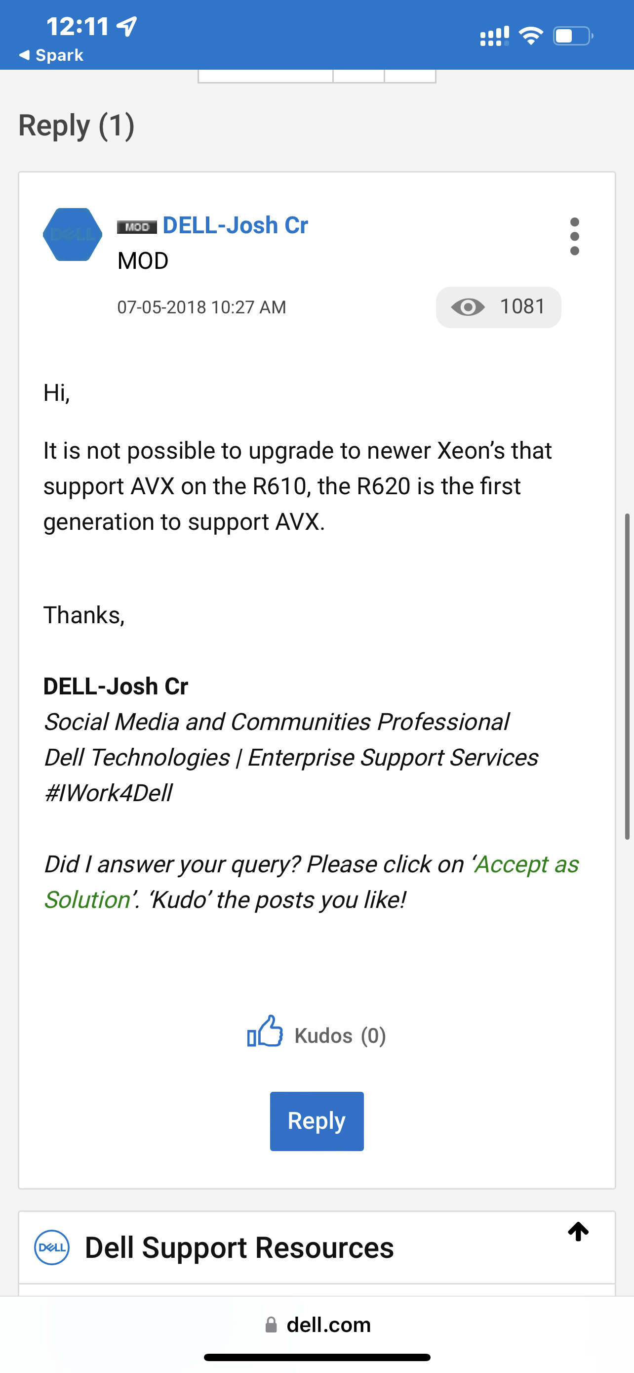

Yeah I finally got it into 5 but something about the T610 I run Unraid on; the hardware isn’t compatible?
I did see that AVX is now required. I was lucky enough to have a CPU that supports it. Perhaps it can be enabled in BIOs?
Google led me to this; this mentions R610 but same hardware other than rack mount. 😞
Looks like I’m out of luck until I upgrade hardware sadly.

Anyone else suddenly having issues with MongoDB since the latest update(s)?
I'm getting the following error:
{"t":{"$date":"2022-08-27T10:57:28.631+12:00"},"s":"F",  "c":"CONTROL",  "id":20573,   "ctx":"initandlisten","msg":"Wrong mongod version","attr":{"error":"UPGRADE PROBLEM: Found an invalid featureCompatibilityVersion document (ERROR: Location4926900: Invalid featureCompatibilityVersion document in admin.system.version: { _id: \"featureCompatibilityVersion\", version: \"4.4\" }. See https://docs.mongodb.com/master/release-notes/5.0-compatibility/#feature-compatibility. :: caused by :: Invalid feature compatibility version value, expected '5.0' or '5.3' or '6.0. See https://docs.mongodb.com/master/release-notes/5.0-compatibility/#feature-compatibility.). If the current featureCompatibilityVersion is below 5.0, see the documentation on upgrading at https://docs.mongodb.com/master/release-notes/5.0/#upgrade-procedures."}}
I take it my featureCompatibilityVersion is set at 4.4, and the minimum it's wanting to accept is 5.0 now?
My MongoDB is sitting on version 6.0.1 so I'm willing to change the featureCompatibilityVersion to 6.0, but it won't let me start the DB to make any changes because of the above error.
A quick fix until setting the featureCompatibilityVersion higher, is to add `:5` to the tag and it will work as expected.  Credit goes to @HalienElf.
Does/can or will this eventually affect us all?
Im locked onto 4.4.15 because of Rocketchat though.
Edited by blaine07
Im not sure about that.  Hopefully someone else may know
For the benefit of anyone else with the same issue, changing version to "5" as demonstrated by @danktankk allowed mongoDB to run, and therefore get terminal access.
from there, to access the database I ran:
mongosh
then, to verify the current featureCompatibilityVersion I ran:
db.adminCommand( { getParameter: 1, featureCompatibilityVersion: 1 } )
then, to set the featureCompatibilityVersion to 5 I ran:
db.adminCommand( { setFeatureCompatibilityVersion: "5.0" } )
Once that was completed, I was able to revert back to "latest" for the MongoDB repository and it's happily humming on 6.0.1 now
