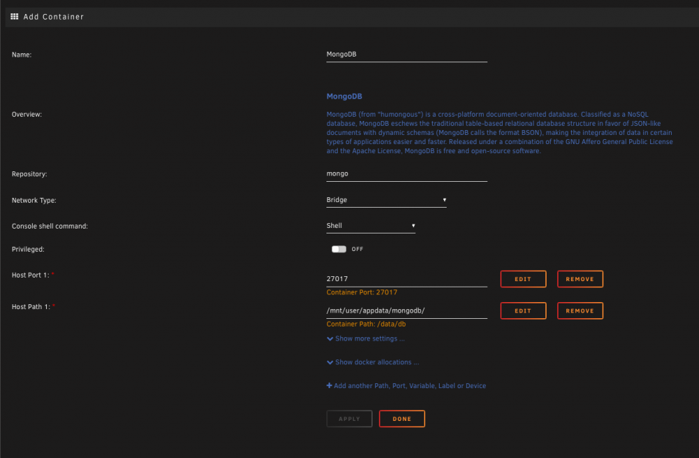

[Support] jasonbean - MongoDB
This template can be found at: https://github.com/jason-bean/template-mongodb
This is a template for the official MongoDB docker container. This template exposes port 27017 so that remote connections are possible.

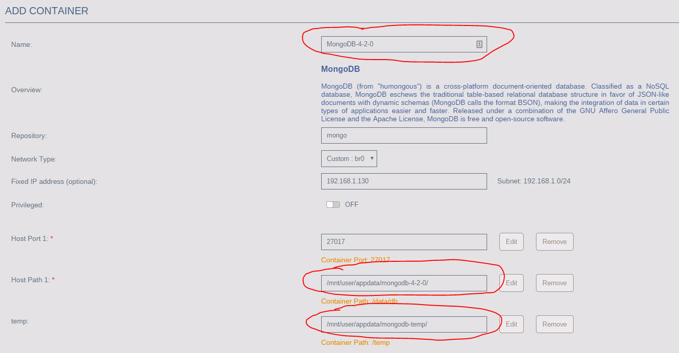

Mount a new volume to your current MongoDB container:
  1. create a new directory in /usr/mnt/cache/appdata called mongodb-temp
  2. open your containers configuration
  3. click the + to add new path, variable, etc
  4. Fill out the form as follows and click add
  5. Save your docker configuration

Upgrade Option 2:
This is the one I chose to use because it left my old mongodb instance completely intact
  1. Shutdown your current Mongodb container
  2. With "Enable Reinstall Default" turned on in Community Apps go to your "Installed" apps page
  3. Click the first icon on the MongoDb listing to reinstall from default
  4. Be sure to  CHANGE the NAME and HOST PATH 1 values to create a new duplicate container.  And don't forget to remap the /temp volume so we can do the restore later.  If using custom br0 feel free to use the same IP address since your other container is now dormant
  5. Click Apply to create the container
  6. Move on to Restoring Mongodb data

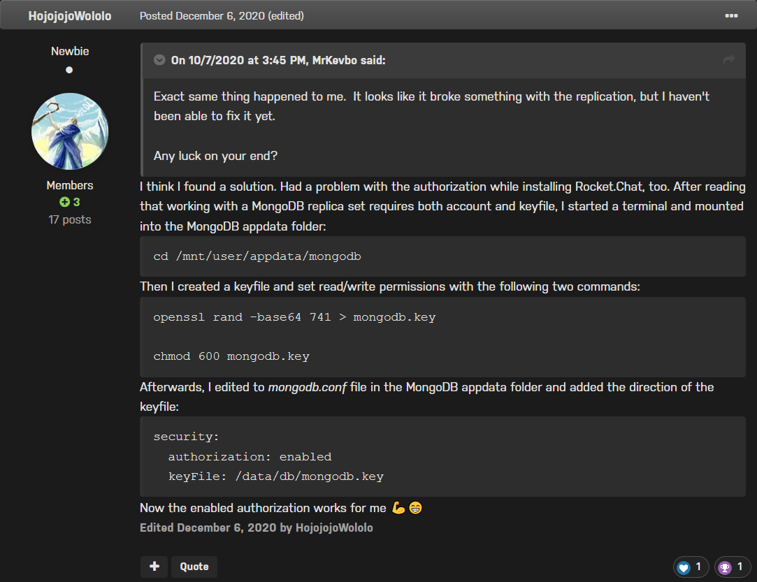

Hi, I just updates to the latest version, all settings to default.
Now the container does not start anymore. The log shows the message:
BadValue: security.keyFile is required when authorization is enabled with replica sets
try 'mongod --help' for more information
How can I fix this. thx
Edited by odiby
Having the same problem after update.
Me too Mongod cant start anymore i try reinstall and same.I get error:
Edited by Vesko

Hmm I tried this but didn't work for me. Just got new errors. This seems to be the important part:
{"t":{"$date":"2021-02-18T12:35:47.675-05:00"},"s":"W", "c":"STORAGE", "id":22347, "ctx":"initandlisten","msg":"Failed to start up WiredTiger under any compatibility version. This may be due to an unsupported upgrade or downgrade."}
This post/thread...Yall gonna have to skim and read around but they solve your issue; despite that it's about RocketChat. I successfully upgraded to 4.4.4. I do have a error every hour about some time crap but the DB itself works and etc. 🙂
https://forums.unraid.net/topic/61337-support-rocketchat/?do=findComment&comment=816403
You all WILL HAVE TO READ around to find exact post with info but in this "area" of thread you'll find conversation about the RS junk.

That finally worked!!
Make sure to  spell "keyFile" with CAPITAL F :)
